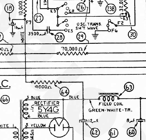

64 - 9,000 ohms - could not find in chassis; I see it looks to be between electrolytics #62 and #18 electrically, and connected to a bunch of other things, but it's not on the diagram of the chassis; excerpt of schematic below

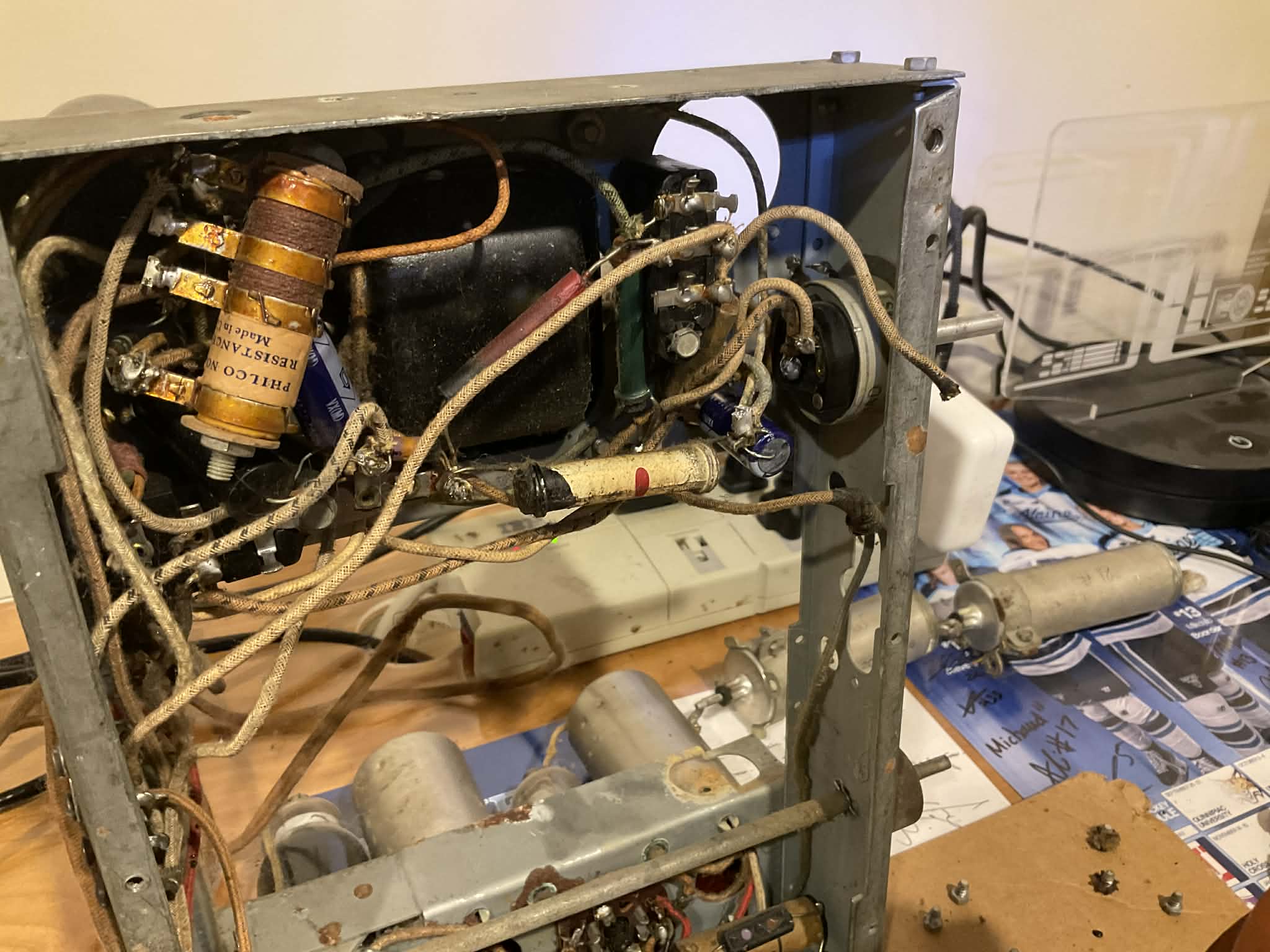

#3 - Expanding on before, I've added a photo below to show the power/tone control.  The two power wires go to the lugs at the back (black) part of the pot; at least two lugs appear further in stemming from the metallic section nearer the chassis front.  The little wire dangling up and over, floating to nowhere comes off of lug 3 on the 8318-SU which as I mentioned before (on the schematic) looks like it's supposed to connect with part of this pot, but not sure if that's right and if so, which lug to connect to.

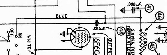

#4 - Just want to verify still if it makes sense that the blue wire (also seen in the photo above) running from the solder terminal strip at position 1 that's supposed to run to the "ON" position of the power switch in the schematics should be spliced and taped to a different wire that bolts down to the bottom right (as pictured) bolt holding the power transformer.  It also is just weird to me that it's spliced to a different wire and wrapped in tape.  I'm not sure if this was a modification after the fact since it doesn't seem like the way it would come from the factory, but it is definitely old tape.  I presume this is one of the hot chassis setups so I guess it could be part of making that circuit.

It's amazing how cramped and exposed all these components were, perhaps even more amazing how well it worked AND that there weren't more electrical fires and electrocutions prior to solid state.

2. I think it is a mistake in the chassis diagram. What they show as the resistor #68, which is the ONLY resistor that is connected to the cap C62, is supposed to be the #64, 9K resistor. There are no other resistors there.
Wereas #68 in the parts list is listed as the Wave Switch Antenna, which it is obviously not.
The big resistor next to the transformer, white with red dot is the 9K resistor.

5. Tone control: trace it, it is a simple circuit. One wire goes to R46-C47 connection point (right bottom in the chassis diagram, they go to that solder strip), another to C56-C57 conenction point (they are right over the power transformer). There should be nothing else othter than chassis connection which is likely done through bolting it to the chassis, but could possibly be a wire.

My caution is to replace only one wire at a time. Take plenty of photos so that a replacement wire can be dressed (aka routed or located) exactly as the original was dressed. Proper wire dress can be important in some circuits.

Thanks for the insight about the probable error on the chassis diagram.  Testing what was marked as #68 yields 18,730 ohms, instead of the 9,000 prescribed.
So that means that these four vary by over 20%:
16 - 51,000 ohms - 89,000 ohms (over by 74.5%)
34 - 400 ohms - 735 ohms (over by 83.8%)
44 - 1,000,000 ohms - 1,500,000 ohms (over by 50.0%)
64 - 9,000 ohms - 18,730 ohms (over by 108.1%)
are the only resistors that you would worry about replacing, correct?

5 - the blue wire from the R46-C47 solder strip connection point is the one that runs to the chassis bolt at the corner of the transformer (spliced/taped along the way); the other short wire from the C56-C57 connection point is the one that's dangling, and is, I'm pretty sure the wire I've highlighted in red on the schematic below.  I'm just not sure what the disconnected end is supposed to connect to in the chassis.  What is that unmarked circle it's running to?  I thought it would be part of the power/tone control pot but there are at least two vacant lugs I can see, and not sure that it was even connected before I opened it up.
