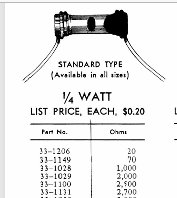

As per the 1936 Philco Parts catalog, that part# refers to a standard 1/4-watt, 1000-ohm resister (dog-bone style).  I have no idea why those 2 lines parallel the part.
Wow Mike, that's a lot of information. In this case though I think Richard is right. Based on the parts listing on p.2 of the schematic from our digital library https://philcoradio.com/library/download...l.%201.pdf the #65 resistor is part # 33-1028. Looking in the 1936 Parts catalog p.8 in the library, https://philcoradio.com/library/download...201936.pdf, a 33-1028 is a standard 1/4 Watt carbon resistor.

Thanks for the welcome, replies and all who took the time to read.  Since the parts catalogue lists it as ¼ W and there is probably only current when turning the radio on or off the wattage seems reasonable, possible error is as good an answer as any; seems we may never know the true answer.  A friend is working on the 625 and he emailed me about the lines by the resistor.  There were some wiring discrepancies in the area and the resistor had been changed at some point which is what drew attention to the area.  Radio is in good hands and he will have it playing like new.
