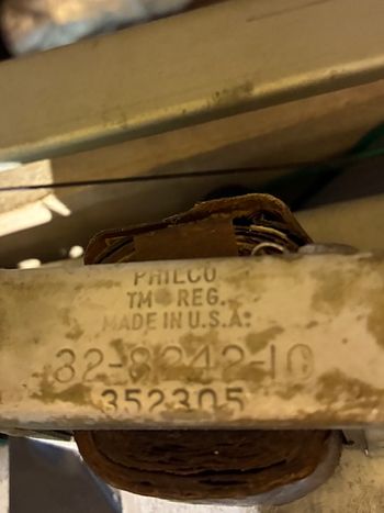

Audio transformer:  32-8242-10
  Specs:  Impedance -  Primary:   4.1K-ohms   Secondary:  3.14 Ohms
             DC resistance:  Primary 435 Ohms    Secondary:     .91 Ohm

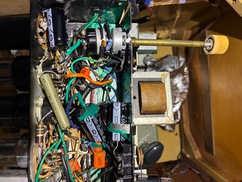

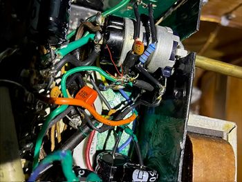

I unbolted and turned upside down the radio, tapped around and noticed that the green wire (see red arrows) connected to the  volume control were loose as the solder connection had failed.  I re-soldered the wire back on.  While I was in there, I also checked all the electrolyic capacitors as well as their ESR values and they're all good. I also rechecked all the tubes in a tube tester - and they all had good readings with no shorts.

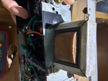

When I plugged the set back in and turned it on from the volume control, the audio output transformer immediately sizzled and smoked.  Yikes !!   I immediately shut it off and removed the plug.

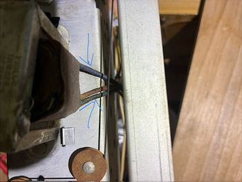

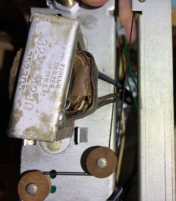

1.  This audio transformer has only 3 wires. There is a black wire at each end, with a reddish wire in the middle.  On one end of the transformer, the black & red wires are right next to each other and the other black wire is further away on the other side (see blue arrows).   To check the transformer impedance and resistance of the primary and secondary -  which two wires am I hooking up to the multimeter to check primary and secondary resistance?  Is it the the black & red next to each other for the primary and then the red and other black for the secondary?

3.  One side of the transformer is puffed out and one side looks normal.

To measure resistance (promary, the xfmr usually needs not to be removed from the circuit, but the resistance is not very important; inductance is and for this you do have to remove it.)
You need to measure inductance to see if there is a turn short, which is probably what it is.
I suggest that the transformer by now is bad.
Also, sometimes it does not go bad on its own, and a tube (or tubes if it is a pushpull) make it bad.

Now, the three wires are there because one of the output leads is grounded and the 4th wire (to the speaker) goes via the chassis/GND.
Otherwise, again, I think your xfmr is gone.
Disconnect; if you can, measure inductance; if not, see if that bulging side smells and darkened. The resistance measurements may or may not be useful.

Thanks everyone for your help. I resoldered 2 cracked/loose connections to the back of the volume control. I was able to test both the DC resistance and the impedance of my audio output transformer - and it seemed like it was normal. The transformer, although puffed out on one side, didn't' smell burnt. All other caps and resistors tested normal. As far as the 35L6GT tube, it tested good in the tube tester, BUT I had an extra NOS tube and used that one instead. I powered the radio up (expecting to see fireworks !!) and PRESTO - plays like new again. There were probably a combination of factors going on here - but all is good. Thanks folks for your expertise.
