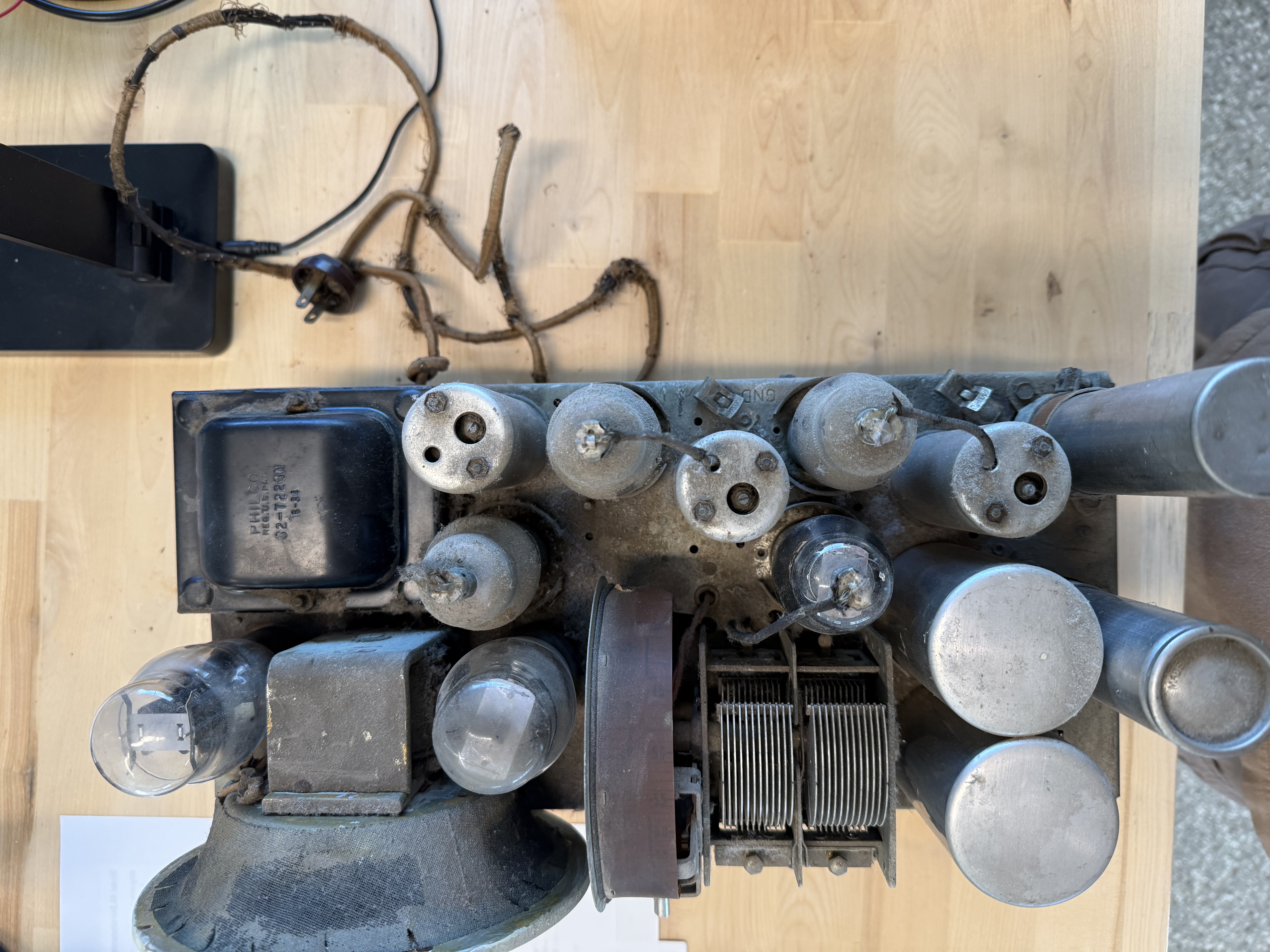

I have been working on the Butterfly model 45, just got the chassis running. I decided to mount the electrolytics underneath versus refreshing since the cans were in great shape and I wanted the top side to look original. I still need to do a full cleaning on the chassis, and I just started stripping the cabinet. Anyone want to share their best-practices for cleaning grime and polishing the chassis?

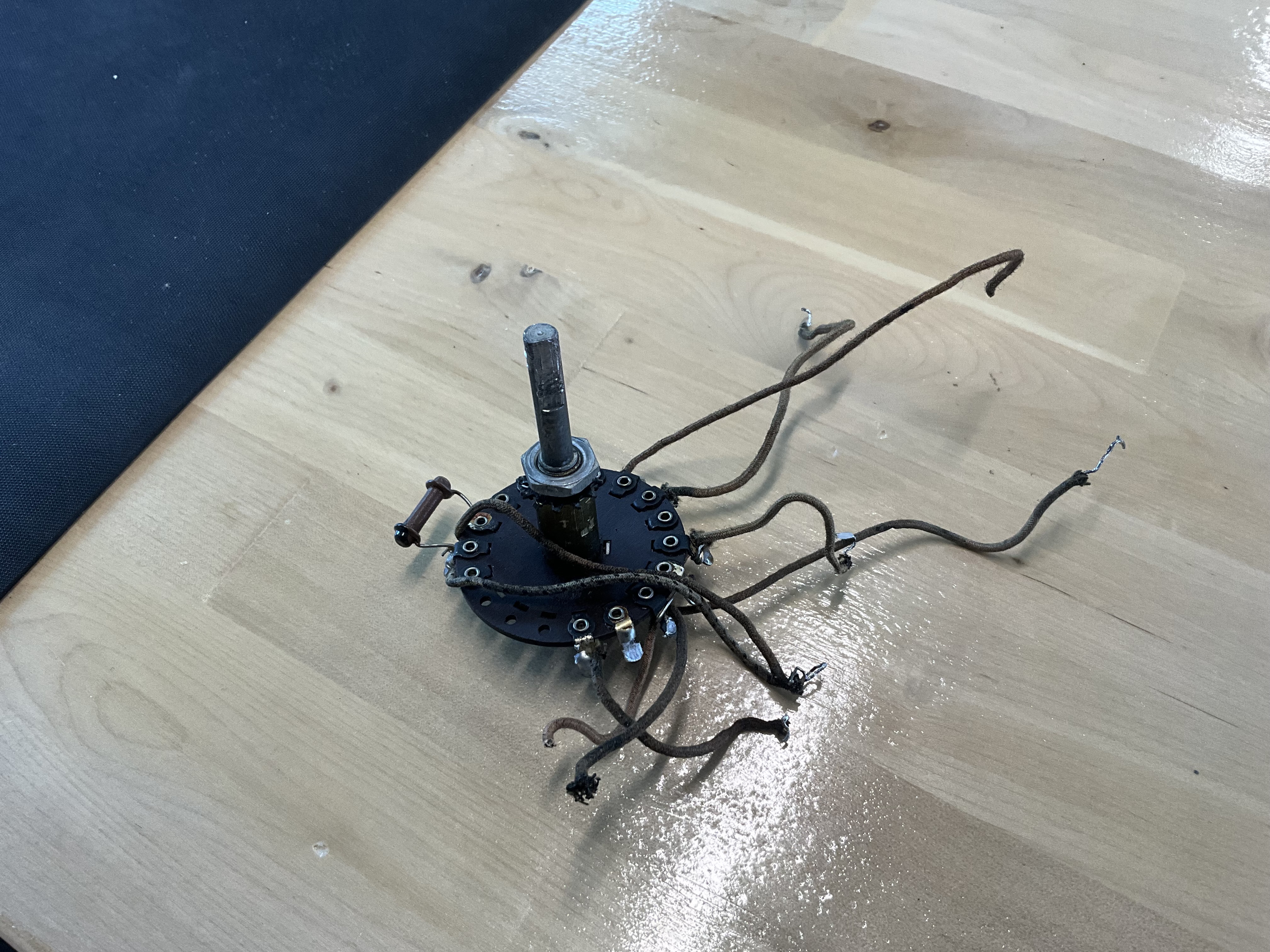

Jayce, somehow I ended up with 2 butterfly units which ended up being great to have one chassis to look at while working on the other. I had hoped to get both running, but ended up having to steal the band switch from the backup unit. The original band switch had frozen up and I tried every trick to get it freed up, couldn’t get it to budge. BTW, on the tone control, the mid-tone I had to modify the cap value from what I could find on the forum and info if you ever work on your tone control. Recommendation is us a 0.02u for mid, but I found a 0.004u worked best to get good mid-tone balance.

Hey Arran,
Thanks for the tip on the band switch. I tried heat, but I’ll soak it. When I first started on this unit and pulled the Bakelite knob off the shaft, I noticed someone had taken pliers to the shaft which you can see in this pic. The switch is stuck in shortwave mode, so someone was desperately trying to get it to AM haha. I’ll soak it and see if that frees it up along with some more heat.

Posts: 5,652
George;
I don't know if this has one or not but quite often controls, and switches have a "C" shaped clip holding the shaft in place, if you can carefully pry it open with a small screwdriver, and extract it, that will allow you to get more solvent into what looks like a rather tall bushing. In fact one you get it loose you should be able to tap or pull the shaft right out of the bushing to give it a good cleaning, though you will want to file, or polish off any burs caused by the pliers.
What Arran said.
I did several.
Sometimes the circlips are flat E-type, and sometimes they are square x-section type. What you have seems to be the latter.
First I take something hard and long with a flat surface (a big screwdriver, a metal bar), and press against the gap in the clip. I do it while holding the pot or the switch with both my hands (pushing it with the thumbs) while pressing that bar agains the gap, pulling the bar with the rest of the fingers. The goal is to widen the gap and to see a little of the space between the clip and the groove it is in.
If you could stick an awl (large sharp metal pick) in that gap and start pulling - great. Look for the clip to not fly across the room. This is why it is called "Jesus clip."
Also look for the pick not to slip and end up in your hand/eye/beerbelly (if you got one).
Some folks use two bent picks to pull the ends apart. On a couple of occasions I successfully used a pair of neednose pliers to accomplish it.
Nest step: if it is really frozen, well, soak is not necessary, but introducing some penetrating oil (PB Blaster) and wait a bit.
Use heat on the bushing (not on the contact phenolic piece).
Apply force ( torque) against the bushing, NOT the board. Which could be accomplished by bolting the switch back in place and toruqing CCW.
Usually works fine.

Thanks Arran and Mike,
I'll probably have my wife hold it while I use the awl, just so I am not the one injured in this process. I saw the clip and I thought to myself, 1) no way I get that off without an injury, and 2) no way I find it once it shoots across the room. So I stuck with my heat gun then finally gave up and decided to scavenge the switch from my second model 45 where I had already stolen the filter choke from. But I would like to get the other unit running, so let's see if I can get this clip off. Appreciate the feedback.
