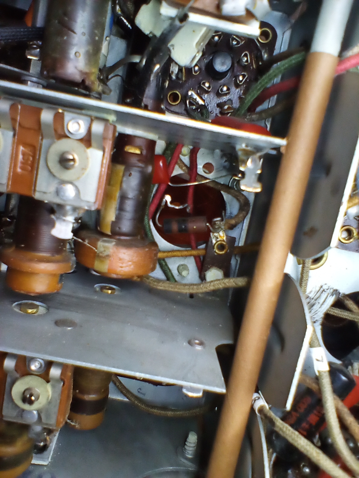

When tested this resistor shows 10 ohms. I do not see it as such on the parts list.  As you can see from the attached photo, it is    brown,black,brown and black. This resistor connects to the positive terminal of the 16 mfd electrolytic cap part number 16 which I have just finished restuffing. Can someone tell me what the value of this resistor should really be?  Many thanks

A couple notes - are you sure that's a Cap 16 and not a Cap 18?  Part 16 is a 51K ohm resistor on the other side of the chassis - this is in the tuning sub-chassis.
Second, I just looked at my 37-620 (also a work in progress) and I don't have a resistor anywhere there that you have pictured, nor do I have that standoff.  The closest resistors are 19 (10K ohm), also in the tuning sub-chassis but on the other side of the same section, and then 64 which is a very prominent dogbone resistor in the main chassis next to the other electrolytics, erroneously marked on the chassis diagram as part 68.

I don't see any low value resistor on that filter cap on the schematic and I've looked at the code 125 schematic too. It might be an add-on of some kind or some rf coil.
Well, this place was worked on. Quite possible the part is not original.
I compared your photo with my chassis. In yours, the ten ohm "resistor" attaches to the filter cap and the other end to a terminal, then there's a wire from that terminal to the, what I assume, 70k/20k resistor junction across to the other side of the chassis. In my chassis that wire goes directly to the 16mfd cap, no terminal, no mysterious resistor.

First of all, sorry, yes it is part 18 not 16. I do not know the chassis number but it is from the chairside version. There are the numbers 38-1655 stamped on the left inside of the chassis. The schematic I have is what was downloadable from online and does not say what version it is. The chassis had a sheet metal cover on the bottom.
The schematic I have is off the Radio Museum website and my chassis should be 37-620CS model 125.
When I look at that schematic on that website it looks like that resistor from the 16 mfd cap is a 10K.

It is 10K.
First, I want to thank all those who have tried to help a beginner like me asking such elementary questions related to the 37-620 I was working on.  Special thanks to morzh for identifying that 10 Ohm resistor.  After doing more research, I discovered it was a 37-620CS code 124 not 125..  I found a service bulletin 250 for that model which lists the differences between it and code 121 receivers and that stated putting in the 10 ohm resistor in series with the positive of the electrolytic 18 .  That bulletin also gave updated part numbers for the electrolytics which my unit has.
