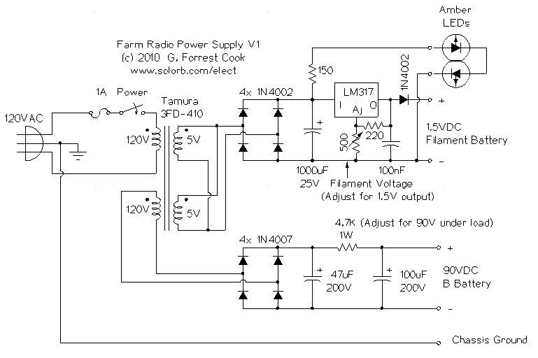

Here's the one I build. I get the transformer from Mouser 553-FS10-600-C2.

For 1940s battery sets the one Rob showed is probably the best bet, if one can assemble the parts himself, even the transformers are not that expensive, and everything is available from Mouser, where you can pick and choose the quality of the parts you wish to use for under $50. Other then the ARBE III I know nothing about the other two, especially by reputation, and the vendors are not volunteering much. The middle offering looks like it's using mystery brand caps from "The Middle Kingdom", I can't tell what it has for transformers, whether they are operating from the mains or if it's switcher junk. The BEAR one looks very cheap and cheerful, like a glorified power supply from a laptop, that may be unfair but I would like to know what circuitry is used in even a $145 supply.

that looks like a good design easy to build !

One contributor added 3 diodes in series across the filament output, anodes to positive, cathodes to negative. This is a great idea as it acts as a "clamp" to protect the rather valuable 1.4V tubes from burnout in case of regulator shorting or other failure that causes an overvoltage. While the octal 1.4V tubes are not as rare as UV199s or the dreaded WD11, the original Sylvania design "G" taller skinnier tubes (small shell octal, T9 envelope, about 3 7/8" length) are more scarce than the newer style with the medium or wafer octal base, which will not clear the shield mounting in some sets.
A 4 tube 1.4V / 90V farm or portable radio draws 250 mA. A standard alkaline D cell has a capacity of about 12,000mA Hours to discharge. Therefore one D cell can run the filaments of the radio for about 40 - 50 hours. This simplifies design so that you need only a "B" supply.
Building the B Supply should be very easy. The circuit from Philip Nelson's "Phil's Old Radios" in the following link from David:
https://antiqueradio.org/bsupply.htm
would cost less than $15.00 for the handful of parts and perfboard to build. Any transformer that you can scrounge that has 2 separate primary windings for 120/240V can be used as an isolation transformer for safety. Even if you have 2 decent size transformers that are 120 V primary and secondary voltages that match, you can connect the secondaries of the 2 transformers together and Voila! you have an isolation transformer
