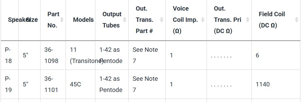

Hi Zoot,
The voice coil for the 5" speaker used in the Model 45 should have a voice coil impedance of 1 Ohm and a field coil resistance of 1140 Ohm. The info can be found in the Philco Library under Parts -> Speakers. Below is a snip of the chart showing the speaker info for the 45C: Hope this helps. "Do Justly, love Mercy and walk humbly with your God"- Micah 6:8 "Let us begin to do good"- St. Francis Best Regards, MrFixr55
04-26-2026, 03:06 AM
Yes it does tend to confirm my readings. I am just not used to speaker impedance being 1 ohm. I have a fairly good multimeter but reading 1 ohm tends to make you think when most speakers have much higher impedances.
I thank you for the input. Now I have to search for other problems.
