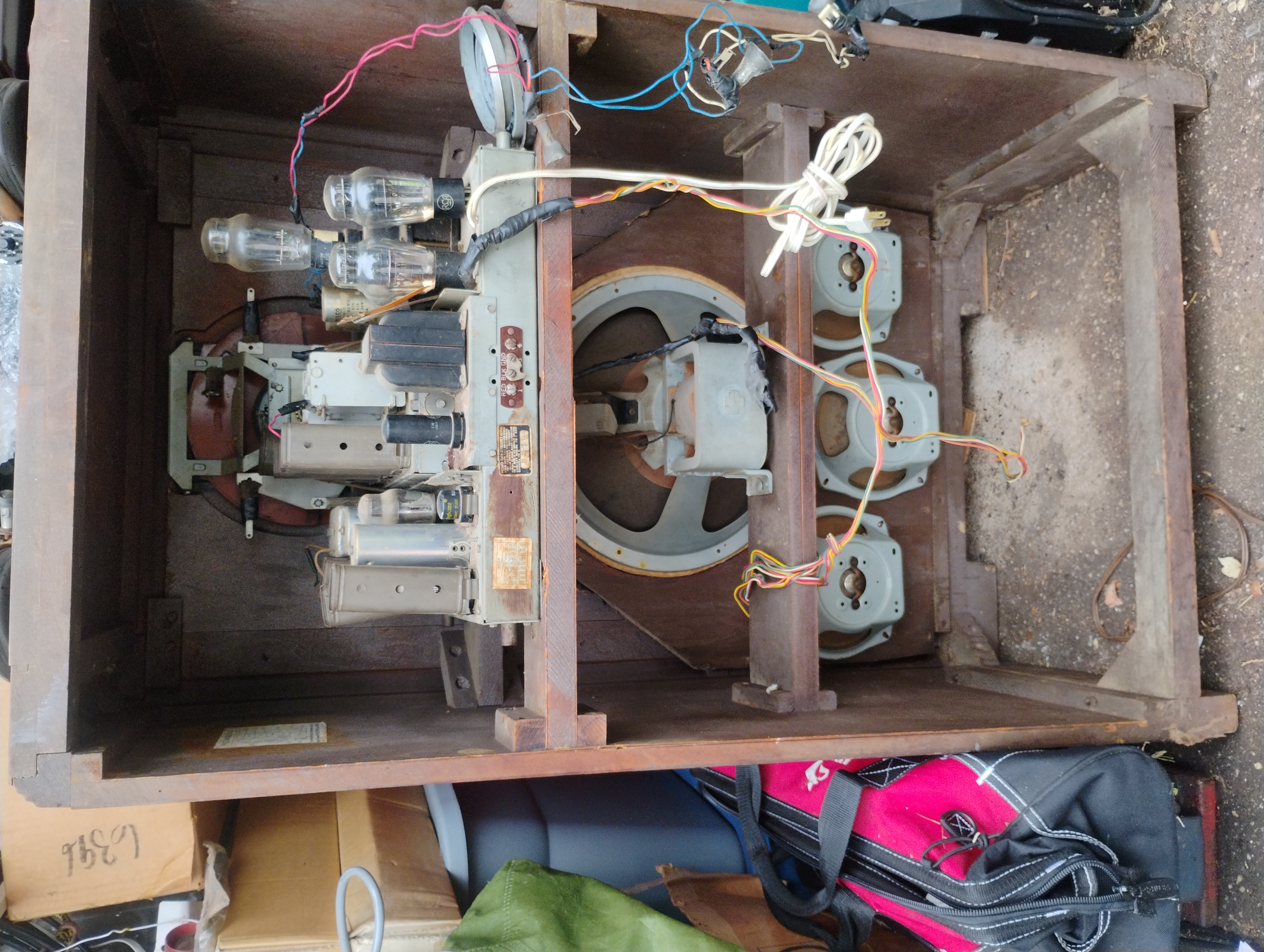

Here's the back. The chassis in this cabinet is complete, including all tubes, bottom cover but minus mounting hardware. (The set uses the rather rare 6A4 triode output tubes for 15W output).
Mike gave me a second chassis which was configured for the even more rare 6A5 triode outputs with separate cathode and heater. Per The 1937 Changes bulletin in our library, this change was made in Code 126. I thought that per the SN, this is the older chassis, but apparently no. I guess that I have to find 4 30 Ohm resistors or wire for 6L6s. I think that by tying Pins 3 and 4, and grounding pin 8, I could choose between 6A4, 6A5 and 6L6 as triodes. Bias may be an issue. This chassis lacks the hum balance controls used for the 6A4 tubes used in the other chassis. I hope to fully restore at least one chassis and repair the other as a spare. Unfortunately, fore some reason, my little cheapie Motorola phone takes 10MB pix for the chassis and the limit is 5MB. I don't have any presence on photobucket, dropbox, etc.
I cleaned the spare chassis with 91% Isopropanol, hosed it off with water (sealed off transformer openings first), dried with compressed air and left to bake in the 96Degree sunlight here on Long Island. I don't have to be that drastic with the "good chassis. Pic here:

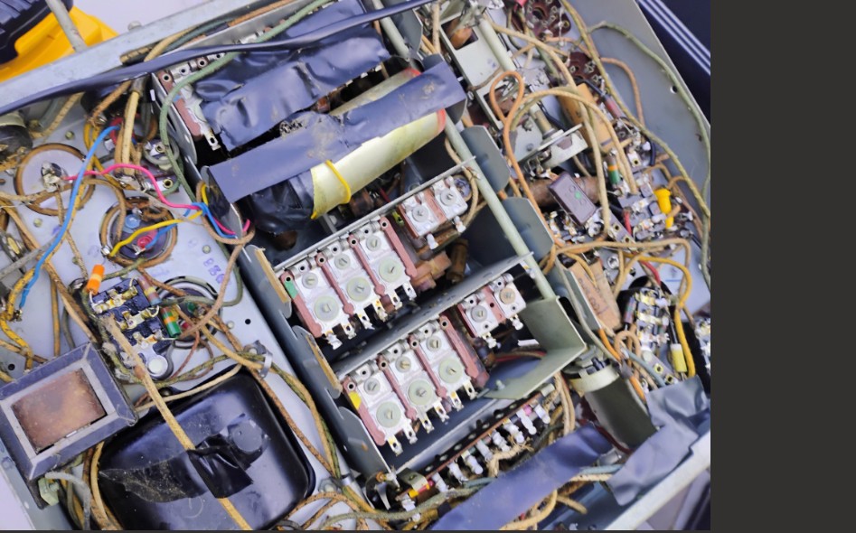

Started to get deeper into the radio. Fortunately, the audio input and output transformers ohm OK. I have made a new harness using 20 gauge Teflon covered wire, rated 600V in a nylon sheath. Not exactly accurate but looks period. (Like my Grumman Aerospace Engineer Dad used to say, "It will look just fine at 10,000 feet."
Both chassis suffered from mice living on top of them, with different sections of each chassis having different areas rusty from mouse urine (hence the heavy use of alcohol during cleaning. I will try naval jelly first. Worst case scenario would be to swap sections. On the chassis that I am restoring, the RF and Audio driver sections are worst. The IF and Power / Audio Output are better. I may end up swapping the RF section and leaving the driver section, as the driver has the original, correct and functional driver transformer. The RF section of the other chassis is very clean (from the water, alcohol and blow-gun treatment.
The biggest problem is not mice getting to the underside, it was previous repairs. The repairs may have been relatively recent, as plastic electrical tape was used and a relatively recent Pyramid can electrolytic was installed using 60 and 50uF caps across the two 8uF caps (which are already parallelled by Philco), putting about 110uF at the cathode of the 5U4. Another reason for not powering up the radio prior to inspection and recapping! I have had to do some sleeving and wire replacement; the original cloth wire is very brittle.
So far, I have replaced most of the electrolytics. I replaced the two 8uF caps in parallel with a 20uF 500V Nichicon. Unfortunately, the other 8uF caps come from the Middle Kingdom. For the last can, there are 8uF, 2uF and 3uF sections. I intend to replace the 2uF and 3uF caps with Poly/Film 630V caps. Then onto the blocks, and finally the individual paper-foil caps. These seem extremely dried out on this set.
I am trying to figure out how I can convert the pix from my $150 Motorola phone that seems to take very nice 10 MB pix and cut them down to the 5MB limit.
Today, I hope to start on some of the blocks. With the electrolytics done, I am tempted to hook it up and fire it up to see what I have so far. Film at 11.

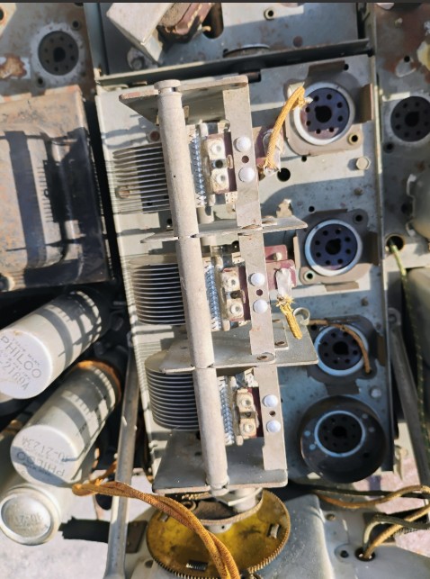

Fortunately, not a lot of mouse damage, but there definitely was human damage to my 37-116. Note the addition of the electrolytic and the bridging of the other cap. This has now been cut out. I may eventually get around to stuff the caps but for now, the replacements are on the underside but have been separated from the originals.
A new C- Bus has now been established with 18 gauge solid wire for connection to the caps and other required connections. It is interesting that even on the 37-116, Pins 1 and 8 of the output tubes are at B- (chassis ground), as if they intended the possibility of using 6L6s, either glass or metal. However, apparently both the interstage and output transformers are different between 6L6 and the 6B4 / 6A5 tubes. For the 6L6s on the 38-116, the secondaries are separate because they add negative feedback from the interstage secondaries to the 6L6 grids.
I started cleaning the IF cans and trimmers which were very dirty, and cleaning the IF and Power / Output chassis sections. I will likely swap the RF / Osc / Mixer section while recapping it.
