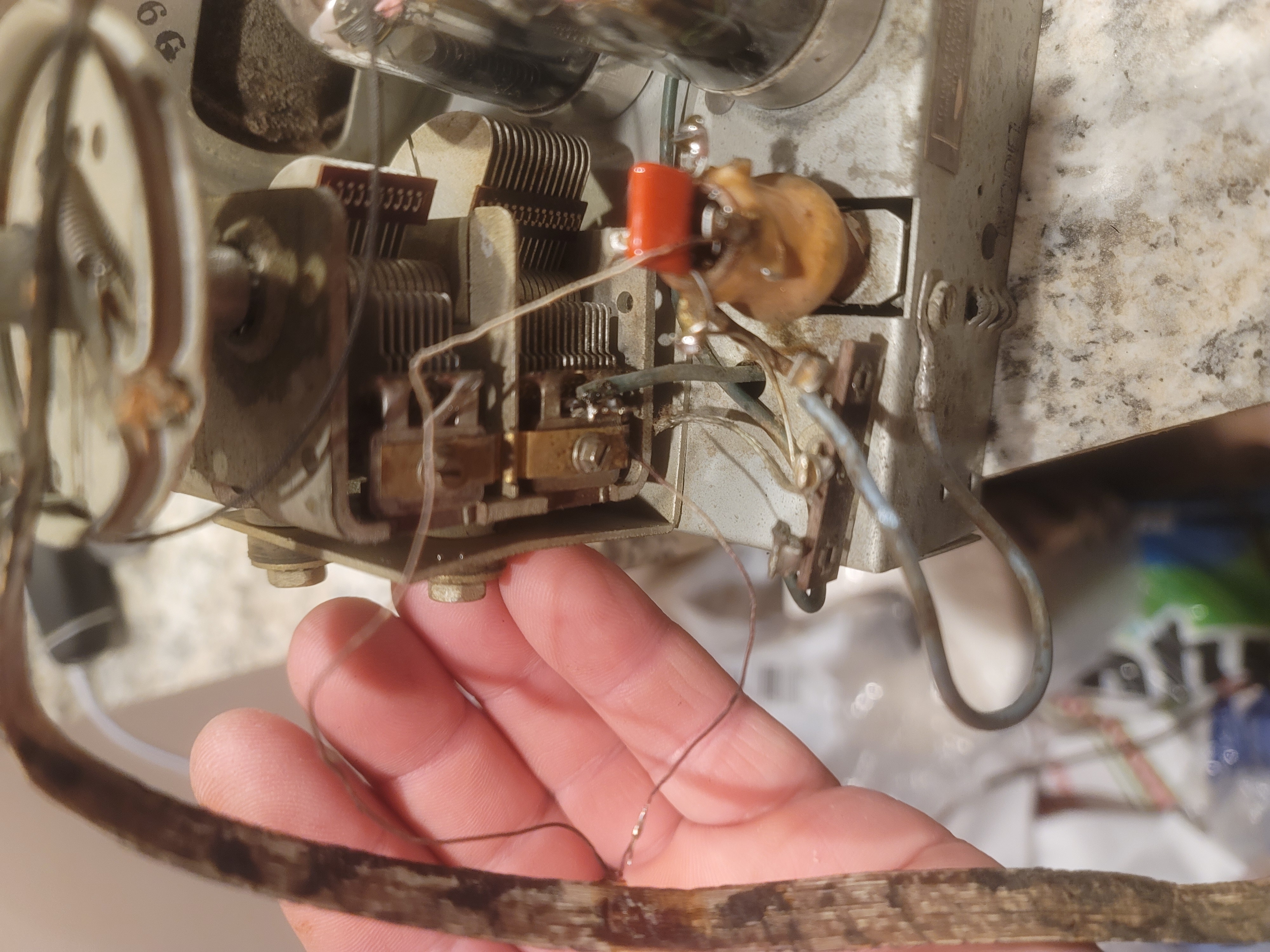

  • Verify correct connection of the antenna.  I believe that the innermost end of the loop connects to the RF section of the tuning cap.  The other end connects to AVC.

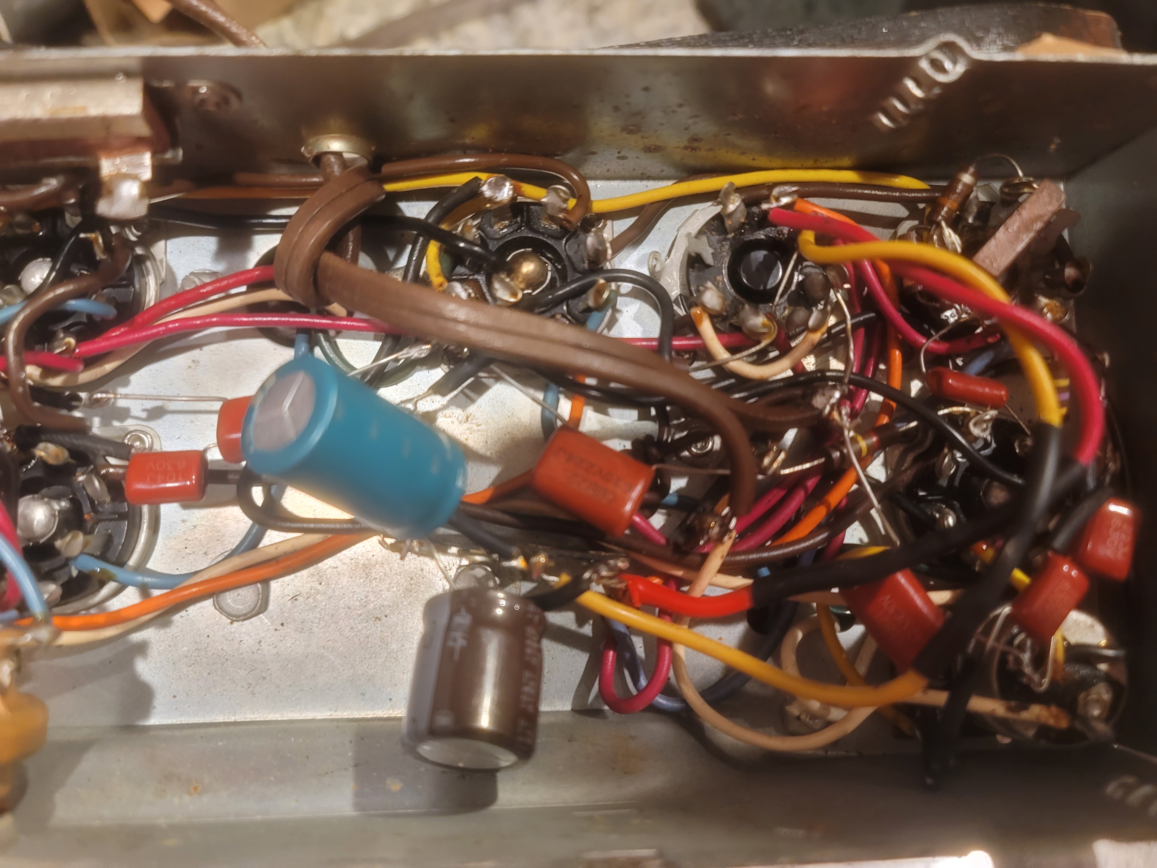

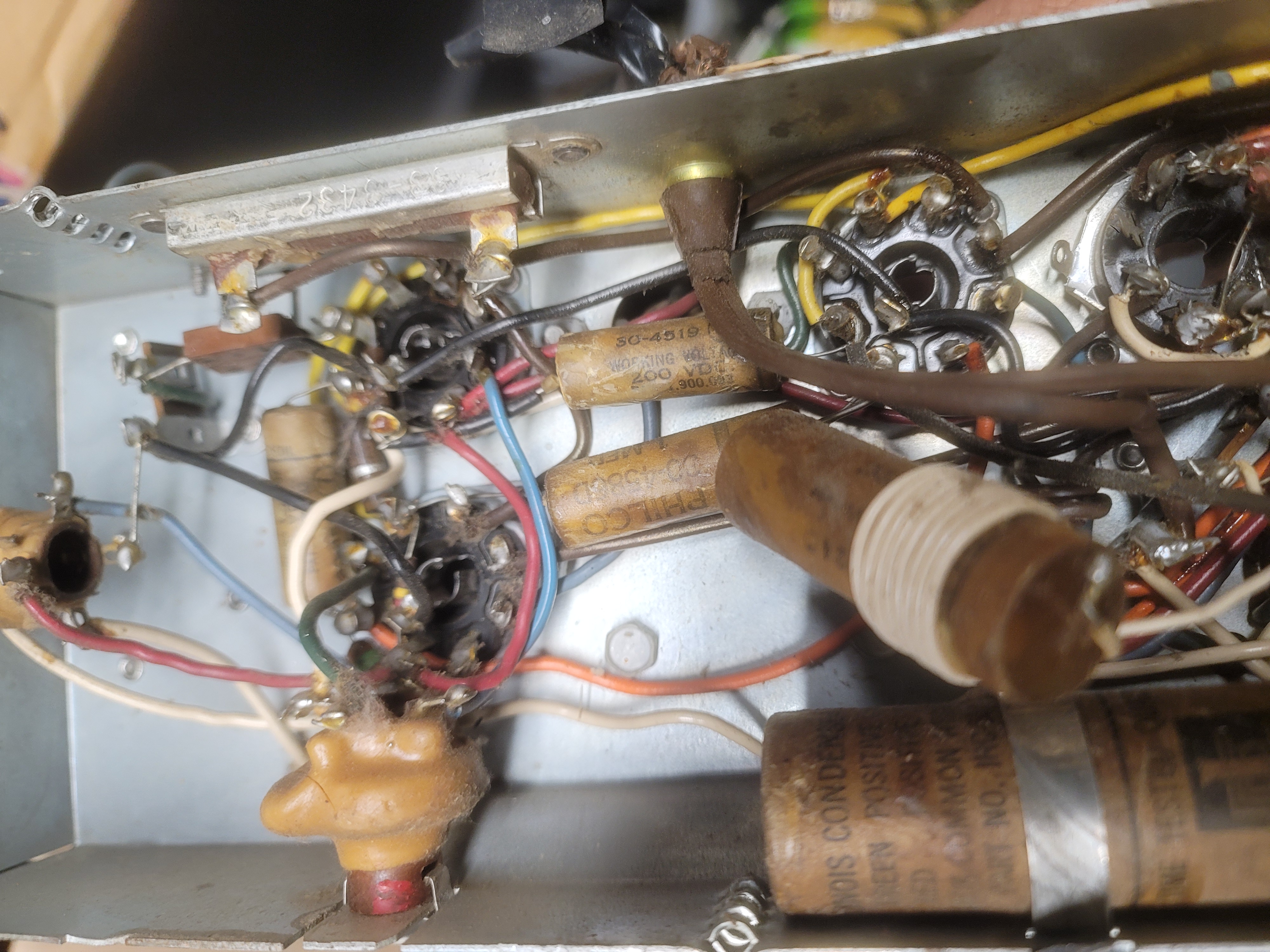

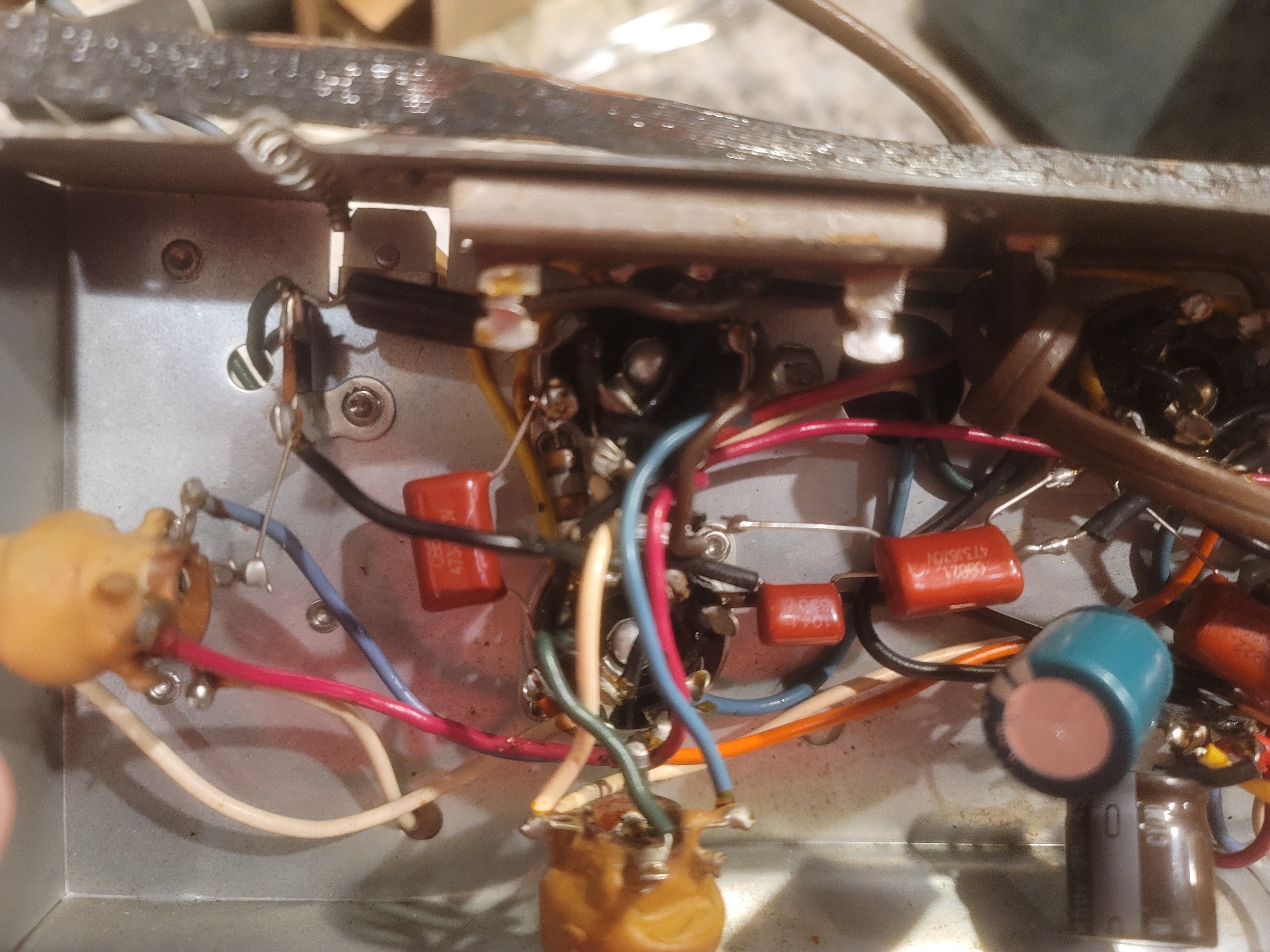

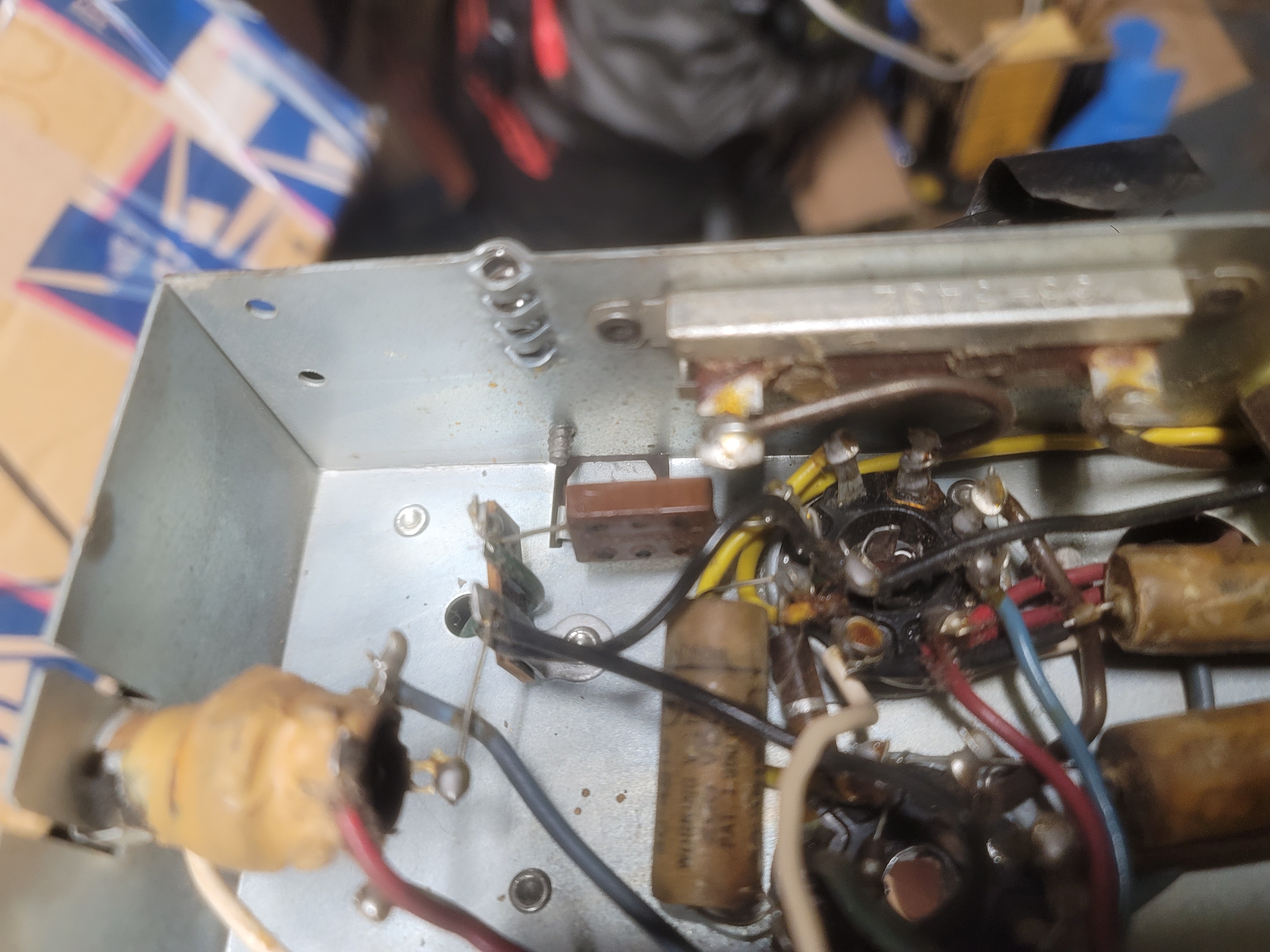

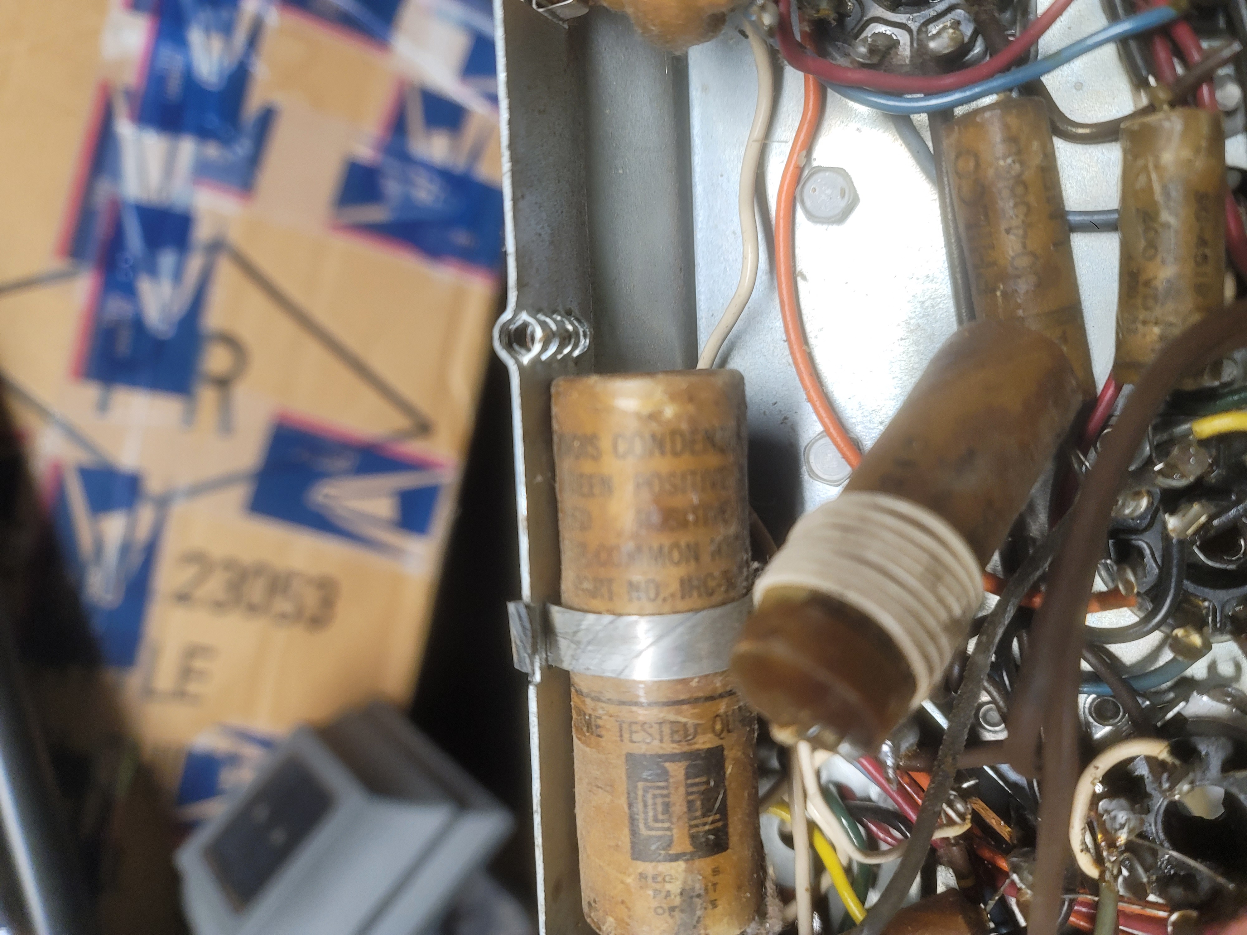

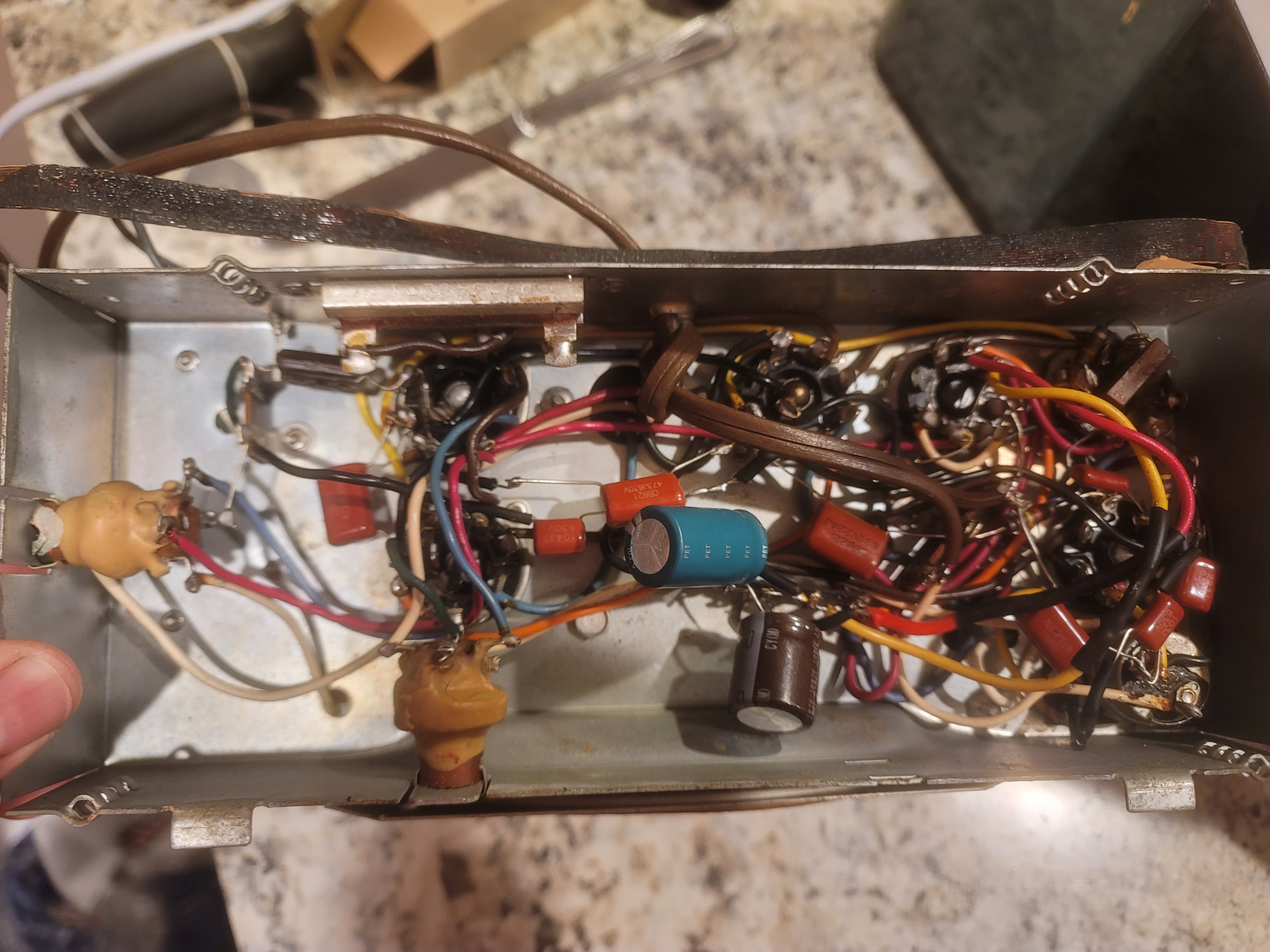

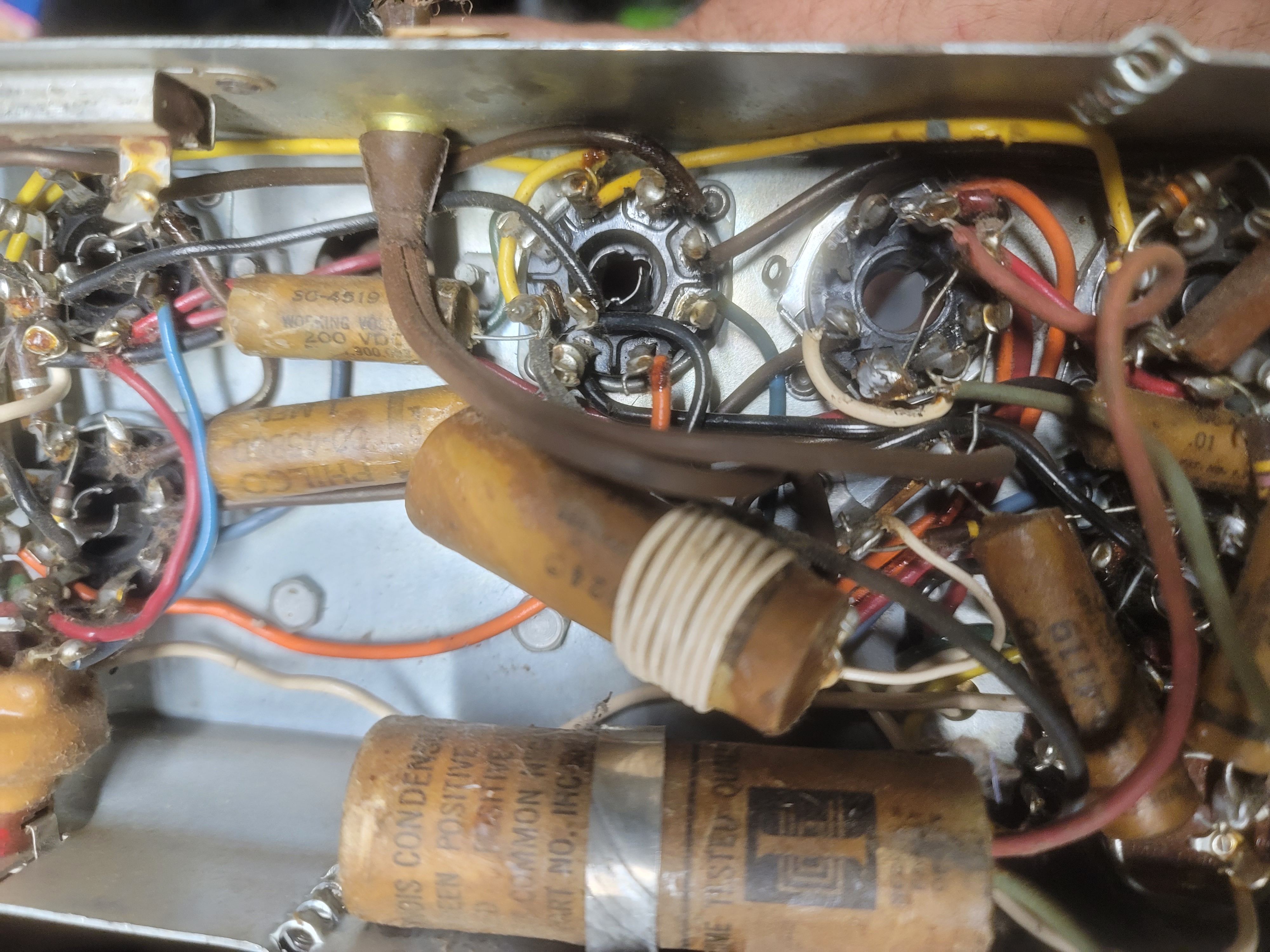

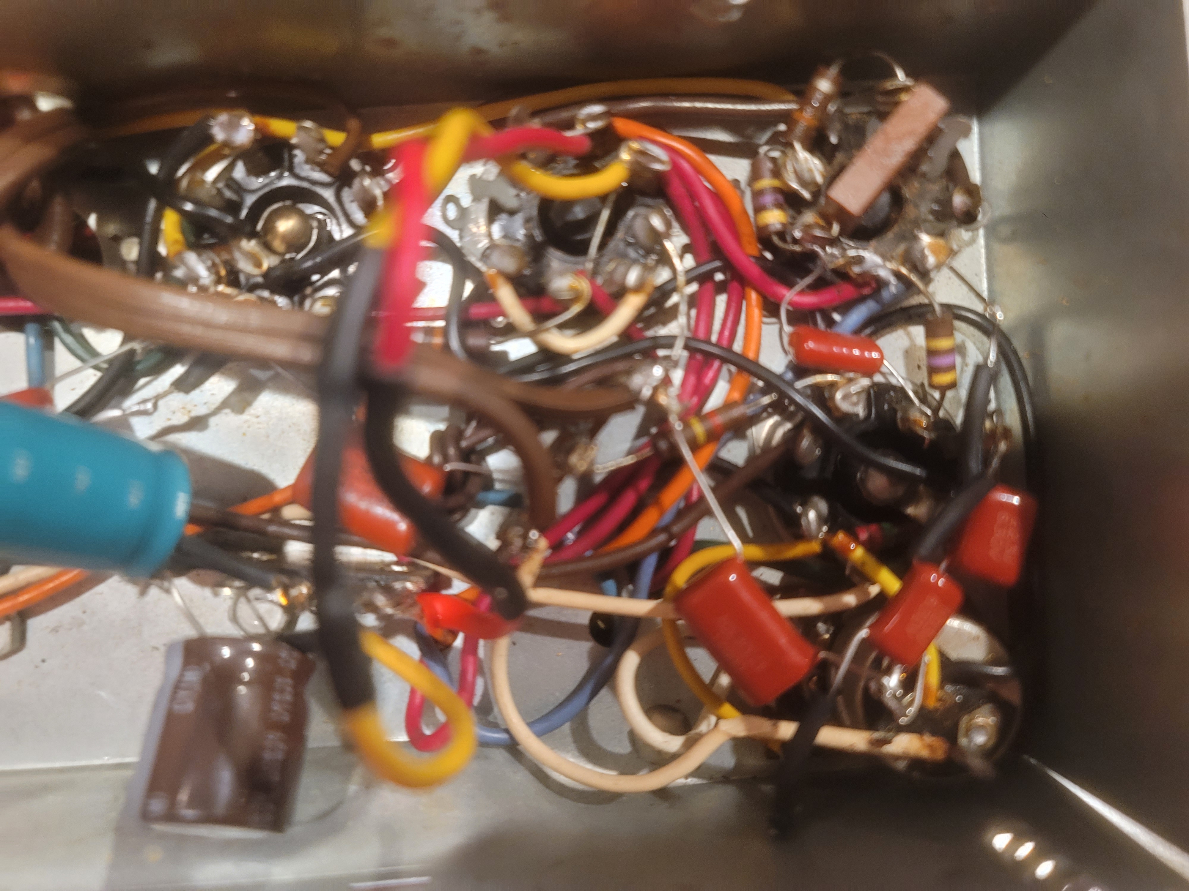

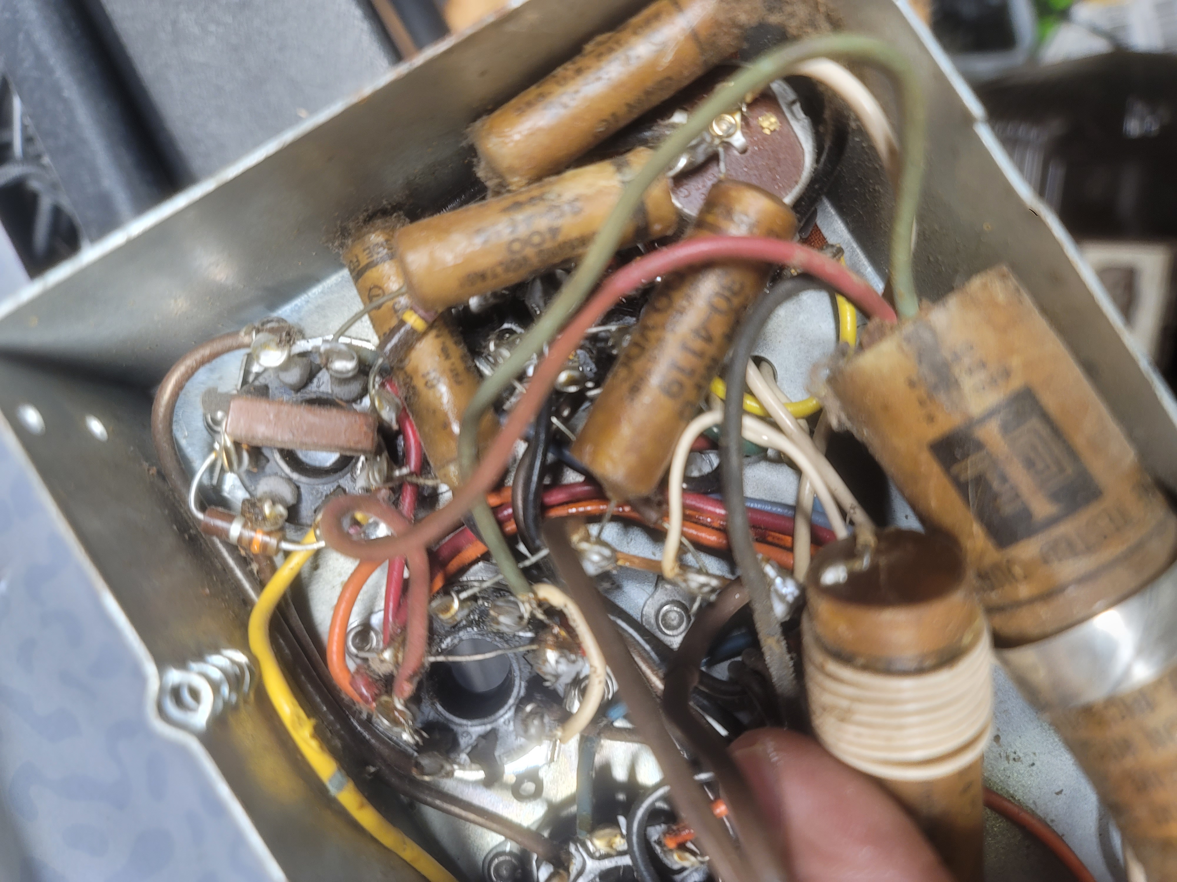

Just an update I was thinking about caps by memory and confused 402 with the cap in this , which was the one that had the wire wrapped around it. I actually never changed 402 because I did not have a mica cap. Here's a picture of the unrestored Parts hippo chassis you could see both capacitors I'm talking about. The one with the wire wrapped around it doesn't seem to be on my schematic. It's a .2 microfarad that goes from pin 4 on the 7B7 goes to the ground on the terminal strip then is connected to pin number 1 on the 7c6 through a 120k resistor. Both chassis did have that.

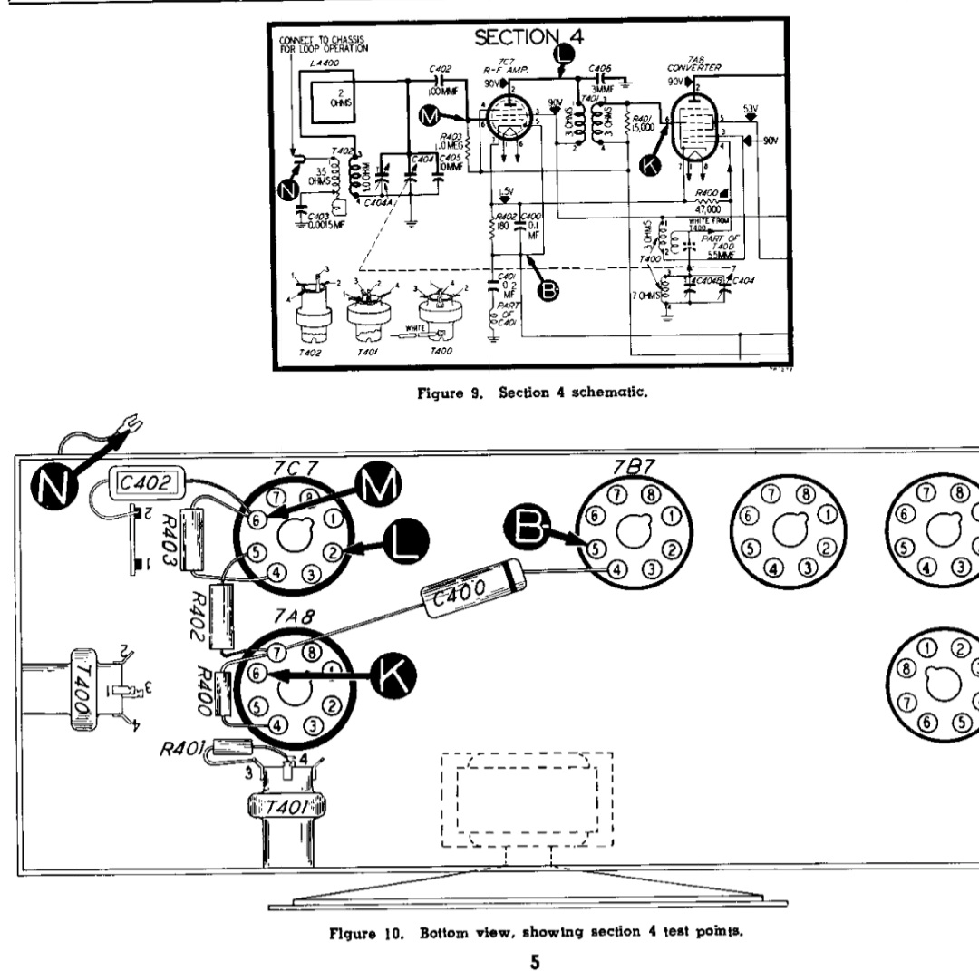

Yes, that's C402  [Edited 07/11/26] 401 on the schematic section that you posted.  That's the cap that "grounds" the chassis to the B- "Mecca" that I described.  I wouldn't call the wire wound around it a "gimmick; a gimmick is usually connected only at one end and was very common in the RF transformers of the early 1930s 4 tube TRF radios.  Here, I think it acts as a choke. It and the cap are in series.  I have only seen these in Philcos.
If using the chassis from the parts set as a comparison, change ONLY the electrolytics, jumper the power switch and install a polarized power cord to ensure that the chassis remains at neutral - ground potential  More on that later.  The reason why I am recommending to not recap the paper caps at this point is because paper / foil caps are wound like a Swiss roll.  This causes one plate of the cap to be "inside" the other.  The "outer foil" goes to ground (B-) on "bypass caps" or to the plate of the previous stage in coupling caps.  For example, in the audio stage, the cap that couples the triode plate of the 7C6 to the grid of the 50L6, has the outside foil connect to the plate of the 7C6 and the inner foil to the grid of the 50L6.
The reason that I want you to jumper the power switch is this.  Consider for a moment if C402 401did not exist or was shorted and the chassis was directly connected to one side of the AC Line.  In just about every AC-DC radio, the power switch switches the B- / chassis ground to the power line.  This causes a d**ned if you do / d**ned if you don't situation.  If the plug is in the AC outlet in such a way that the chassis is at neutral v/ ground potential with the power switch closed, all is well.  However, when you turn the set off, the chassis is now hot, through the tube heater string.  The heater string is less than 100 ohm when cold.  Reverse the plug and the opposite happens.  The chassis is safe with the switch open and hot when the switch is closed.  Since you are working with an exposed chassis, this is dangerous.  In fact, I modify all transformerless sets in my collection so that the B- /ow end Heater String "Mecca" is hard wired to the neutral conductor (large pin) and that the switch is between the rectifier plate and heater connection and the Hot leg of the power cord (small pin).
Tuning caps were quite standard in radios of this period.  the AA5 or AA6 radio had an RF stage cap whose value was almost always at 365pF with plates closed, 10pF with plates open, making the antenna loop value pretty similar from model to model.  The only difference is that in the Philco AA5s and AA6s, there is an RF coil in series with the antenna loop that allows the user to connect an external antenna to the set (the green wire).  However, if no external antenna is used, the green wire is grounded to the chassis, thereby at the RF level, shorting out the coil at RF frequencies.  Therefore, you could possibly replace the loop with a loopstick if you find one from a radio using a 10-365pF.  So I don't think that there is any real difference between the loops from your restored radio and your parts set.

The terminal that the wire coil end of C402 401goes to is likely the terminal on the trip that is riveted to the chassis. Do make sure that that rivet is not loose or corroded.  The resistor you describe also goes from the
B- / heater string "Mecca" to chassis ground.  This is needed, because the cap stator and frame and the IF cans have to be at ground potential, as well as the metal bases of the Loctal tubes, as any shields used on the tubes have to be grounded, and they are grounded through the base.
Try what I suggested before about changing the electrolytics, put the antenna back on the parts chassis, jumper the switch, make sure that the chassis is at neutral potential and fire it up.  THen compare to the other set.  If they both perform the same, thenthe problem is definitely through power.
BTW, there is usually a cap, C100, a 0.04uF cap across the power line downstream of the power switch.  If this cap is open or gone, this can increase noise.  The cap that you need to use is a Y2 Safety cap.  The cap is fused so if the cap shorts, the fuse opens to prevent fire.

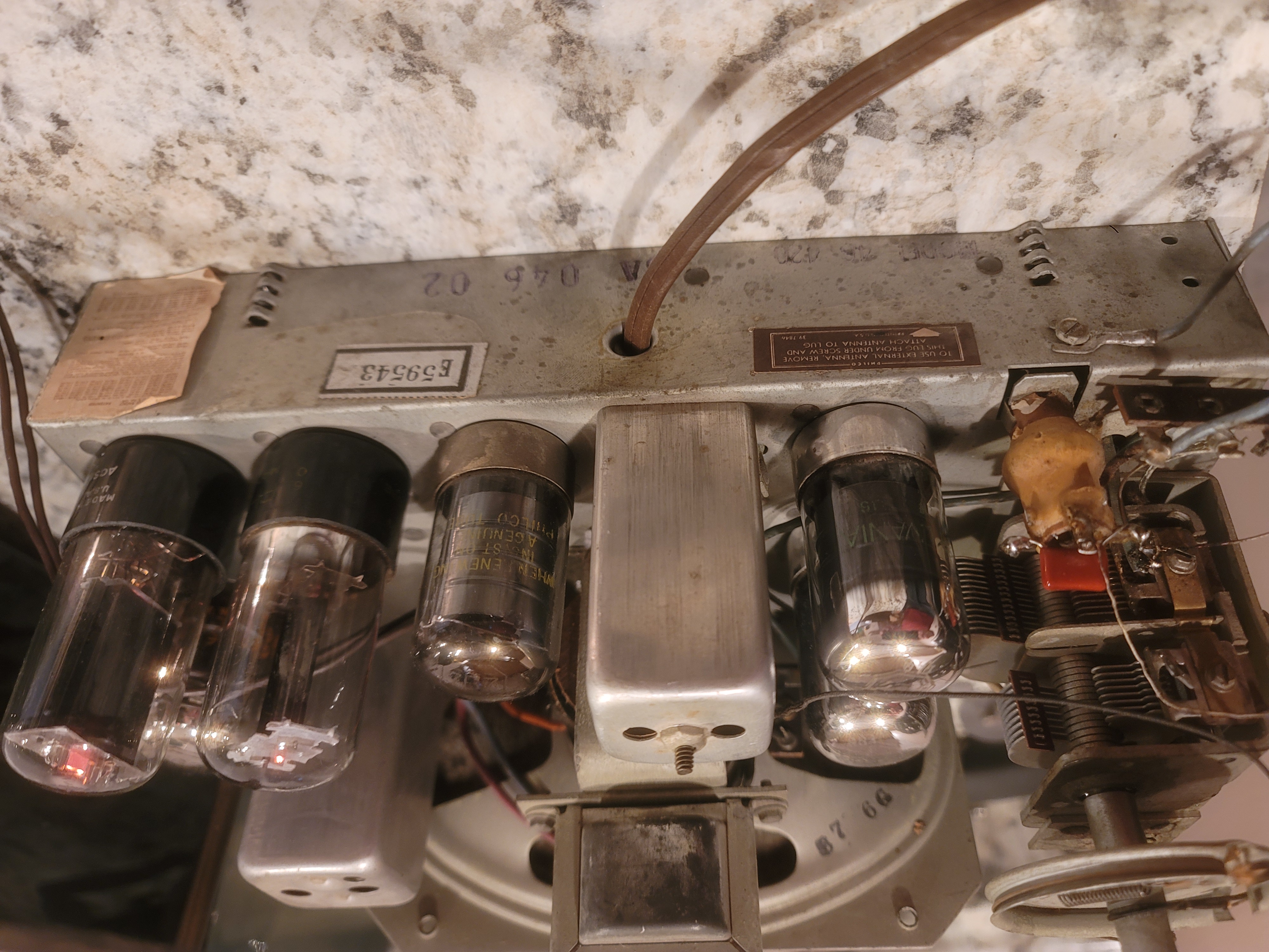

Forgive me, there is a problem with the document from the Philco Library that I was using.  The document is for Model 46-420; the pic is of the "Hippo" cabinet, the chassis is a 6 tube job, the sectional schematics are likely correct, but the complete schematic is for a 46-200.  Can't write to Philco to correct it, the company does not exist, the buildings are gone and the engineers are in the afterlife.
MRFixR55
I'm going to give everything a shot this morning. What schematic are you using? The schematic I found was some kind of philco service bulletin I don't really care for it because it seems to have a lot of shortcuts and not a lot of detail.
Also considering I've lost that little choke is it worth trying to rewrap it around my capacitor? I thought the new style capacitors were better shielded and didn't need this that's the only reason I didn't transfer it, but seeing as it acts as a choke it should be very necessary to the radio. Also I might just scuff the ground rivet on the terminal strip and solder it to the chassis to make sure it has a good connection.

The capacitor with coil (C401) is a wave trap roughly tuned to 455kHz to prevent nearby interference from other rf sources. Don't know when Philco stopped putting them in but you don't see them in later sets. My experience is there's always 8 turns of wire in series with the cap. You have 3 options; leave the coil out of the circuit, wind wire on a new cap, or remove it altogether. I think most use option 1 and put in the cap only. This is one of those things where you want to be a fly in the room during the design discussion. (Hamilton: "I want to be in the room when it happens!" )
