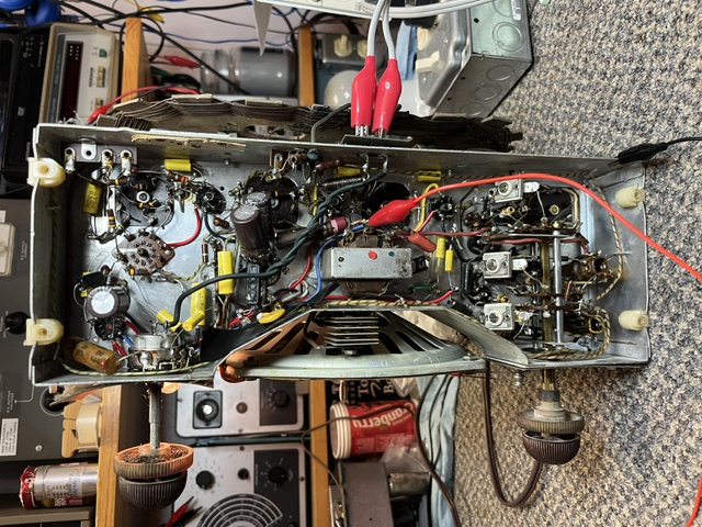

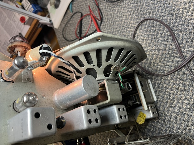

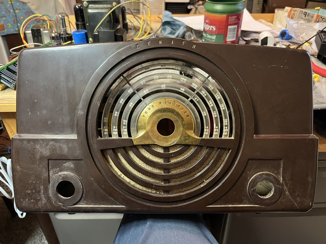

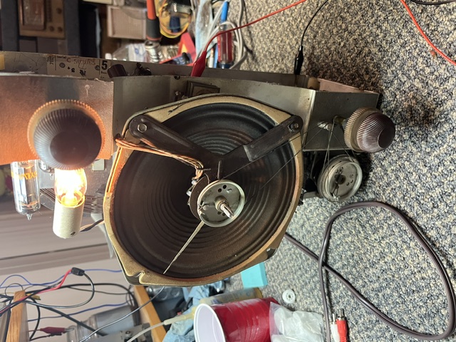

I don't think I posted about this one, so it's (hopefully) near the final of the resto. I read where Mike (Morzh) did one or very similar. I have the recap done, had to replace the dial light socket since the original came from togetherness. I used a candelabra socket from a local home store and managed to get it into position without any mods to the chassis or cabinet. I've cleaned controls and tube sockets, and have it playing pretty good. I do feel an alignment would bring it in even better, but haven't done it yet, so it's on my list. I think I saw where Morzh had some alignment issues but not sure what he did to clear it up. In his YouTube video, his sounded just like mine. Clear but yet kinda fuzzy and the dial tracking is off. I had planned to throw a 10.7 mhz signal through and adjust for best waveform, then set the discriminator to balance. It's "almost" good enough as it is, but I feel this radio is much more capable, and it DOES have a very good sound! Below are a few pics of my work. Nope, I didn't restuff, but I don't think the radio will really care.
EDIT: I did replace the selenium rectifier with a single diode and didn't do anything else. At 120v input I get 129v on the B+. Just a FYI.

Your radio is looking good! I love this vintage of Zenith sets as they have an RF amp and 2 IF stages for all bands. They are just good sounding and sensitive sets.

Tim, I have the similar radio, only 1 FM band so otherwise the same set. I also replaced the selenium rectifier with a silicon diode and nothing else. The few extra volts of B+ I figure didn’t hurt anything and it’s been playing for nearly 2 years just fine. This is a good performing set with plenty of volume and sounds great with the 8” speaker. I’ve modified my Eico sweep generator and bought a 10.7 MHz crystal for it to have a rock steady signal for IF alignment. Also bought a 9.1 MHz crystal for doing certain Philco FM sets. Love this set!

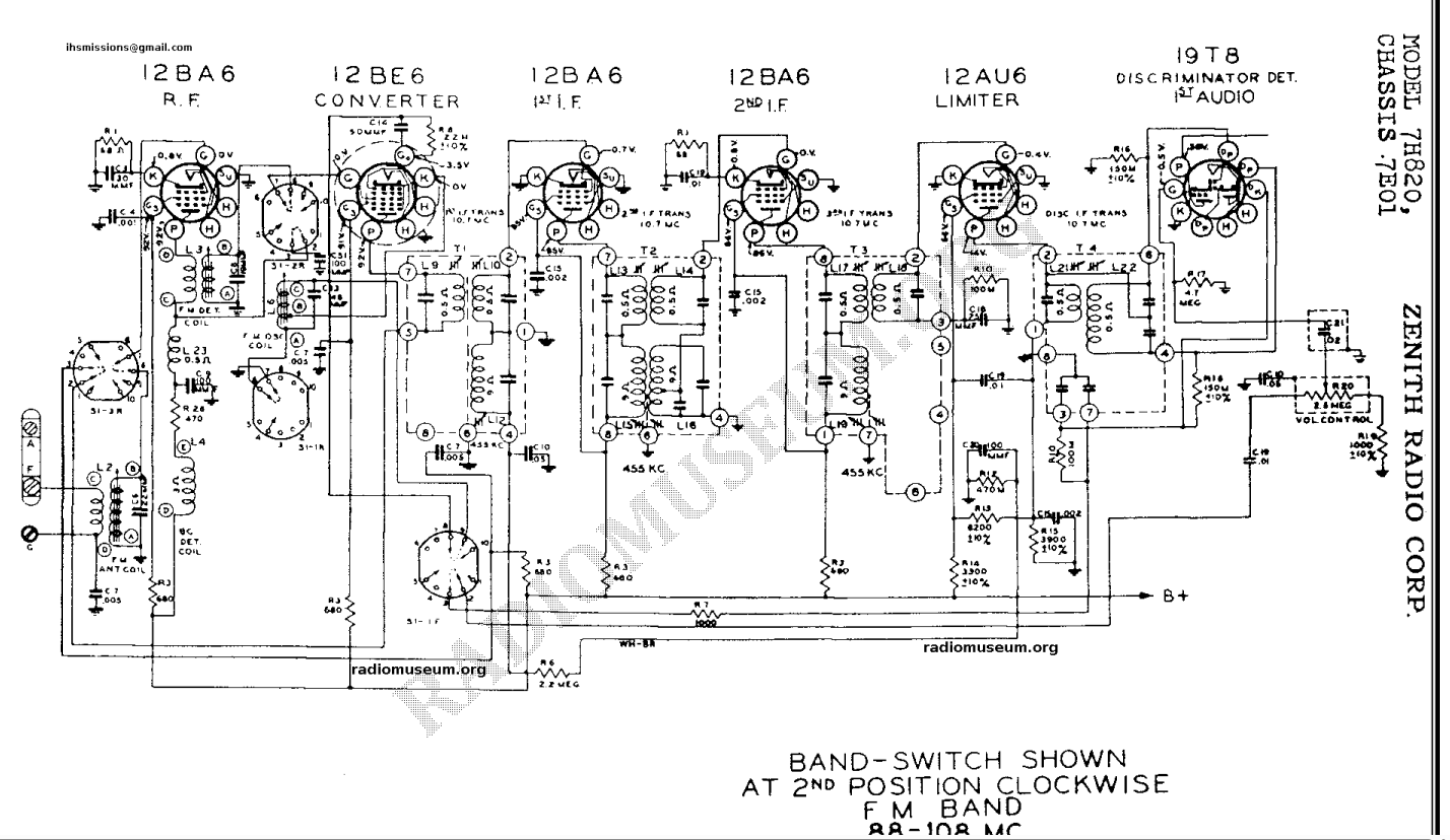

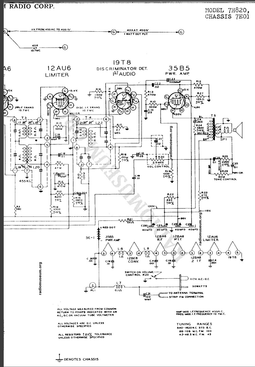

Here's the schematic. It is from Radio Museum, so it's in 2 parts. I think the cap Shango is talking about might be C19, but it goes to the band switch, and looks like if I clip it, then one end of the volume control is floating. May be a non issue - unless it's something to di with the AVC. I did notice that the AVC seems a little weird, meaning that some stations are much louder than others, so I may need to take a closer look. This one shows a shielded cap going to the volume control like Mikes (Morzh) on the schemo, but I don't remember finding that in my set. It looked original when I started. I even went through the paper caps I removed and double checked and didn't find it, so this radio might not have it. Anyway, I have the alignment information, but may have to do it like Mr. Carlson and inject a 10.7 mhz signal and take voltage readings at the detector transformer.

Tim, I don’t like how Zenith draws their schematics using tube base drawings the way they do, I go cross-eyed trying to unscramble it, so I sprang for a Sam’s Photofact for it, makes it so much easier to read! Sam’s does a great job of clearing up schematics.
