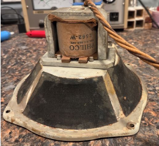

Hello, I have a Philco 650 with the speaker that has fabric covering the openings. What is the purpose of this and will removing hurt anything? I want clean it as it looks crappy.
Thank you,
Dan
I think this cloth keeps dust and particles from getting into the space between the voice coil and the magnet pole.
In today's speakers the rippled spider protects that space but in the older speakers where spider did not go over that space it would easily get clogged.
When you remove the cloth, it is fine if you clean the speaker and keep it in the clean environment, but then there are still particles and dust, and perhaps pet hair etc etc, so I would re-glue the cloth back after cleaning.

Same here. I have never seen these coverings and don't know how effective they are when the front of the voice coil is not covered by anything other than the grille cloth.
It is interesting, as many radio speakers, from the 30s up to about 1950, including those with the more modern phenolic corrugated "spiders" do not have dust caps on the cone, covering the voice coil, let alone this cloth covering on the frame. Sets with this cloth covering usually do not have that felt dust cap over the voice coil. It was understandable that the original speakers where the "spider" almost looked like a spider, but more like the 45 RPM adaptor. These were not covered because of the screw that held the spider to the magnet pole piece.
I took my fabric off and underneath was a good deal of rust and yes there was some dirt as well. I will not be putting that fabric back on because it is full of crap.
If you want, you can likely find a similar fabric from a fabric store. It looks similar to a thin cotton fabric that they used to cover the underside of upholstered furniture with.
The cloth should probably be reasonably permeable to air. Else it will impede the cone's movement.
