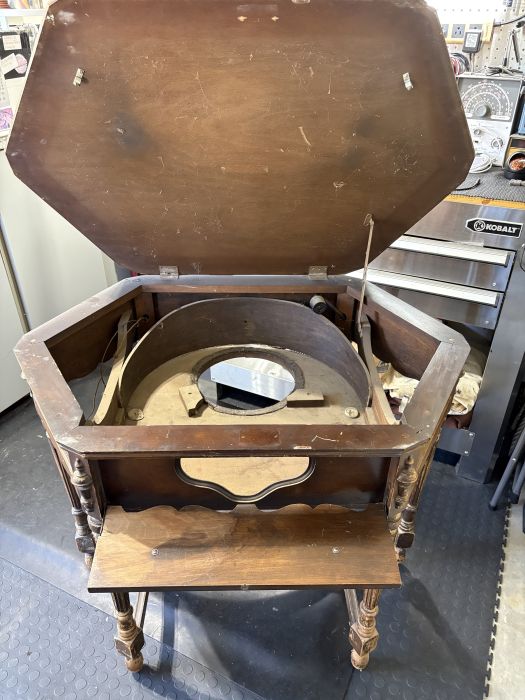

The chassis and speaker (voice coil 2 ohms and field coil 1048 ohms) were already out of the cabinet and the top of the cabinet and a small portion of the front door panel has been stripped already. The speaker does have some tears in the cone but those should repair easily.

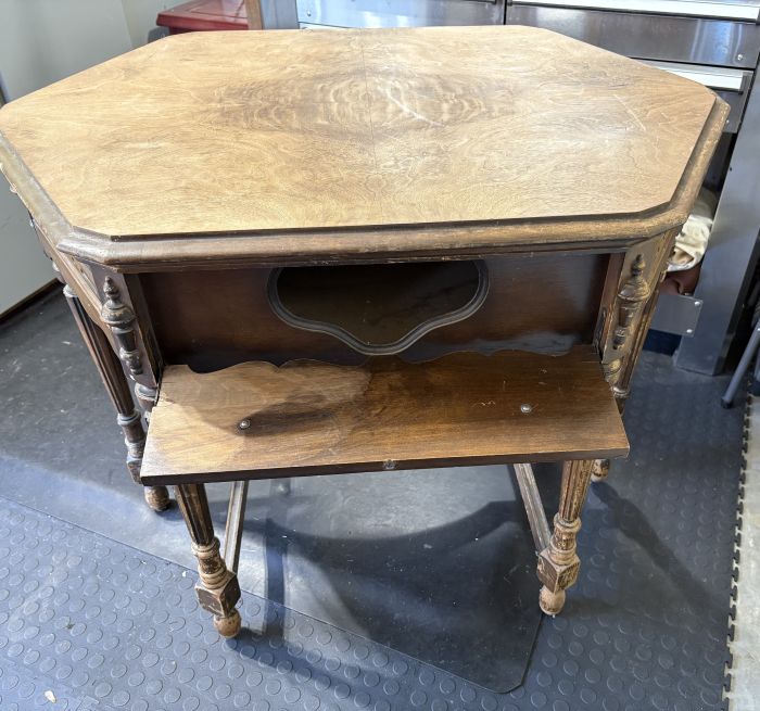

As I go through and clean the cabinet (vacuum and then a damp cloth with detergent and water) I'll look for obvious problems. You notice immediately that someone has removed the Atwater Kent metal plate that goes underneath the top and also the Kiel Table metal plate on the front top of the rim that the top closes onto. Most of the time the Kiel label is a decal but I think some of the early tables had a rectangular metal plate. The RadioMuseum has a photo of one of the tables with a metal plate although you can't read it.

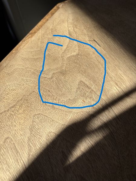

The top I think will come up nicely although there are some nasty spots on it that may not come out. I can not tell if they are ink or stain.

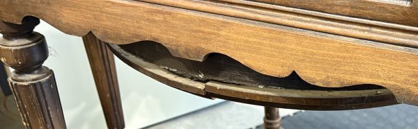

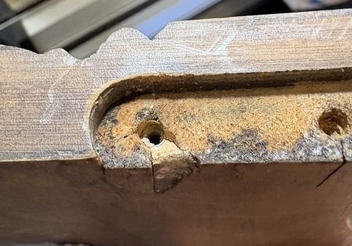

The base that the chassis sits on needs some regluing and reinforcement.
and the front panel door has an old repair for a split out screw that I think will need to be redone.

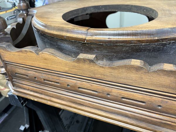

The glue up of the base that the chassis sits on went pretty well. This is a real weak spot in these Kiel Tables. The first one I restored had a similar problem. The weight of the chassis is a bit much for the way it is stuctured. Rather than wood glue I used epoxy for a bit stronger bond plus I did not have a good tight wood to wood surface to glue. Turns out that the large curved flat piece of wood that the base connects to was also missing a screw that connected it to the side of the table, a pretty important structural support component.

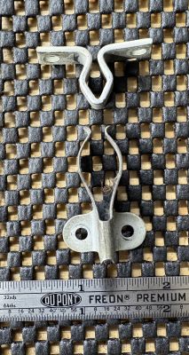

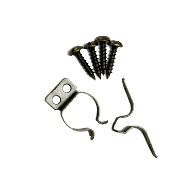

I'll be looking at replacing the spring friction catches on the table top. One was missing completely including the glue block inside the cabinet that the bottom half fastened to. The other had a loose glue block. I didn't think I would find replacements but I did get pretty close:
Original:
Replacements, from Kennedyhardware.com :

Have you had a look in the Lee Valley hardware catalog too? That original looks a lot like the catches they used to use inside kitchen cabinet doors, with those they sometimes used a round headed screw for the claw part to grab onto.

No, I had not looked there Arran, thanks for the suggestion. After a look, it seems they don't quite have what I'm looking for. I did go ahead and order a set from Kennedy Hardware.

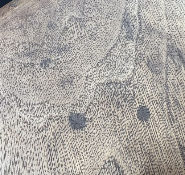

Those black stains are likely iron stains, rather then ink, they seem to show up on walnut, solid or veneer, caused by water from a potted plant, vase, or who knows? I've heard of some using wood bleach to fade them but I found that phosphoric acid may also work, wood bleach is often oxalic acid anyhow. Regarding that split in the base near the edge of the speaker opening, would it be possible to put a dowel through it? I was going to also suggest using a wood biscuit but that board would have to be split apart to do that.

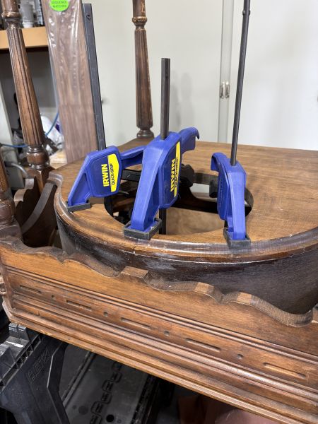

I think I got the split near the speaker back together pretty well with the clamps and glue. The missing screw I mentioned was, I believe, a significant problem that caused the base to sag under the weight of the chassis. Should be much better now. I may even add another screw just for added strength.

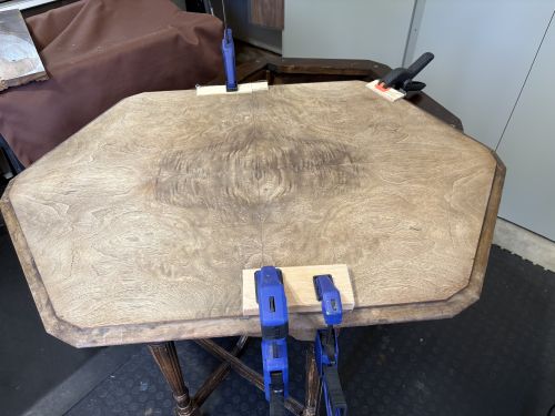

Started working on the tabletop to try and eliminate those spots. I gave a slurry of baking soda with light brushing with a toothbrush a try to see if it would help. That's the recommended approach for ink stains. The backup is to try a bit of alcohol on a swab. Neither of those did much of anything. My tub of oxalic acid came out. A solution (the concentration of which varies depending on who you listen to, but I put about 4 tablespoons into about 200 mls. Worked the solution into the spots a little with a toothbrush and then wiped the entire top with the solution. You need to wear rubber gloves and avoid inhaling the crystal dust (wear a mask). I then let it all dry, neutralized it with a solution of baking soda, rinsed with water and let it all dry. For the most part the spots came out which means Arran was right, probably iron deposits.

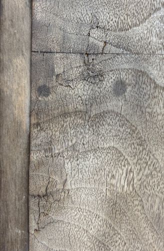

Next I tackled some of the lifting veneer around the edges of the table top.

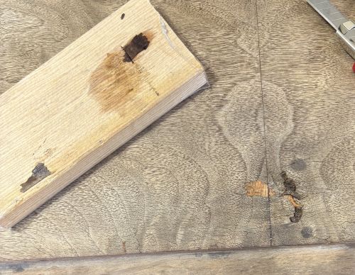

The top two glue ups worked just fine but for the bottom one...as Chuck Schwark was fond of saying...
When I put the caul down for the glue up, I put the wood side down on the table rather than the side with the packing tape on it (packing tape will not stick to the glue). So I now have a piece of wood glued to my table top!
*&*(^%%%$!! darn it.
I heated up the caul and underside of the tabletop and tapped the side of the caul with a hammer. It did come off but it took some of the veneer with it. In this picture I've gotten some of the pieces unglued from the caul using water (I had thankfully used hide glue to do the glue up) and am starting to put them into position. Its very "fiddly" as they say in the UK as the small pieces move all over the place as you try to get them to fit. I've finally gotten them into place and put the caul back on ... correct side down this time... and we'll see how it looks tomorrow. You can also see two of the spots I was trying to bleach that did not respond as well as the others...

Any way... it has gone back together pretty well. I'd say about 95% all back in place and glued down. After toning and clear coat I think it should look OK.
