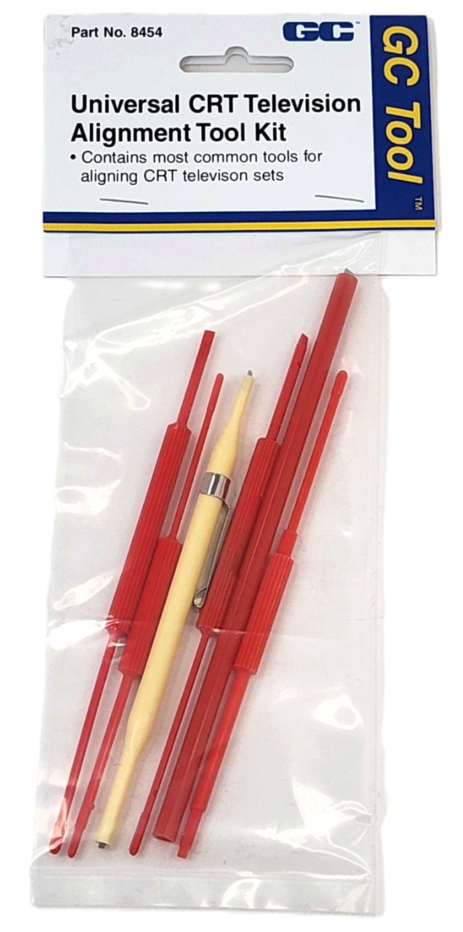

There ain't no fixing needed. Only extraction. It's smooth plastic, right? One of them red rods?
Like these?

And yes, the one I am trying to extract is like one of those red ones pictured in morzh'z post, but mine was clear rather than red.
