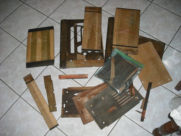

It has been about a year since I have found any project fodder so my buddy Pete Bertini offered up this one.
[Image: http://i132.photobucket.com/albums/q18/b...8dc2e2.jpg]
Not as bad as it looks Icon_crazy
With a couple of days of gluing I've transformed it into a good solid cabinet. Had to replace the bottom floor and some of the lower front panel stuff. It will get new veneer on the sides. I think I can save the front. Chassis isn't so bad and it came with spkr and knobs. Its coming along nicely.

Hey Bill
Your set is looking a bit FLAT! But I have complete faith in you! I know YOU can make this pile of sticks look like a brand new radio set.
Have fun with your project !
