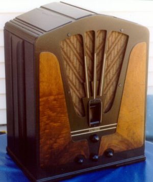

    I NORMALLY DONT KEEP STUFF THIS OLD OR POST ON THIS FOURM BUT I JUST GOT THIS 16 B OFF OF CRAIGS LIST FAIRLY CHEAP MY BUDDY TA FORBES HAS TALKED ME INTO KEEPING IT .I WAS WONDERING IF ANYBODY HAD ANY ADVICE IN RESTORING THESE I BUY A LOT OF RADIOS AND THIS ONE IS PLAYING AND VERY CLEAN. I WILL RECAPP IT TOUCH UP THE CABINET .LOOKING FOR LITTLE HINTS
Sounds like you know what you're doing. Very nice set. I now replace all the small carbon resistors and pilot lamps while doing a recap job - cheap, easy, and eliminates many points of future failure. Makes a big difference when touching up the alignment.
Henry, that set's finish is pretty nice!!! Just make it electronically sound and enjoy!!!
There is a fellow on You Tube (Lockmeister is his handle) that restores one of these, I don't remember whether it was the five or the four band version but search for his videos on restoring one of these. One thing that goes out sometimes, in addition to the usual capacitors and carbon resistors, is the coil for the shadowgraph. They also have an audio interstage transformer which can go open, but this is something that can happen with any set employing a push pull output stage, so check the continuity on both windings, especially the primary. I've worked on a 116 but not a 16, and the restoration is definately a lot more involved then your typical five or six tuber.
I have a 16B this is one the best radios I have...5 bands. Shadowgraph doesn't work but boy does it receive. I refinished the cabinet and it turned out beautiful.

Thats a nice 16B. I'd leave the cabinet as is Icon_thumbup
