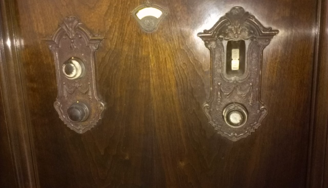

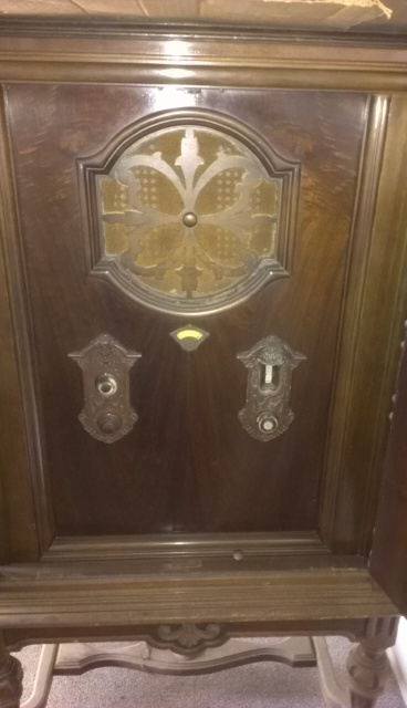

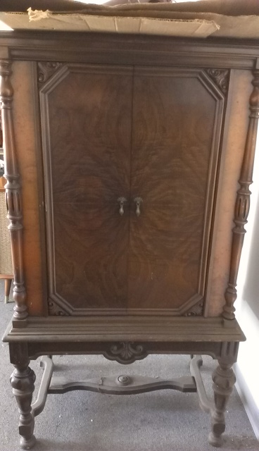

Well I just couldn't resist. Today a Radiola 64 followed me home. I purchased from an estate sale and after speaking the original owners daughter when I picked it up I found out this was only the 3 time it's ever been moved. Her father purchased it new in 1928 and got and kept the service manual that came with it. It was in a basement for the last 30 years so there is some slight delamination but other then that it is in remarkable shape...and remarkably big and heavy.

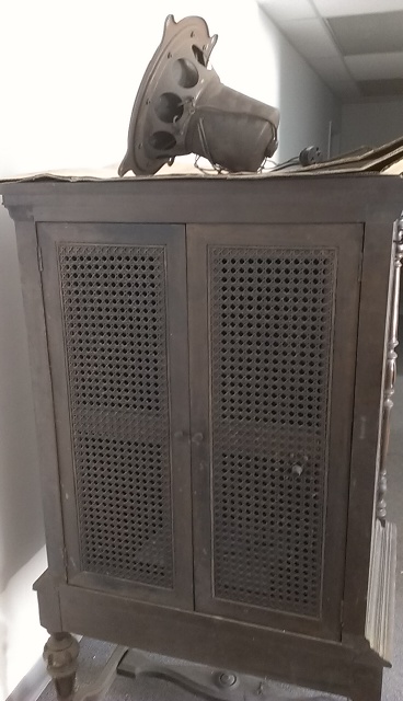

The set is a great piece to have. It has very good audio. The Radiola 64 chassis was used in a few Victor and Brunswick phono combinations. The biggest Victor phono combination that was ever made used a Radiola 64 chassis. I wonder why the speaker is out of your cabinet??? Possibly an open field? If so, they can often be repaired.

Thanks Doug, I have read that the power transformer is a problem. This one was replaced sometime in its life, I noticed it when I pulled the amp section for transport, the same with the speaker. I need to give it a good once over for sure, I moved it to my shop yesterday and when I have time I'll check the speaker Power resistors...etc. I did pull the 50 tube out and wrapped it very nicely after checking the filament..which is good, what a break. Supposedly, The original owner listened to it every day until he became too sick to care for himself, then it was put into storage. It will be an adventure.
