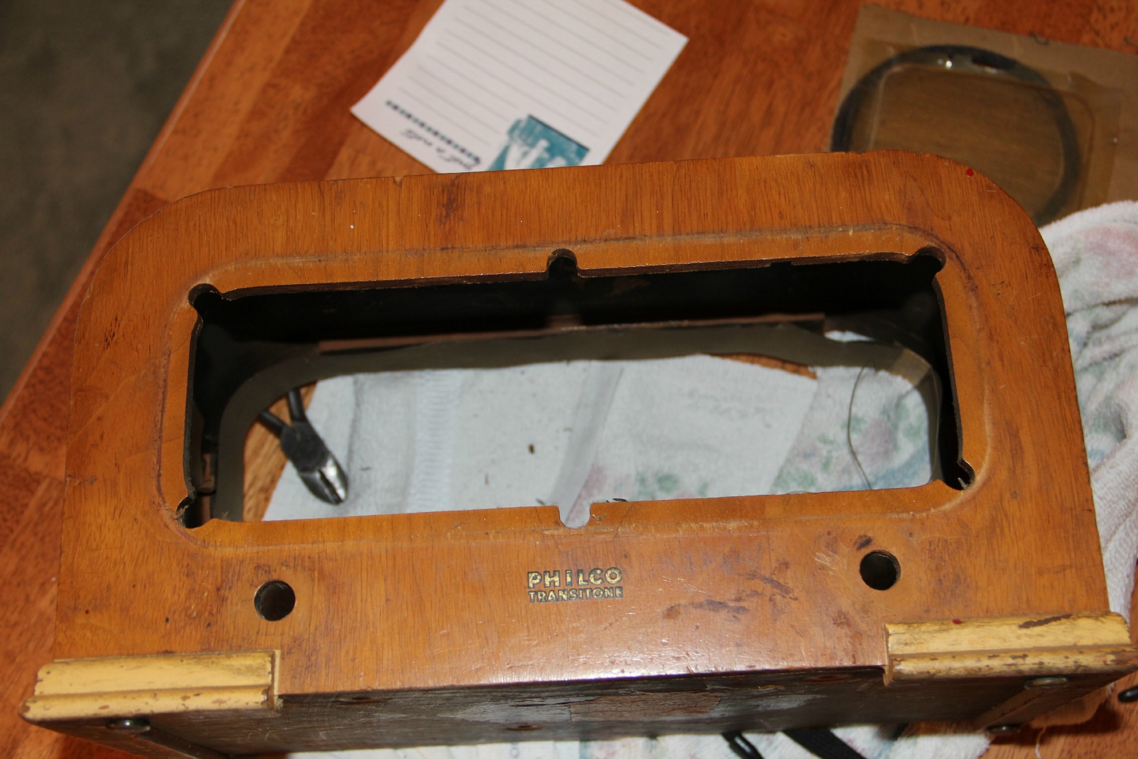

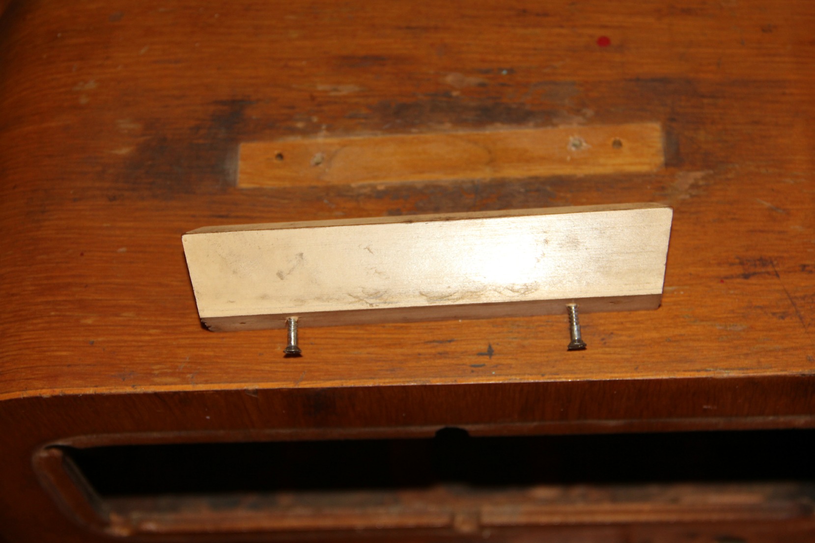

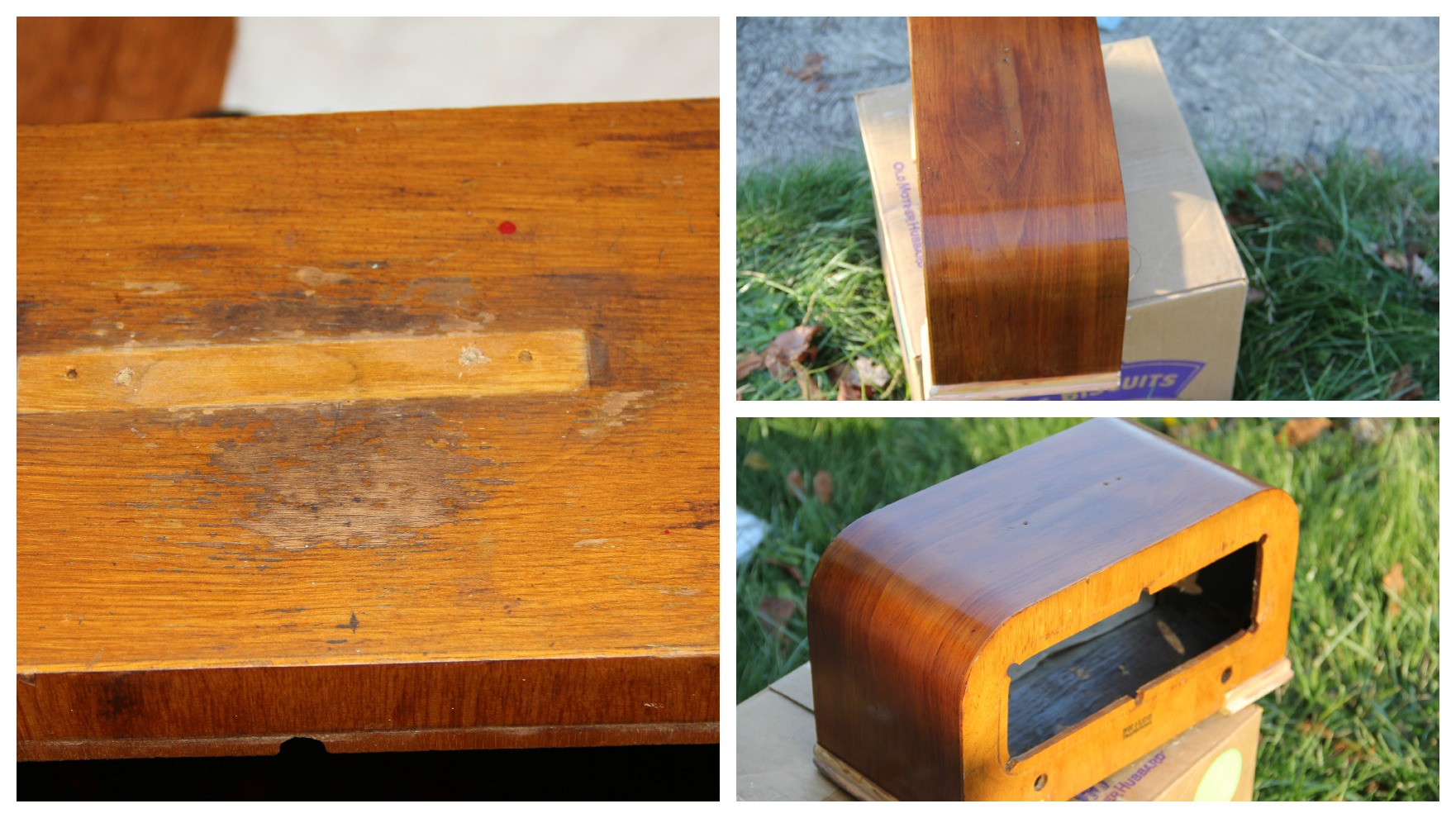

Here is a before and a couple of after pictures, regarding stripping the old finsh off and putting a very light base coat of stain on.
I still need to tackle the trim and apply the finishing coats of lacquer, but looking good. I decided to only strip the top and sides and not the front, because the front cleaned up well with the gojo.
*** Question ****
In putting the cabinet and eschulon (sp) back together. The speaker cardboard and the front dial lens were held on with staples (small ones). What do people use to reapply this. Is there a small staple gun for tight places ect ????
Looking for hints from the experts on how to properly reassemble.
