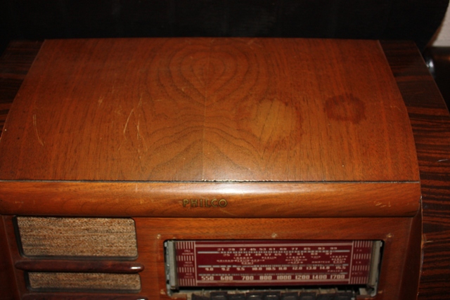

Newcomer/lurker......found a Philco 42-355 in decent condition. There are some stains on the upper curved part of the veneer. Can these be removed without a lot of sanding? It has all the buttons but I will need the plastic panel the buttons project through. The screws are all there it's just the plastic got brittle and broke where it holds the panel on the wood. Looking for that.

It depends on which part of the upper curved part of the cabinet you are talking about. Bear in mind that the left and right edges are photofinish - strip that, and the "veneer" magically disappears! Icon_eek The center portion is real walnut veneer, though.
You don't want to do a lot of sanding - as little as possible, really - too much and you go through the veneer into the substrate. Try to avoid sanding if at all possible.
If you can post a photo of the cabinet, perhaps one of us can give you a better idea of what needs to be done to correct the problem.
The stain is on the center walnut section. I won't touch the end pieces now that I'm aware of the problem with that. I will shoot a pic and try to get it on the web site. I'M NOT GOOD with computers. Do the best I can.

    Here's the pic of the 42-355 stain.
Idaho, welcome to the Phorum. That stain doesn't look too bad. I would start by cleaning the top well with gojo hand cleaner, not the stuff with pumice, the cream stuff and see if it helps any. I had a top that someone had placed a plant that leaked on it and took away the whole finish to the wood. Tried to "patch" and color. Ended up just stripping the whole top. Came out nice. Of course there is the other option to buy a nice doily and put it on the top.

Thanks....I will give the GoJo a try. There are so many directions the grain runs, I don't think I want to sand. The doily sound like a doable project.Icon_biggrin

Mike, you don't want to "sand". If you desire to refinish the top, tape off the rest of the radio and use a stripper or just some 0000 steel wool and lacquer thinner with good ventilation. It will come off easily without sanding damage to the thin veneer. A good wipe down with the thinner and a rag. Let it dry then perhaps a little light buffing with the 0000 steel wool to get any residue off.

Thanks for the info. Heading to Home Depot for the steel wool. I will let you know how it comes out. My hope is to get the stain light enough that I can just shoot the top with Varathane or something like it without having to redo the "Philco" decal.

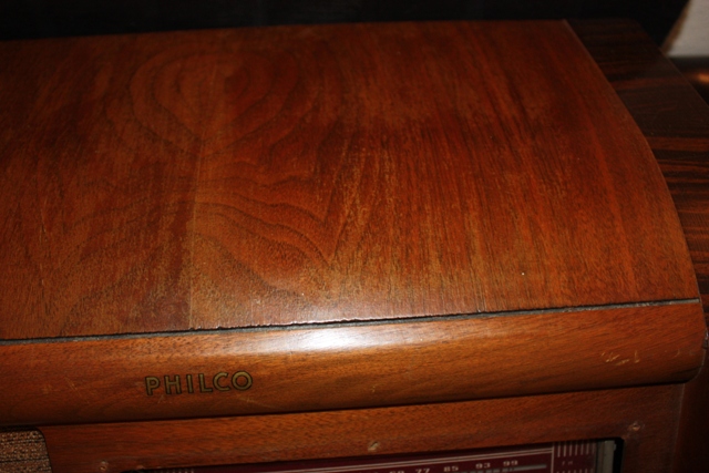

WOW!! Rubbed the veneer lightly with 0000 steel wool, removed the dust, then wiped it down with a white cloth dampened with acetone. Buffed it while still damp. It worked perfectly - thank you very much.

Another great lesson learned by me! That really worked well in that it was more of a stain than a lifting of the finish. I will certainly keep that in mind and a jug of vodka on the ready.
