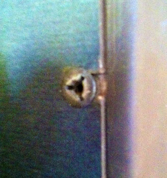

I found one such "clip" (below). I imagine there were at least two more purely based on the holes available on the frame and my repro cover not used by feet.
I'm just wondering if my guess is correct, is where to buy them? I'm talking with Mark at oldradioparts.net to see what he has. (He's been extremely cool about my weird foot screw fascination Icon_lol ).

Here is my on "clip" with the repro base slid into it (crookedly since I only have one and no screws yet):
