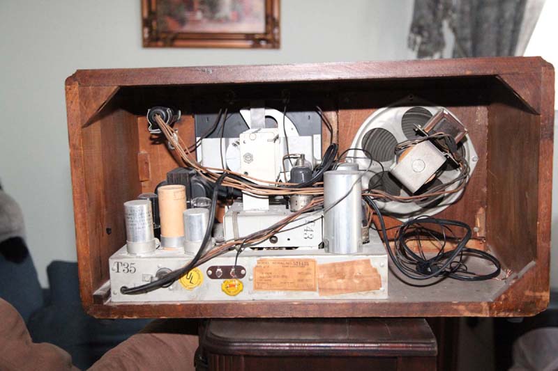

So I took the chassis out. As a minimum, the tuning cap belt is broken, so I've ordered one from Adamsradio - thank God for it. Almost every single radio is listed there. Bought various Zenith belts, now the WR-212, all listed by name, easy!
Well, started to look: someone tried to repair it some time back.

Now if you look at the caps, all the electrolytics are 8uf, 12uF or such.
Imagine my surprise: the guy put in 150uF-300uF-75uF.....yikes.
So, I think I have'em all, but good thing I am checking it.
Can't trust people nowadays Icon_smile Not with the caps.
Speaker was obviously repaired - some glue on the back of the cone and, for whatever reason, a piece of felt was put in between the cone and one of the frame spots. I wonder why....hopefully it sounds OK, otherwise more money goes to some Speaker shop.

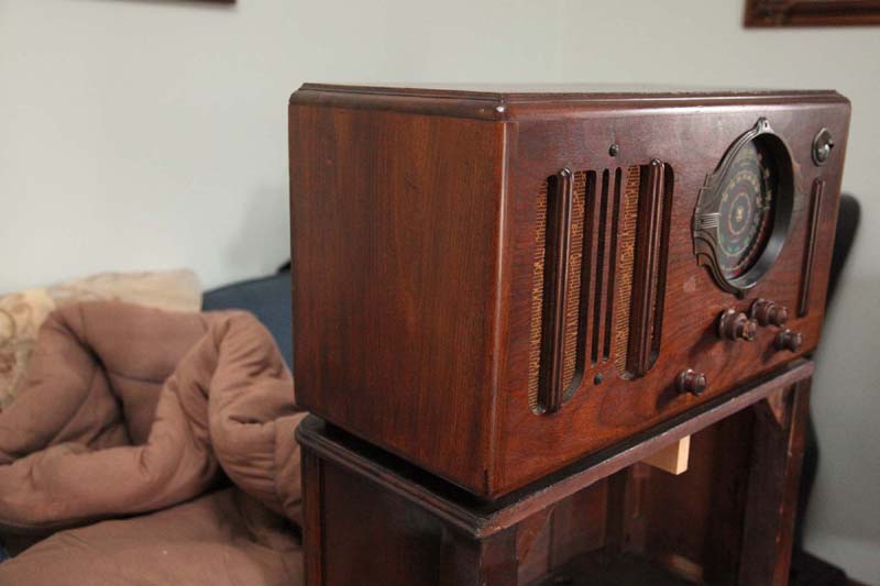

This is the radio.

That is a handsome set!!!!
Yes indeed, that is a very nice looking setIcon_thumbup

Wow, that is a nice looking table set. I definitely would snag one if I found it for the right price!

I think that the speaker may be a replacement, possibly from the 1940s or 50s. The pincushion style speakers weren't that popular outside of Philco back in the mid 30s, most 6 and 8'' ones used a round frame.
I also feel like it is a replacement, I just thought that the field coil types were no longer popular in 50s when perm magnet types replaced them.
Actually looking at the e-bay link I posted here you can see the original was a round one. I guess if I feel like it I could try to buy it, the model is written there - 72203-5
