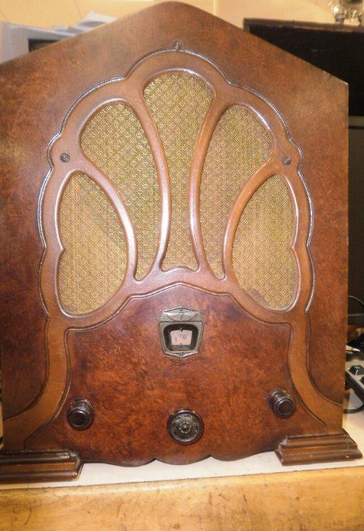

i got this JB from a co worker the other day it is a nice 6 tube superhet with 3-57's,a 56,33 output and an 80 rectifier tube anyone have an idea of the chassis model number thanks Don
The 33 is wrong, it's an 2 volt output tube for a battery radio, very likely it was supposed to have a 47 or a 2A5. Somebody probably grabbed a random tube with the same base just to fill an empty socket, or wasn't aware that a 2 volt battery tube was very different from a 2.5 volt AC tube.
yup i haven't measured any voltages yet BUT the set has been playing that way since who knows when it was in used daily until a few years ago and plays now with very little ,or no hum!! (i would have thought a 2.5 volt tube would have poped) or HUMM with twice the normal filiment voltage Don
Nice JB, but yeah, the tube line-up sounds wonky with that 33 in there. It'd be nice to see some pictures of the chassis. It might be a more common chassis used in a less common cabinet.
The cabinet doesn't look familiar, but JB was a small west coast company and undocumented models turn up now and then. Looking at the cabinet style makes me think it may have been one of their later (last) sets made. JB is usually pretty good about having the model number stamped on the chassis or engraved on a chassis plate.
I just did a quick scan of Floyd Paul's JB documentation and didn't see a cabinet like yours.
