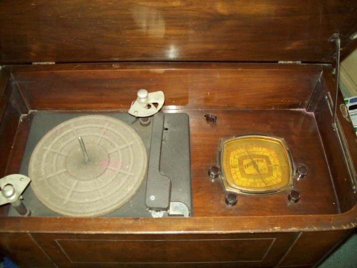

Went to the Navarre, Ohio flea market today and found a Truetone model D1075 radio-phonograph console in decent shape. Finally have the radio to complete my 'big three' postwar department store radios. Sears, Montgomery Wards, and Western Auto were the big sellers of department store radios around my area at that time. This looks to have the Detrola built chassis in it. Wasn't wanting another big radio-phono set, but it is hard to find prewar Truetone radios here and when you do, people treat the units with the Detrola chassis like they are gold price-wise.

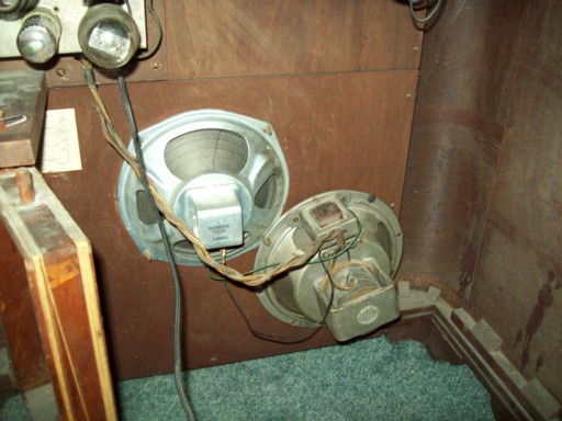

The radio portion of my Truetone radio-phono is now up and working! The bad thing was that the voice coil on the original speaker was not good and the cone crumbles from the slightest touch. My friend came up with a novel solution until I can find a proper repacement. Use an 8 inch PM speaker (which just happens to fit where the original went) and bypass the voice coil wires to it while still using the original speaker for the field to keep the radio happy. Not a totally pretty idea, but it works quite well and this radio sounds rather good.
I really like the dial on this unit. Because of being under cover, the colors are still quite vivid when the radio is on. Also a good performer that sucks in stations quite well.

You may be able to rebuild the original speaker, this place here seems to sell some speaker parts, voice coils, cones, etc., whether they would work in your case is another story.

That is the plan in the future is to have the original speaker redone or maybe find a donor. Right now I can at least use the radio until I have it done.
