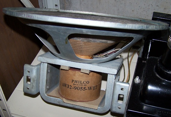

Well I'll be! Icon_eek First one I've seen like that. (Not a Philco expert by any means) I checked the speaker I have which I think is original. (see attached pic) The mounting bracket with holes that apparently would use those bolts, when mounted would align the speaker with the hole in the front of the cabinet.
I wondered why there were no "normal" small bolts around the perimeter of the hole in the speaker board. I was prepared to use some small screws to mount it there. As heavy as that speaker is, the shelf and bolts would be appropriate.
Thanks Ron.
It looks like they used some sort of hook like a "J" bolt to hold the speaker down, probably with a flattened end to fit those slots. Why they would bother with such custom hardware in this case I have no idea.
No, in the case of the speaker, two conventional round head bolts are used which have a "square" for lack of a better term under the rounded head. This "square" locks into the holes in the mounting ears of the U-28 speaker used in the 38-1. A washer and nut are attached to each bolt, on top of the speaker mounting board.
Ron's description is typical of a "carriage" bolt.
Yeah, that's it. Icon_smile I was at work when I composed my previous post and could not think of the proper term. Philco used these to hold all of their heavier speakers in place - the early H series in 1929-31 consoles, U series speakers in 1933-38, and the 14 inch W series in 1937-38.

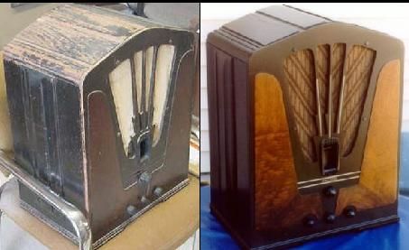

Two radios were given to me by two friends, brothers who are in the construction business. They did some remodeling in the college president's home in the town I live in. It had been built originally by a doctor and his children gave the house to the college after their parents died. It turns out there were two Philcos built into the wall or built-in cabinets along the wall. (my friends asked me if I wanted the radios---silly question right?---otherwise they were going to the dump!!Icon_eek ) The cabinets were no where to be found. The first radio was a 16-B. It had been built into an alcove/nook in a family room wainscoated with the old thick grooved wainscoating. Slots were cut in the wainscoating for the speaker and the controls and both were hung on the backside of a door fashioned out of the wainscoating. I restored the chassis--speaker needed nothing. I found a guy with a cabinet in Oklahoma. Restored the cabinet--pictures attached. Great receiver on all bands!
