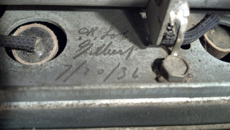

And I just found this mark on the tuner sub-chassis.
OK for ??? 7/20/36
Very nice lookingIcon_clapIcon_clap
???-Gilbert
OK for Gilbert?
Who's Gilbert?
