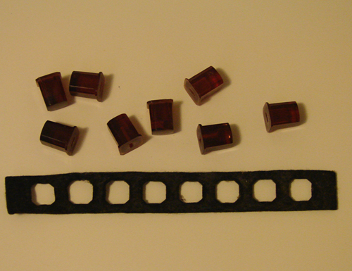

    I'm restoring a nice "Skyscraper" model Philco 40-190. Three quick questions:
What kind of glue do you use when adhering the pushbuttons to the metal stems?
Second, where is the black felt strip (blocking light) suppose to be? Does it simply ride between the pushbutton and brass escutcheon or should it be glued to the back of the brass? When I disassembled the set, the felt had slipped behind the buttons in places. I'm afraid it will do it again.
Third, does anyone sell the new felt cut to size?
Thanks, jmac3ky

My 40-150 did not have a felt on it when I got it, so I've never been sure if it was supposed to have one. I made one anyway, like the 1941 radios had, with just a slit for the stems to go through, then I wondered why I didn't get much red glow through the buttons. Duh! Now that I see your picture I realize my mistake.
If the holes in the felt are just large enough for the buttons to go through, then I imagine the flanges on the buttons that aren't depressed would be enough to hold the felt loosely against the escutcheon, keeping most of the light from leaking around the buttons. if any holes are enlarged from wear, though, the flanges might not be big enough.
I see no signs of glue on the back of my 40-150 escutcheon. Does your felt or escutcheon show glue residues? Unless someone more knowledgeable than I am tells you that the felt was glued to the escutcheon, I'd try just pushing the buttons onto the stems, then slipping the felt over the buttons, then mounting the escutcheon. If the button flanges don't hold the felt closely enough against the escutcheon to block the light, then gluing the felt to the escutcheon might be called for.

Thanks John. I'll probably try gluing the felt to the escutheon, since the felt is old and a bit stretched. I would cut a new one but the shape of the openings is too hard to cut accurately. I'm sure it was punched at the factory. I'll have to glue my new pushbuttons in place since they come loose when they pop back (spring loaded). I think I recall having to pry some old ones off in the past. They must have had some factory glue.

Use an exacto knife. Shouldn't be too hard.
J-mac, I have a 40-190 and although i have a stem or two where the pushbutton is slightly loose, they've never gotten far as the escutcheon chokes 'em by the raised collar at the back of the button. I would be very reluctant to glue the buttons down, especially if I can't find a way to reverse the process easily.
As for the felt slipping past the collars, hmmm... maybe a gentle washing in Woolite or some such to restore the shape?
If that doesn't work for you, I would suggest using the escutcheon as a stencil for making a new felt mask for the buttons. It'll be a trifle snug at first but should stretch (much like the old one) to mask beautifully.
OH! Placement... no glue attaching it to the escutcheon on mine, either; it appears to ride the buttons in front of the collars and behind the escutcheon.
Finished putting the pushbuttons and escutcheon in place. Cutting a new felt with an exacto knife doesn't work. Felt stretches as you cut it, even with a new blade and steel ruler holding it down. So, I went to plan B - I glued the felt to the back of the brass escutcheon, carefully tightening up the felt to match the square openings. It worked like a charm. I also put a dab of Elmers glue on the steel shafts so that the buttons stayed in place. Worked great. Light shines through fine, although Philco should have spaced out two lamps to light the buttons equally. The center of the button row gets most of the light. Thanks for your thoughts guys.
