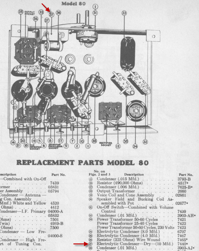

According to my Philco 80 schematic which shows a 7440 cap it is a 10uf DRY electrolytic cap.
-Keith
Thanks Keith! Philco and their numbers. Yours is correct being a 10ufd (probably 450V) filter cap on the B+ line with the 300 something ohm wirewound #35 I think, resistor. But this is a car radio and all of the filter caps are in a can on the dynamotor housing. No filter caps on this chassis. I've identified all cap can values (less this one) and none of them are lytics.

And there would be no reason for a 10ufd lytic filter cap on the cathode of the 85 2nd detector in this radio. Maybe a 1ufd or 2ufd @ 25 volts. I'm just not sure. My Riders paperwork calls it out as part #7774. What is the asterisk next to the part number on your 10ufd for? Possibly some note?

The * is indeed a note that says this cap was eliminated is production runs over a certain number.

Keith, Here's a model 80 schematic that must have been a later run because that #37 10ufd cap isn't on the schematic. Maybe replaced by the 8ufd and 4ufd.

That 10 uF dry electrolytic in the early model 80 was a low voltage cap, placed across the bias resistor (#36) in series with the power transformer center tap to ground. Evidently it never needed to be so big because it was replaced with a .015 uF paper cap (#32 on the schematic) in later production.
I have a feeling the same thing happened with your receiver. Philco found the electrolytic was not necessary and eliminated if or replaced it with a smaller paper cap.
I am sure a 1 or 2 uF would work fine as a cathode bypass.
