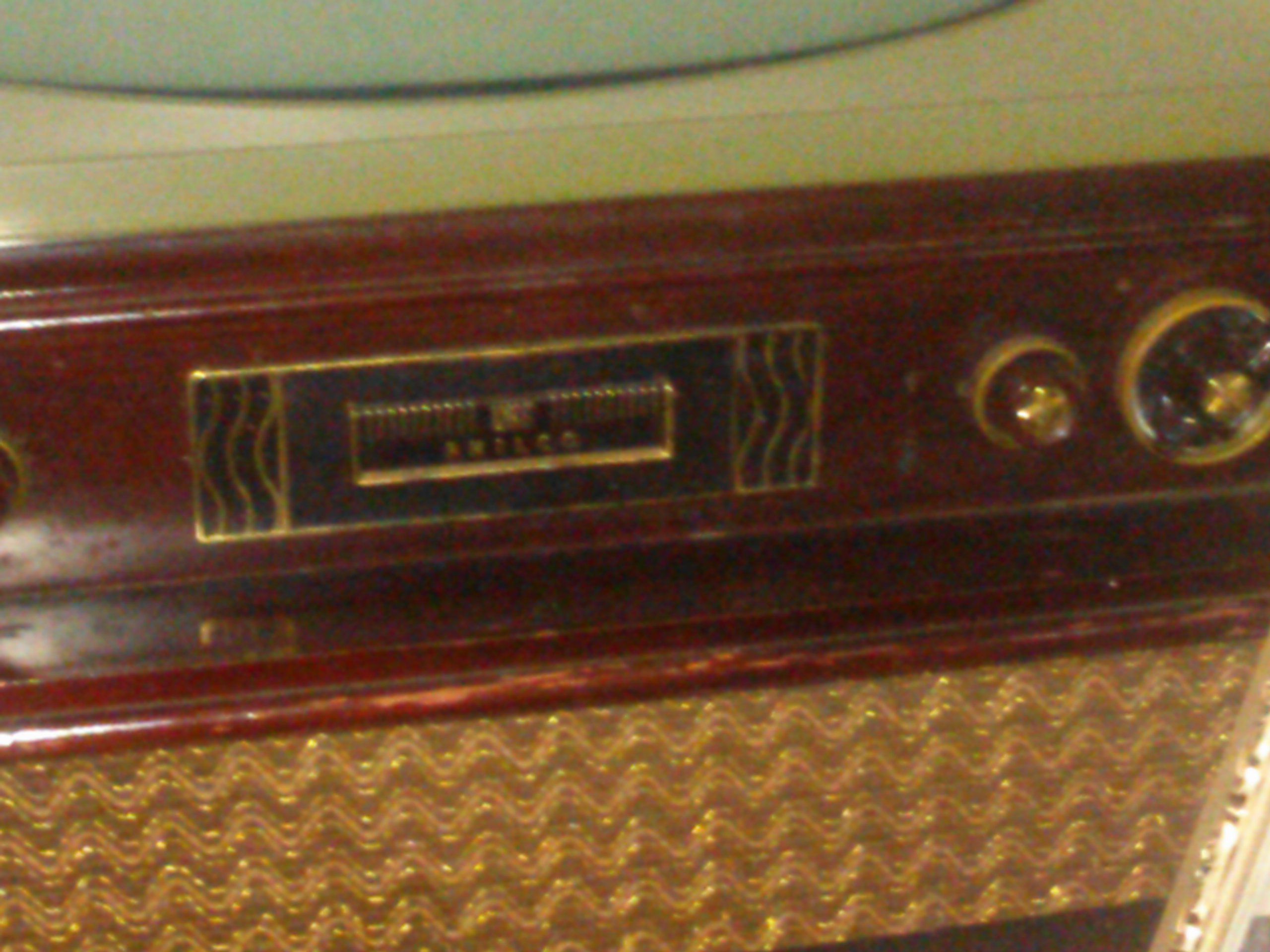

Here is a question that has bugged me since I was a kid: this TV has a 2 through 13 VHF tuner, but a metal plate between the left pair and right pair of control knobs, proclaims UHF. Why? It has no UHF tuner nor, as far as I have ever been able to find, any place for one to plug in.
UHF was an option. At the time, your Philco dealer could have installed a UHF tuner. There is likely an unused socket somewhere on the chassis. This would be where the UHF tuner would have plugged in. As far as the vertical, Philco loved micamold caps. These were just as unreliable as the paper and plastic caps they used.

    Thanks for the info! I will try to attach a pic of that center plaque. (It sits in front of a routed out rectangle.) I am still "rediscovering" the quirks of the set by chatting with my mother and my sister. I do recall that it was given two reprieves: at one point my father wanted to turn the cabinet into a bar; at another point, he was considering making it into an aquarium. Neither idea panned out, so it was never gutted. I also have to chat with my cousins upstate: their parents had a slightly different model. Two differences: different speaker cloth, and there was an empty plastic case behind the UHF panel. (Ours did not swing down.) I know that I've is still in an outbuilding in their farm.
