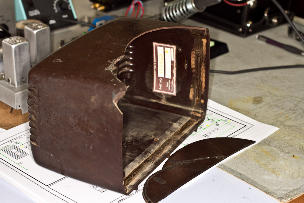

Can anybody give me some pointers on repairing this old Bakelite?? I searched the archives and found a link to a video (from 2006) but it has been removed. I found a good step by step about a year ago but now I can't find it.
Any help would be appreciated since the electronics are almost done (over behind cabinet), so I thought it was time to put together a game plan on cabinet repair. I am okay on wood but never repaired Bakelite but I am familiar with its properties.

Do you guys think this will work?? I have worked with marine fiberglass and resin back in my younger days so I think I can make this work if it will stick to the under cabinet.

I don't want to rain on anyone's parade but there were so many Philco Transitones produced with this same cabinet between 1941 and 1950 that I don't think it's worth spending a lot of time repairing the cabinets for one of these. Even if they are in short supply in your area there is a parade of those things being continuously listed on fleabay. In terms of gluing the chips back in I use two part epoxy, the type that sets in 24 hours not the 5 minute kind. In this case you would have to use some clamps of some kind to hold the pieces in place since they are large. One thing that I would definitely do is clean off any of the old glue residue with lacquer thinner or acetone first from the edges of the pieces.
Well I kinda gotta do up this old dog! It was my Mothers Radio and sat in her kitchen when I was a kid growing up. She passed away couple years ago and I found it boxed up in her attic. Looks like something got dropped on it and she may have tried to fix it with some kind of glue.

I did see a pretty good looking 48-200 (same model) on ebay a couple months ago for $20 and I almost bought it just for the case. I'll use this for plan B if I can't get a good fix with epoxy. If I get a good fix that will hold, I'll document with pics and post here.
