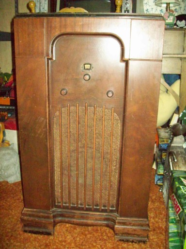

Delco 32 volt console
Found this today at a second hand shop after getting my liscense tags. I rarely see Delco radios and have neve run across an intact 32 volt model before, especially not a console. This crosses over into my antique engine collecting as I knew a guy who had a few of the Delco light plants this radio was made to work with. The only thing I hope is that no-one plugged this into regular AC! Icon_eek
Sparse on tubes, nice lines and form! Icon_biggrin Would the plug even fit into a conventional outlet? Crossing my fingers for you! Icon_thumbup

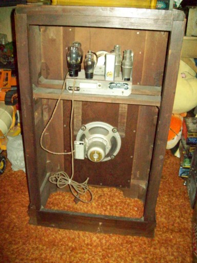

If it is a 32 volt set you may find it a disappointment performance wise given the small number of tubes, 32 volts was the plate and screen voltage as well. It looks like they used two power output tubes, probably 48s, to make up for the low B+ voltage somewhat, normally they would also add extra RF and IF amplifiers to help it out. The only 32 volt set that I saw in person was a post war set from the late 40s, I think it was a Sparton, it was identical to an AC/DC model of the same era other then the wiring and a large label on the back warning that it was a 32 volt only set, yes it had the typical "Hubble style" plug like a normal AC radio would have. By far most rural market sets in Canada used sets of A, B, and sometimes C batteries with the odd one using a 6 volt vibrator supply.

A few months ago I restored a Delco 3201 tombstone (your console may use the same chassis). It had been plugged in and both 48s were toast along with the 85. I got replacement tubes, re-capped it, and fired it up on 24VDC. I was surprised at how sensitive it was. I read people say that these 32V sets are dogs but this thing pulled in stations all over the dial. I tuned in WSM on a Saturday night and listened for a while. I thought about how many times this set was probably tuned to the Grand Ole Opry back when it was originally used.

I checked the continuality on my 48 tubes and they are blown. Seems my set was also plugged into AC sometime during its life. It's also nice to know that 24VDC will run the set. I'm pondering trying to track down one of the old light plants sometime when I get the funds. I knew a guy who had 4-5 of them stored away on his property, but he went through a divorce last year and sold off some stuff. It would be neat to take this radio the engine shows as part of a display.
Jayce, also check the transformers and other coils. This set might be prime for a "static" display and not worth the cost to get it back and running. I'm surprised that 24V would allow that to perform well but what do I know? Icon_crazy The one I was looking at had 4 of the output tubes in parallel push pull. Just that made it for me not worth the money as I like my radios to work. There is a nice picture of the model I was looking at on Radio Attic and the picture was posted by a member of the alternate forum. He had a nice picture of the radio and a 32V powersupply he had made to run the radio and fitted nicely into the table top cabinet. If the radio had not seen the nice 120V voltage, I would have gone for it. Four output tubes gone and guessing another and at least a transformer, seemed a little pricey. Best of luck on the radio, it's nice looking.

I sprung for the cost of the tubes in mine because I got the radio for free. I help a buddy of mine who flips radios on ebay with fixing ones he can't figure out. He pulled this one out and before he even told me what was wrong with the radio I told him what his problem was. He was so disgusted that he didn't notice it was a 32V radio that he told me I could have it. Even though he plugged it in to 120V I don't think he was the first to do so.

I think this radio might be worth rebuilding as even my radio repair friend was surprised to hear it was a console. He's worked on several of these sets, even with the same chassis and has never seen a console version before. And yes, he said about 90% of the Delcos he has worked on have been plugged into 120, so he knows what to expect. I was trying to figure out how they developed the 'B' voltage as that is sometimes an issue on a battery set, but this set is pure genius! Instead of using a complicated set-up to get really high voltage, it appears that they just simply used the 32 volts available for the 'B' voltages. That explains the simplicity under the chassis. I like these critters! Icon_smile
