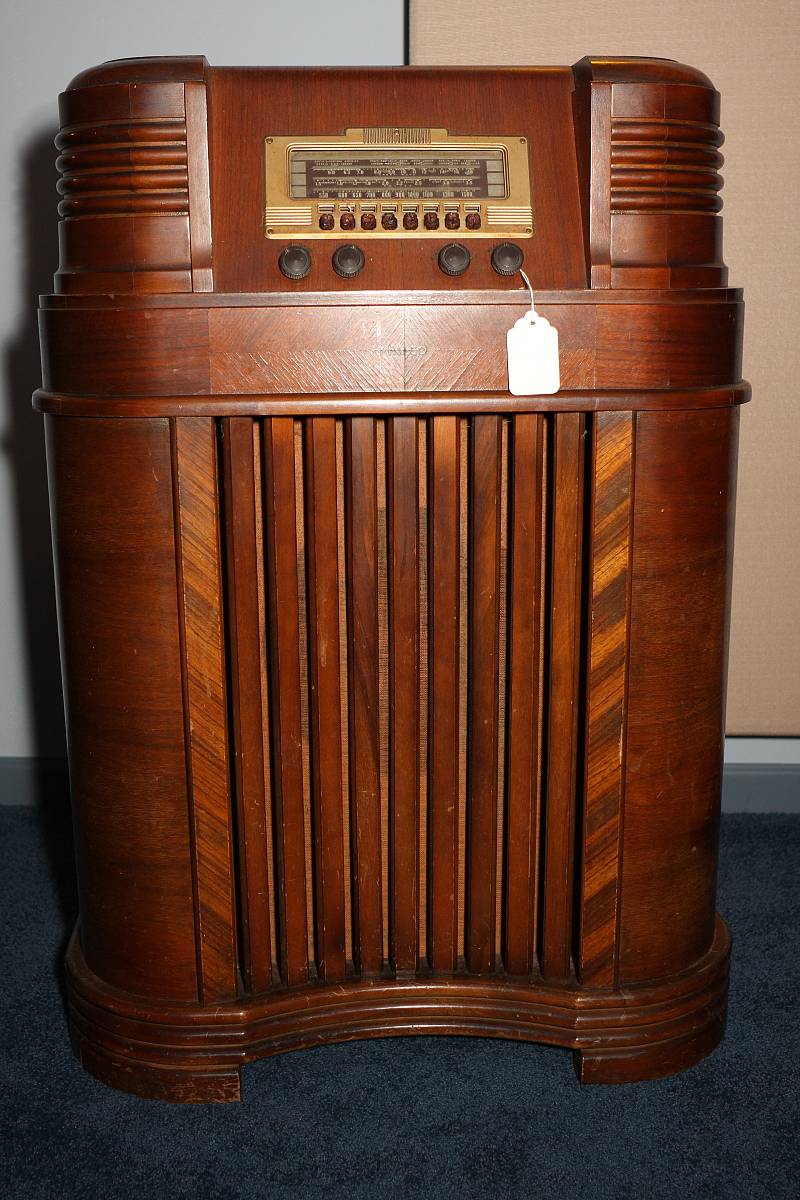

Yesterday, my wife and I were at the local antique place when we discovered a nice looking old radio. Within minutes, the vendor had kicked the price down to $70 and I said "SOLD!" I spent the evening surfing the web and found this great site.

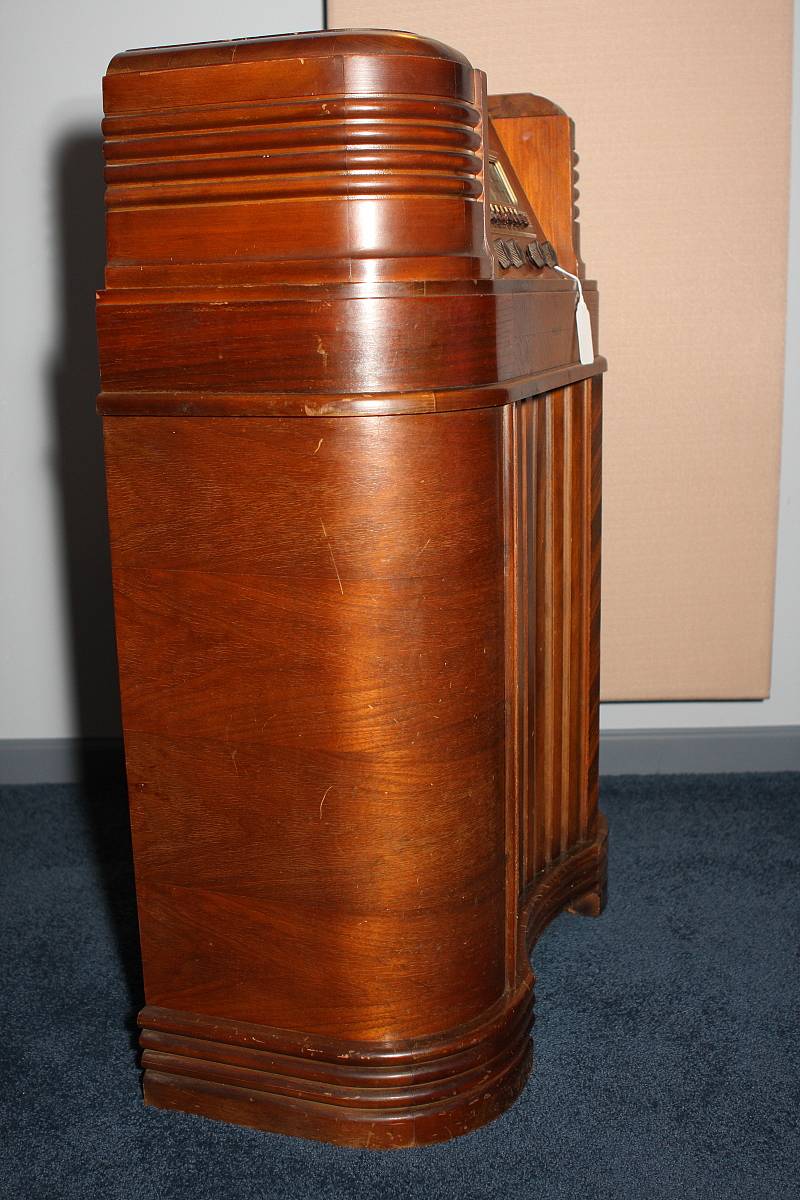

I have attached a few images of the console. The chassis appears to be in decent shape, but has received some recent work as it has a new power cord on it. I have not removed it from the console for further inspection.
My goal is to return it to its original glory. I would like for the console to look like new and for the radio to play nicely. I have found a few references on restoration including "Radio Cabinet Restoration" by Joe Koester and "Basic Wood Radio Cabinet Refinishing" by Eric Stenberg and a few other references. I also see that replacement tuning buttons and lettering are also available.

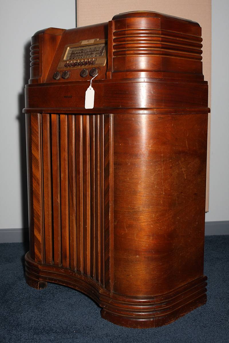

The console looks to be in decent shape. The flash has brought out some of the original color and shine, though to my eyes the console looks rather dull and lifeless with normal room lighting. There are tons of little marks and scrapes on the sides and bottom. There doesn't appear to be any major gouges. The wood and veneer all appear to be sound and secure.
So, where do I start? I'm no stranger to electronics or wood working. Does this console need a full strip and refinish? Or is there a way to "patch" the splotches?
Any insights would be appreciated!
Eric
No, strip not needed. An artist's touch and a little polish should be right enough. Gotta be a kid around somewhere if you cannot find that old oil painting set that you know you have somewhere.......
That cabinet is in really great condition. It really needs little more than cleaning with the cream gojo stuff and then some work with something like Howards, the scratches will just go away. Very nice looking set.
Welcome to the Phorum a lot of help here and you may need that for the chassis restoration. That cabinet in a couple hours will look like new.

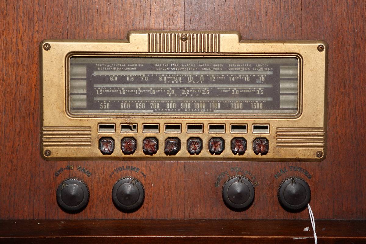

Welcome to the forum! You've found the best antique radio forum on the net, so you are starting off right! These guys will steer you right. If that radio was mine, I'd be ordering some new push buttons. I think radiodaze sells some like you need..

Radio Daze is definitely the place to get your reproduction decals. These should be the one's you need for above the knobs: http://www.radiodaze.com/product/6039.aspx
And this should be the sheet of decals you need for the PHILCO name: http://www.radiodaze.com/product/6046.aspx
Radio Daze also should have the wine colored pushbuttons here:
http://www.radiodaze.com/product/1075.aspx
Keep in mind you'll need to order 8 buttons.

I would try giving the cabinet a cleaning with a cream hand cleaner like GoJo just to see what you have, after that then you can make a judgement about what to do next. However it looks to me like the lacquer is starting to detach itself from the wood in places like on the side, those white and yellowish spots and cracking are evidence of that. One the lacquer get like that it means that it's pretty much done, no amount of magic liquid in a bottle will fix it, in fact using some products, like wax, will soak into the wood and may make it more difficult to refinish in future.

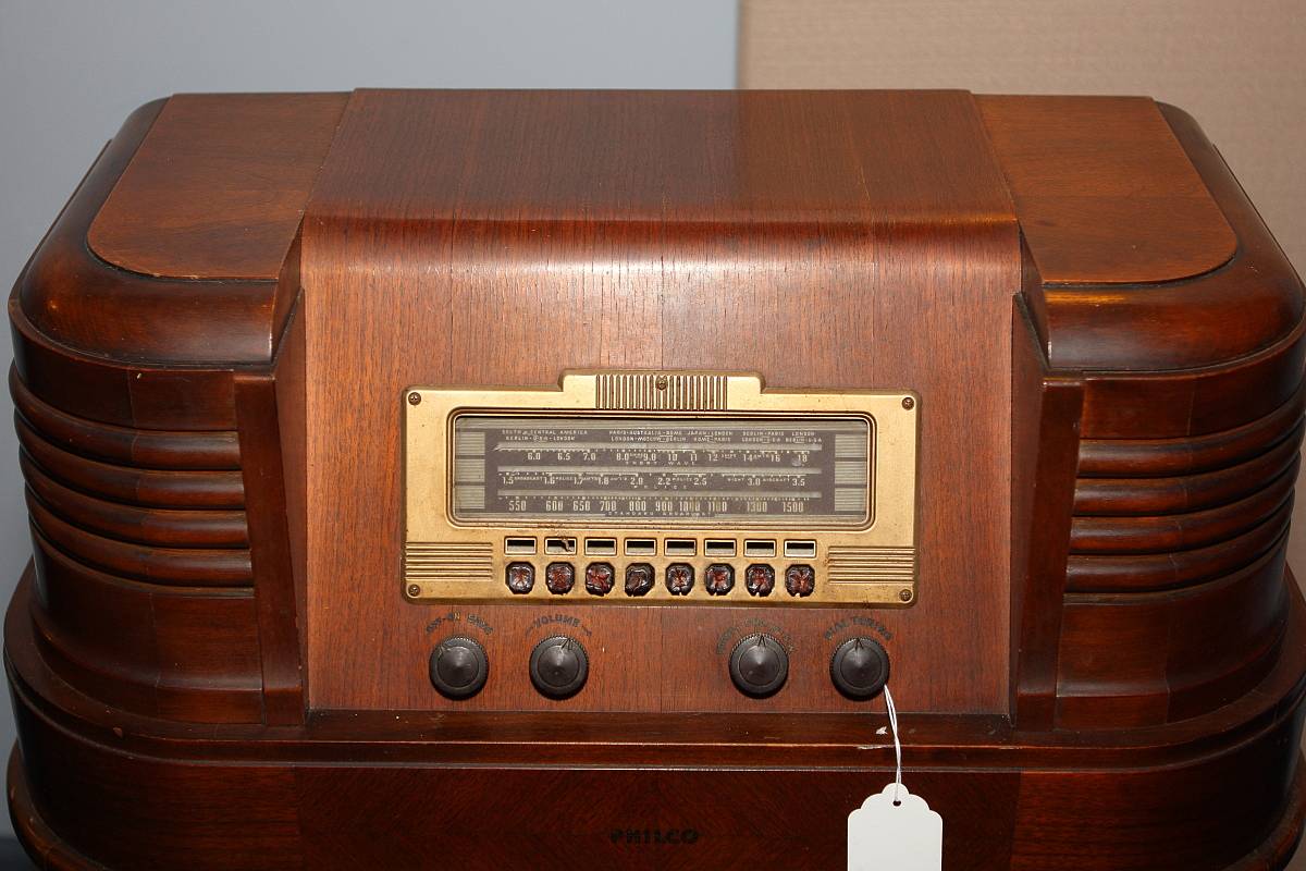

Hmmm... Here are two closeups of the finish. The first images is about 2.5M and the second one is about 1.6M
The finish on the front appears cracked and peeling. I will have to look again more closely, but this appears to be the only cracked part of the finish.
The spots on the side appear to be a combination of light scrapes and splashes and drips that sat for too long.
Most of my woodworking experience is relatively basic stuff like building and finishing speaker cabinets. I have no experience when it comes to resurrecting old furniture.
Does the cracking finish in the first image necessitate stripping down to the bare wood?

I've had good success using Howard's Restore-A-Finish on cabinets like yours. The question is whether it will repair the cracking in your finish. In my experience, the odds are 50-50. Sometimes it works, other times it doesn't. It's worth a try and it won't hurt anything. If you try it, use some #0000 steel wool with it on the tough spots. Most antique malls sell Howards.
I would say yes; Goop & Gojo are basically the same kind of hand cleaner. Look for the kind WITHOUT pumice, as you just want to dissolve the dirt and grime on the cabinet. As for the decals, if you won't be stripping the cabinet, yes you could just put the new decals over the old one's. Since Radio Daze fixed them, they should be an exact match. I've done that to some of my sets. Now to preserve them from flaking off you will want to spray some clear coat over them. Just a very light coat over the decal area should do it.
Personally, and others may disagree, I wouldn't let the cracking finish in the first image necessitate stripping down to the bare wood. That's where the Minwax trick I mentioned previously has worked well for me in the past... it fills in those cracks with a stain again. It's a big job stripping and refinishing a console radio cabinet, no doubt about it, and I only like to do it if the finish on the cabinet is so far gone that it's the only solution. That would mean deep gouges, deep scratches, missing patches of veneer, badly worn areas of the cabinet, etc. From what I see on your set, it's far from that bad. But, as I said, others may disagree. But regardless of who says what, it all boils down to personal preference. Can you live with a bit of age-related patina, or do you want it to look pristine and (even better than) factory new? Many, myself included, prefer to try to salvage an original finish if at all possible. Others believe in stripping it all and starting from scratch. There is no right or wrong answer.

Thank you for all of the opinions! I REALLY appreciate all of you thoughtful wisdom and advice! I had some goop in the house, so I gathered a few old rags and went to work.
One hour later and W*O*W !!!!! I found about 99% of the original finish hiding under a ton of grime! Many of the lighter spots have been removed or filled in with the dirt that the goop loosened. There are a few places where it looks like whatever liquid was spilled on the cabinet has eaten into the lacquer finish, but you can really only see it if the light reflects in just the right way.
The surface shows lots of little cracks and a fair amount of roughness, perhaps I'll explore adding a top coat, but for now, I'm EXTREMELY pleased! I will post a few pictures tomorrow.
What a beauty! I would have happily paid much more had I known what was hiding under 73 years of grime!
