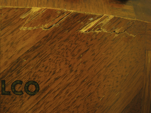

Now that my 40-190 is playing well, it is time to turn to cosmetic issues. Although the case is overall good shape, there are some missing chips of veneer (see photos). These, and some scratches on top, were caused by my cats jumping on it. So: is repairing this kind of damage something I can do myself, or would it be best to find a professional furniture restorer? If it is a do-it-yourself project, how do I get started? Thanks for any help - Roy

Small chips came off and I glued them back, but there are tiny slivers still missing. I will try to take a better picture with a real camera toniht, rather than my phone, so you can see what the veneer looks likes.

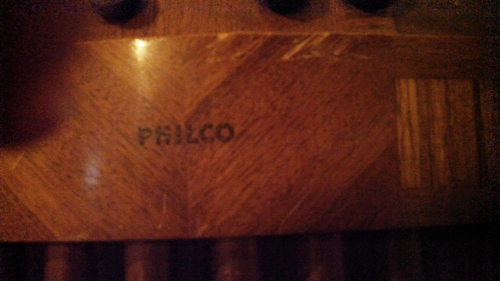

To repair that you will need to figure out what species of veneer it is. Contrary to what some may think they did use more then walnut, and they used more then one species and cut of walnut to get the look they wanted. The species of veneer used on that band was some form of mahogany I think, but it's hard to know for sure with the original finish still on it, it may also be Asia wood or Australian (Queensland) walnut, one problem you may have with patching it is that it was cut on the diagonal and book matched with the other side. The last one is a tropical tree and isn't really a walnut species at all. The vertical grained veneer next to that section is zebrano or zebra wood, it has alternating dark and light bands.

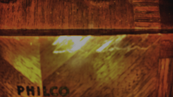

Here is a better picture of the damage. it is small and I don't want to make it worse with an amateurish repair. - Roy
I would use some artrist's oils (often you can scrounge a set of them for little or nothing) to fill the chipped areas with a very fine artist's bruch or "spotting" bruch from the old days, then a few coats of shellac as needed to overfill, and a very gentle buffing and paste wax.
Shellac sticks and touchup crayons were often used for delivery screwups too, but not so great long term.
I don't think you can make it worse. It all depends on what you can live with. No matter what you do, the repair will be somewhat visible. I sent some veneer, but it may be darker than you need. I like codefox's idea. The method I have used is to take a piece of paper and a pencil and make an etching, then cut veneer to fit. Fill in the area as best as I can with some veneer, trying to match the missing places. Glue it in. If it's not level, I lightly sand the new veneer. Then I smear some Timber Mate colored wood filler over it and wipe off the excess. After that, I spray some toner or clear lacquer over the spot.

It looks like quarter saw French walnut veneer to me, but cut on the diagonal, you should be able to find a chunk of the same type of veneer that closely matches the grain and colour, it won't be exact but probably good enough. I think you could probably cut a straight sided patch with the sides parallel to the grain.
Promised update, with photos to follow soon. The cherry Restore-a-Finish did a great job hiding the numerous scratches. I patched in as best as I could with the pieces of veneer "PuhPow" kindly sent me. I then filled in the gaps with walnut TimberMate and blended it all with the Howard's. Much improved! You can still see the damage if you look closely, but it is much less obvious. The radio now sits proudly in my living room; it is a beautiful piece!
