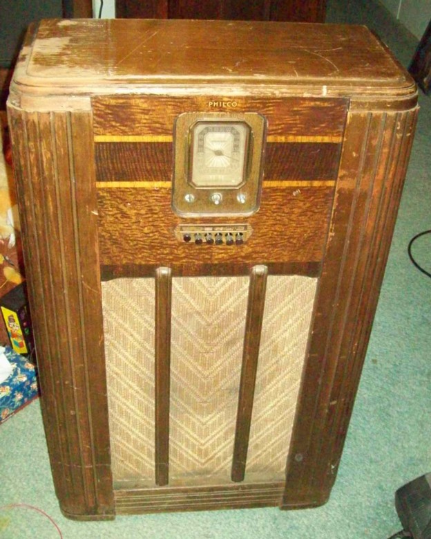

Here it is, a true Philco produced mutt of a console radio. The 1939 Philco 17!

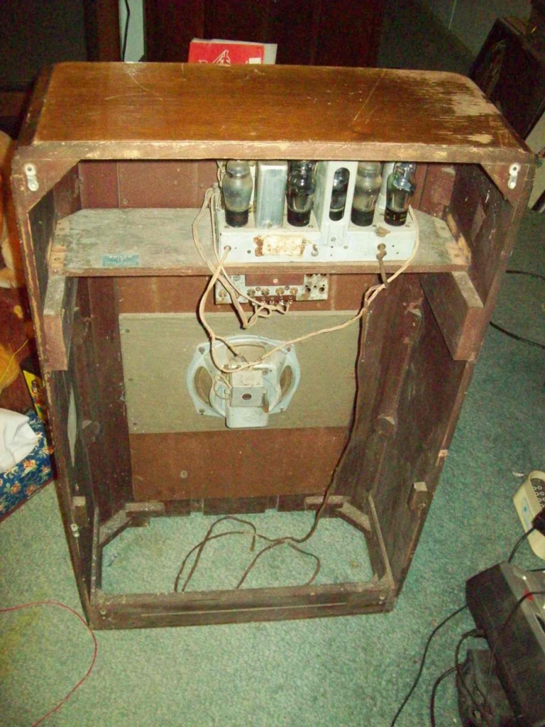

That chassis is a lot smaller than I expected. Should be a cinch to go through that one! Icon_thumbup That's not the original speaker, is it? Also, does it look like that grille cloth will clean up ok? I like the curved ribs a lot! Interesting radio!
Yup, looks just like a 38-17F console, with the addition of those pushbuttons. The 38-17F used an identical-looking speaker - probably the very same speaker type.
Jayce, now I need to see some detailed under-chassis photos showing where those wires running to the pushbutton assembly connect inside the chassis. Some detailed photos of the pushbutton assembly itself would also help. I'm hoping that with good photos, I might be able to draw a schematic for this mutt. Feel free to send them to me direct - I'll PM you with my direct email address.
That looks like a very fun radio to restore. It will sure be a sharp looker when you get it finished!

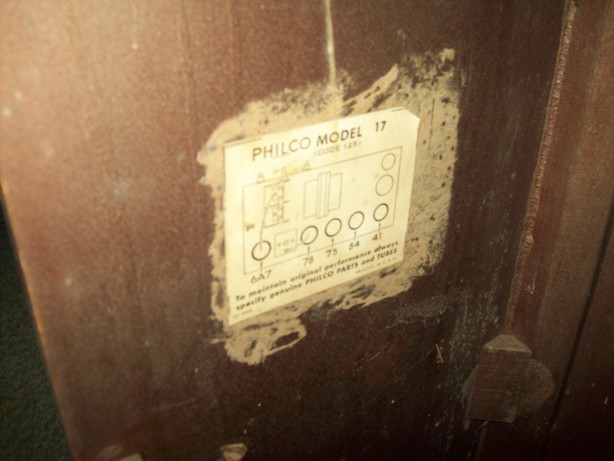

Ron, when I look under Nostalgiaair, I don't see anything for a 38-17 anything, nor a 37-17.. And when looking under a Philco 17, I can't tell from the Schematic, whether it had push buttons.. So, this may truely be a "Mystery Set" or Mutt.. Only You can tell us for sure..
THANK YOU marty
I already stated in another thread, that the "17" Jayce now owns is an undocumented "mutt."
http://philcoradio.com/phorum/showthread.php?tid=7393
And to make matters worse, Philco never issued a Service Bulletin for the 38-17. You had to use the Bulletin for the very similar 38-15.
Also, do not confuse this with the 1933-34 Philco model 17...an 11-tube chassis that was made in cathedral, console and chairside versions.
Not to mention the Canadian Philco 17 from 1940, which looks like a USA Philco 40-155...

Here is what I have found so far:
I feel this "mutt" used the 39-85 pushbutton assembly. It definitely used the same bezel as the 39-85 pushbutton assembly. Only where the '85 had two of those mica caps insulated only with wax mounted in the pushbutton assembly, Jayce's radio has the mica caps inside the radio chassis, near the band switch. I haven't gone this far yet, but the mutt "17" may even use the 39-85 band switch. Jayce told me his "17" has a three position band switch, which makes sense - pushbutton, AM, and SW.
