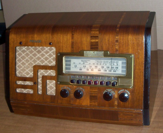

Nice Job! Look lke an eastern set, most of those stations I can get over here. WCAU is WPHT now as of 10 or so years ago. I don't understand why stations change call signs after many many years. Kinda like us hams the FCC has allowed us the to have call signs which don't necessarily have to be in the call district we are in. It's a bit of annoyance you think the guy is in Calf. but he's next door.

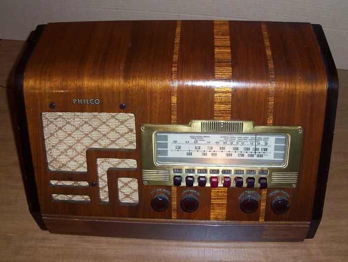

Beautiful radio. Great job!

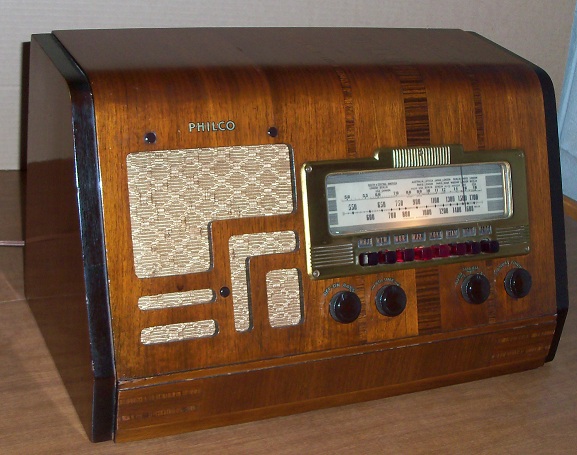

Real nice looking set--great restoration !

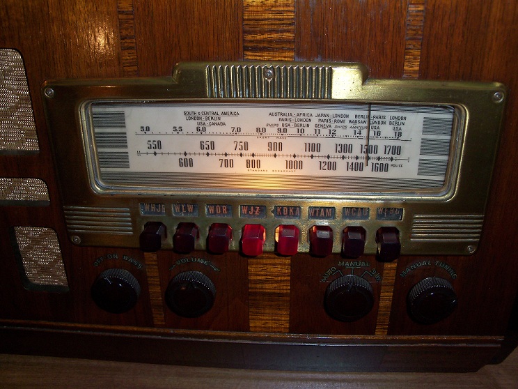

I really like the rear lighted dial on these 1939's. And, using the "Rebuilding Philco Pilot Lamps" tip found in the tech section ( http://philcoradio.com/tech/lamps.htm ) it no longer flickers on and off!
