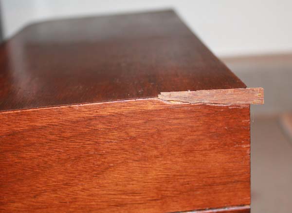

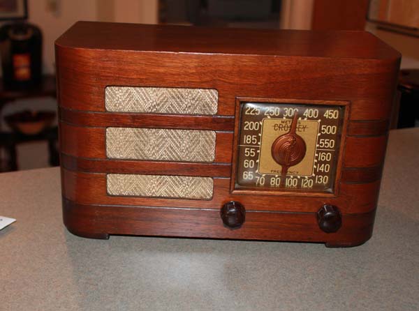

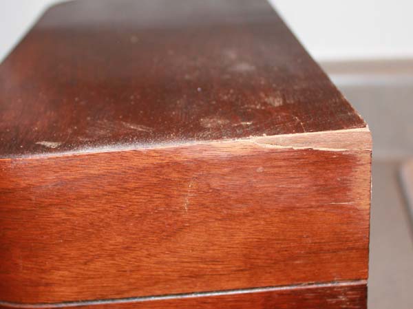

Veneer repair seems to be a frequent topic here, so I thought I'd show you how I do it. I've got this little Crosley that's been needing finished up. It has very typical veneer damage.
Here you see it... I've already gone over the cabinet with Howard's Restore. It really cleaned up nice... Now on to the repairs..

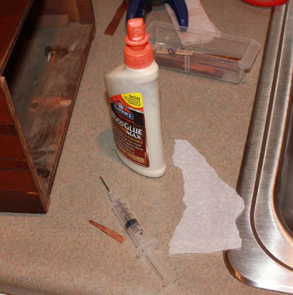

Here are the supplies we will use.
400 grit sandpaper
Needle and Syringe
Wood Glue
Wax Paper
Clamps
Med Walnut Toner and Clear Lacquer (Mohawk Brand)
Dremel with cutting wheel..

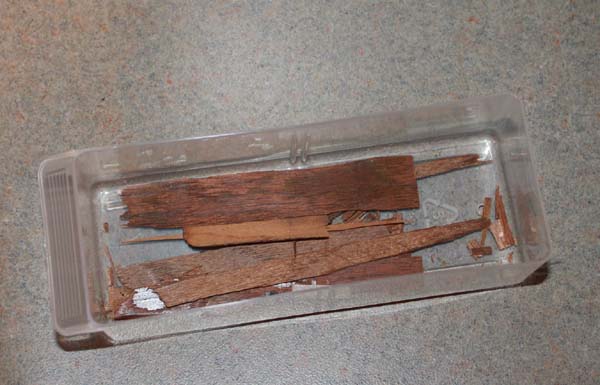

...and my supply of scrap veneer.

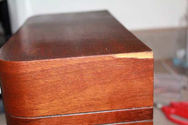

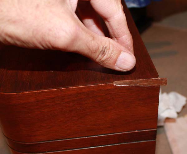

On the first picture, I am test fitting my veneer piece. When you have a bunch of scrap pieces, there is usually always one edge that fits your needs. Don't worry about color too much. It needs to be close, but not perfect. Same with the fit.

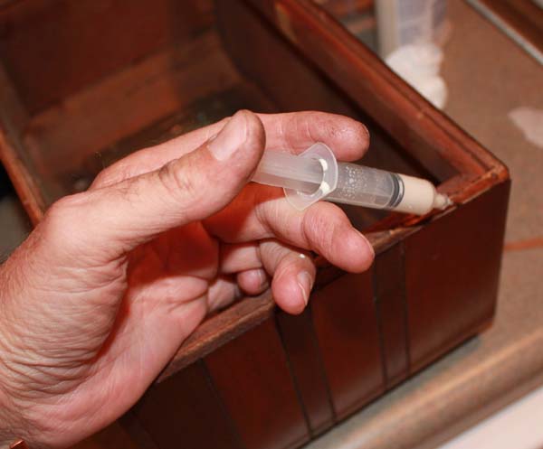

Second photo, this cabinet has a chip in the veneer, but it also has loose veneer on the other side. I am injecting wood glue under this loose veneer. You don't need much glue. Keep a wet paper towel handy to wipe up the excess that squeezes out the side.
The final photo shows the chipped area with the new piece glued in place.

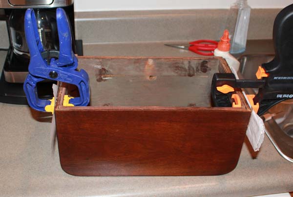

Here I have clamped both sides. I use a stick of wood to spread out the pressure. A paint mixer stick is perfect, just cover it with wax paper so it doesn't stick to any excess glue. Those clamps are cheapo plastic clamps. I think I paid $5 for one and $10 for the big one. They come in handy.
You should leave it clamped overnight. These were small repairs, so I left it for four hours.

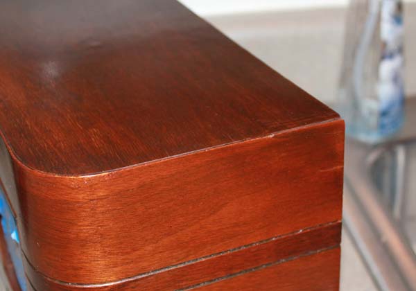

The first photo shows the veneer when the clamp was removed. You can see it isn't a perfect fit. It's close enough for government work, so it's good enough for me..

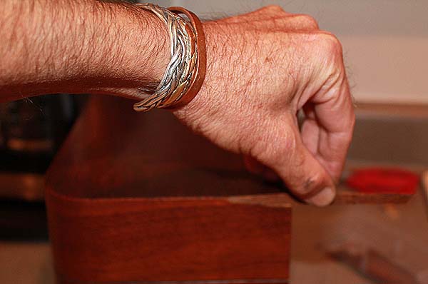

The second photo shows the veneer after I trimmed and sanded it. I like to use a dremel with a cutting wheel to snip off the edges. I try to get pretty close. Then I finish it up with 400 grit sandpaper. If you don't have a dremel, use an exacto knife. Score the veneer deeply, then snap it off.
Once the edges are nice and even, I go to work on the surface. The idea is to sand the new veneer down until your sandpaper starts hitting the cabinet. Use a little sanding block. Anything will work, as long as it's perfectly flat. I use a metal ruler with sandpaper taped around one end. You want to get everything nice and flat.
(This post was last modified: 09-17-2013, 03:37 PM by Jamie.)

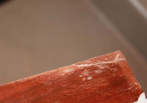

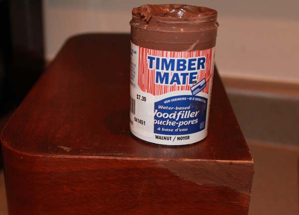

Time for wood filler. I can't say enough good things about Timbermate. I've tried every wood filler under the sun. NONE of them work like this stuff. It's the first wood filler I've used that you cannot see when you are finished. It's good stuff.
First photo shows the veneer with a little Timbermate smeared on.
Second photo shows the filler after sanding. The idea is to sand off all of the filler, only leaving the cracks full. 400 grit and a sanding block were used.

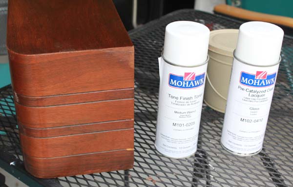

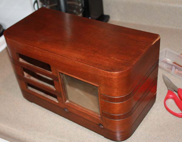

It's toner time! .. Mohawk Medium Walnut was chosen. I tested some dark walnut and it was too dark.
Second photo shows the repaired area after being sprayed with toner. I try to use enough toner to hide the repair, but still leave the wood grain visible. It takes a little finesse, but it's not too hard.

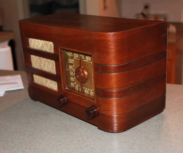

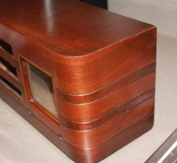

Here is a better shot of cabinet. I panned out to show how well it all blends in. Is it perfect? Nope. I'm not a professional, nor am I an expert. I think it looks pretty good though.
Now I'm going to spray a little clear lacquer over the repair and it will be finished.

All done!
I steal veneer off of a Philco 42-1206 console cabinet. It was a typical Craigslist find... cabinet was water damaged and destroyed. No way to save it and no one would ever want it... except me. I got it for $10. Each time I need veneer, I go peel some off of it. Wayyy cheaper than buying new veneer. Great for small repairs.
Next time you are at a garage sale, flea market, etc... look for an old table or cabinet with really bad peeling veneer damage. You can pick up something like that for $5. Then you'll have a supply for your radios.

Thanks for sharing your methods! How much effort do you spend to match the color of the wood filler to the specific cabinet you are working on? Do you have 4 or 5 cans of wood filler laying around, or does this not matter so much since it gets covered with grain filler and/or toner before lacquer?
Posts: 761
Joined: Jul 2013
City: Kentucky
I've only got one color - walnut. The Woodcraft store is about 50 miles from our home. When I was out there, the salesman was raving about Timber Mate and talked me into trying it. They had just begun carrying the product. I only bought the one color. So far, I haven't needed anything different. I've used it on about 6 radios.
I don't think it matters much. I've tried all the minwax, elmers, etc.. and they just don't compare. Plus, Timber Mate cleans up with water, so if you accidentally get some where it shouldn't be, it's no problem. One time I accidentally smeared some Elmers on a cabinet, and it was a bear to get off.
