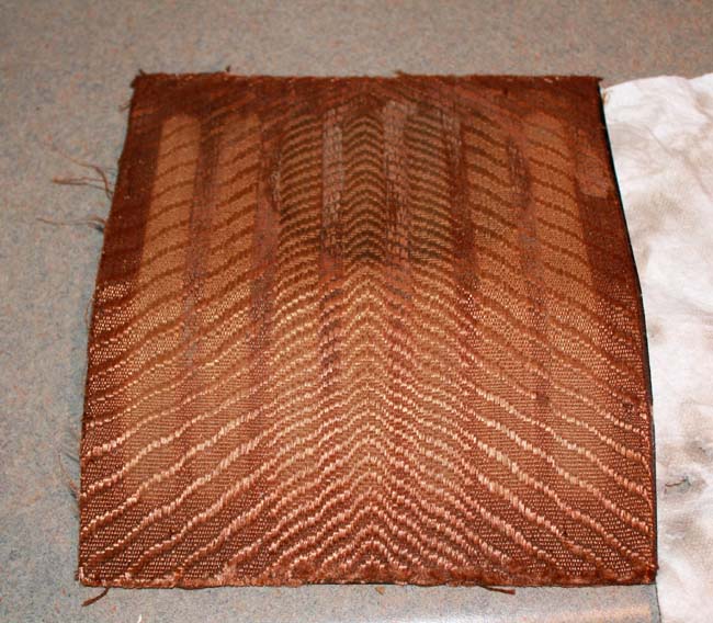

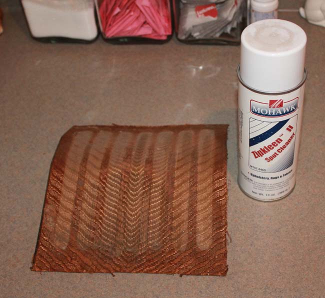

As you all know, I've been working on an old GE radio. The radio and the grill cloth were filthy. Mud, dirt, grease.. you name it. Seventy-five years of accumulated crude. When I removed the grill cloth, I could see that it was in decent shape, fabric wise. No holes, no thin spots, no snags... but very, very, dirty. I picked out new cloth and planned to replace it.

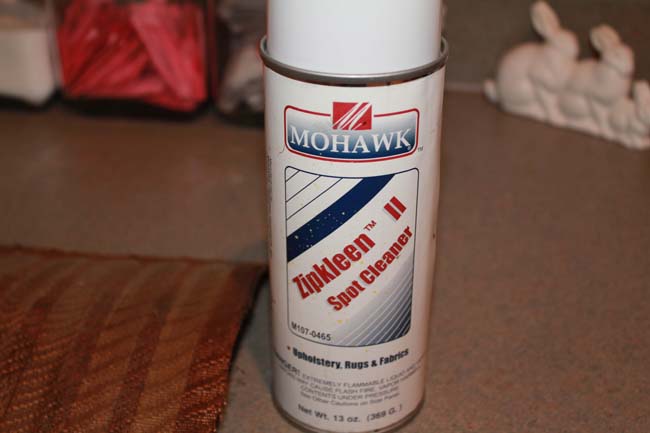

The other day I was at the refinishing store, and I noticed a product made by Mohawk, called ZipKleen II. It's labeled as an upholstery, Rug and Fabric cleaner. I love Mohawk products, so today, I drove back over there and bought some.

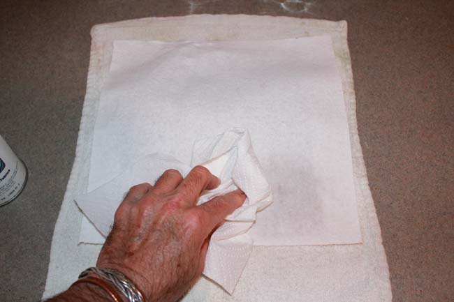

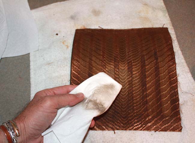

The instructions say to cover the fabric with a terrycloth rag or paper towel, and spray. Tamp with a sponge or cloth to remove the spot.
Well, as you can see, I tried that. It didn't work out so well.

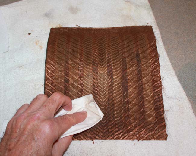

Time to get more aggressive! 8) I sprayed the product directly onto the grill cloth, then rubbed it with a paper towel. I used medium pressure, and I cleaned in the direction of the grain of the cloth. As you can see, dirt began to come off.

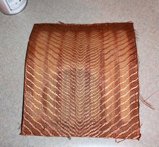

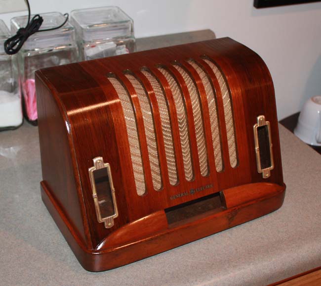

Here are the final results. Pretty amazing if you ask me. I worked around the entire cloth, doing 3 inch sections at one time. It took me about 30 minutes, and I had to go over it several times, before the cleaning cloth showed no dirt. It won't repair faded or torn cloth, but it will clean the heck out of it. I used Scott's "Rag's" paper towels. I can now use this grill cloth in the radio.
Mohawk ZipKleen II isn't cheap. I paid $17 for the can. I used about 10% of the contents. Considering the cost of new grill cloth, it's a bargain. The can says "Removes tar, grease, oil, adhesive tape, gum, etc., from the finest of fabrics".
I give it a thumbs up.

Just to illustrate the difference. Top photo is what it looked like before. Bottom is after using ZipKleen. It's a good product. Original grill cloth can make or break a set...
