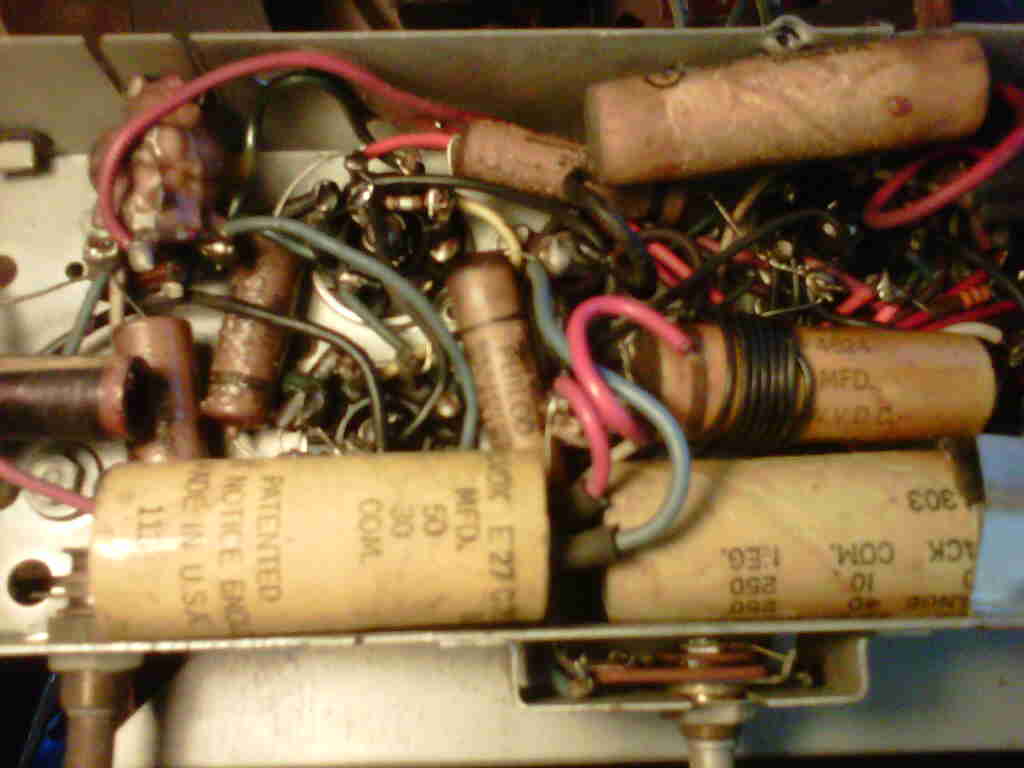

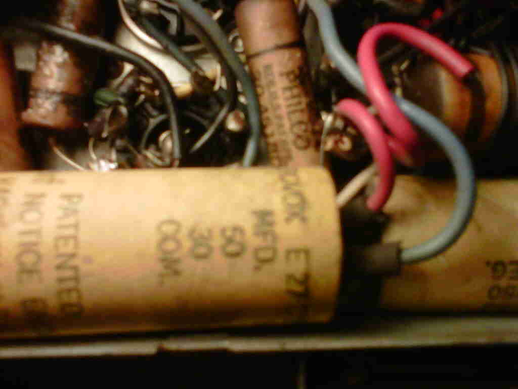

My first area to repair is the radio which has a lound hum. I opened the unit and, focusing on input power section first, I noticed the following issue:
C14 to have red and blue wire on one end and black wire on the other. The red wire does not appear connected, just coiled up laying there.
Question: is this a broken wire or an extra wire?

Jeff, welcome to the Phorum!! From the schematic it looks like C14 should be a single electrolytic (15mF) but C19 has two caps , 40 and 10 mF. Its possible your cap is a replacement where only one leg was used or it's the original C19 where one of the caps failed, the lead was cut and another electrolytic is tacked into the circuit elsewhere. If you order the schematic from Chuck Schwark , Philcorepairbench.com there will be more info than the schematic from Nostalgia Air. Others with specific experience with this model may have other thoughts.

Thank you for the response. I ordered the schmetics from Chuck today and will attempt to upload a photo of the radio. It is the large cap in the lower left. Its location is consistant with chassis/component diagram for C14. However I understand what you are saying about being a replacement.

Looks like a replacement to me as there is no 50-30 mF cap in the schematic. You need to change out all the electrolytic and paper caps anyway. Check where it's connected to for confirmation it's C14. Replace out of tolerance resistors as you go as well.
