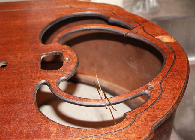

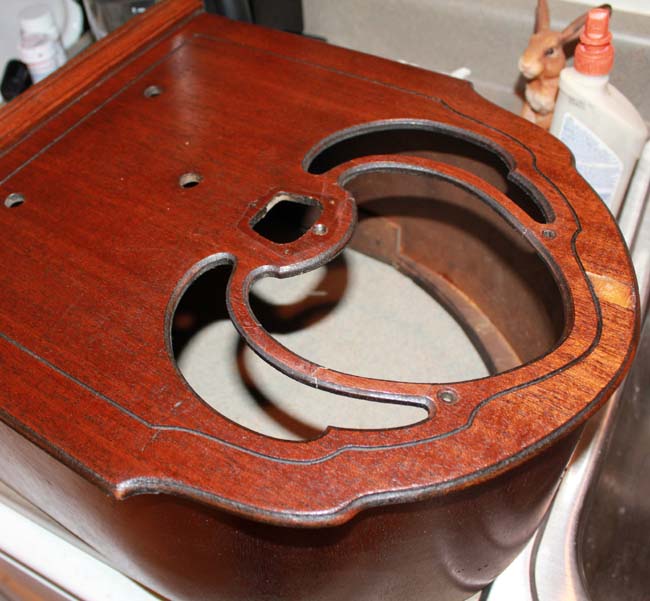

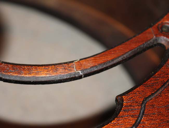

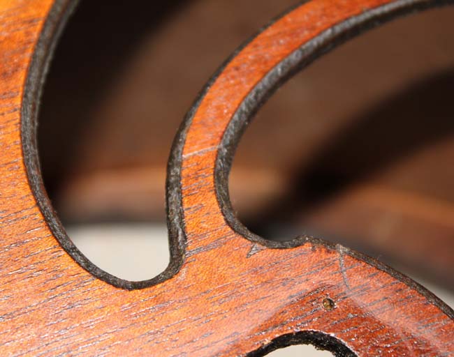

There are about 5 or 6 old breaks in the scrolling. The veneer is very loose, and the backing ply has broken off. The entire face of this cabinet is extremely fragile and weak. I think someone might have tried to repair this previously.

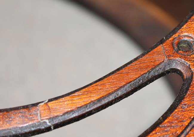

The main problem I faced was that the scrollwork bowed outward about 1/4". It would really be noticeable with grill cloth behind it. It needs to be as flat as possible. I tried pressing it down and gluing it, but that wasn't going to work. It kept popping back up. I decided to, very gently, re-break all the pieces. I then removed a sliver from each piece by lightly running it across 220 sandpaper . I couldn't photograph while doing this. The idea was to just remove the tiniest bit of wood. Too much removed, and the grill would not fit back together. It involved, sanding, test fitting, sanding, and fitting some more.

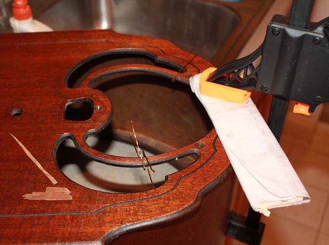

Once happy with the fit, I used wood glue and bent bobby pins to clamp it all together. Sometimes you gotta get creative, the entire thing is like a house of cards.. and a regular clamp won't work.
While I was fixing the scrollwork, I noticed that the top of the front face of the cabinet had become detached from the arch of the cabinet body. We also have a big chunk of veneer that's missing. Time to kill two birds with one stone. I cut a piece of veneer and glued it in place.. then I used a syringe to inject wood glue into the joint where the face of cabinet meets the arch. One big clamp holds it all together. There is also a piece of wood covered with wax paper that keeps the clamp from sticking to the cabinet.

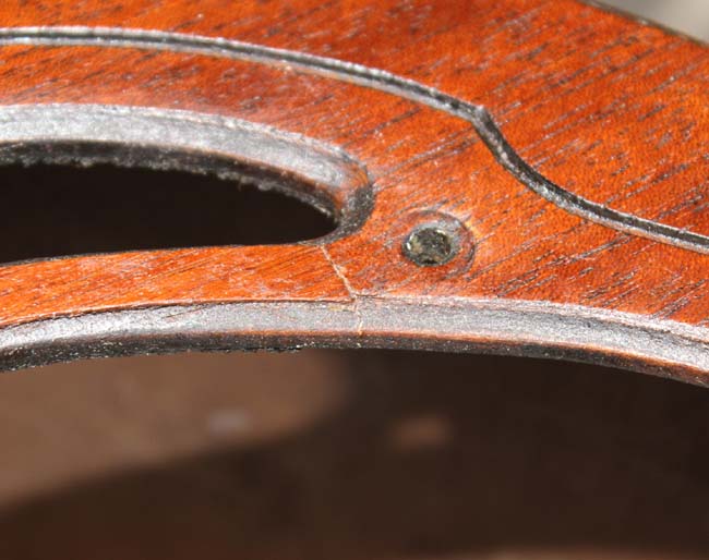

Actually, I got very lucky here. Whoever did the previous repair, they did an excellent job. All of the parts are there and they all fit well. They used the right amount of glue too, which is important. I think the cabinet sustained additional damage in shipping. Shippers always destroy the grills because of the weight of the speaker. If you ever ship a radio, be sure to support the speaker.

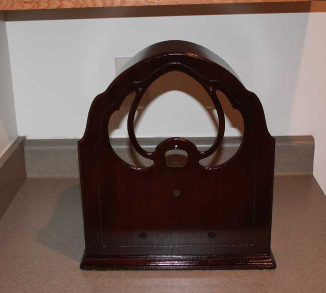

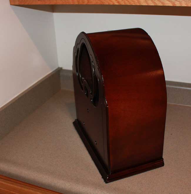

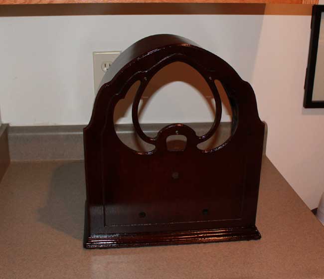

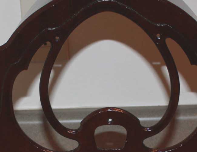

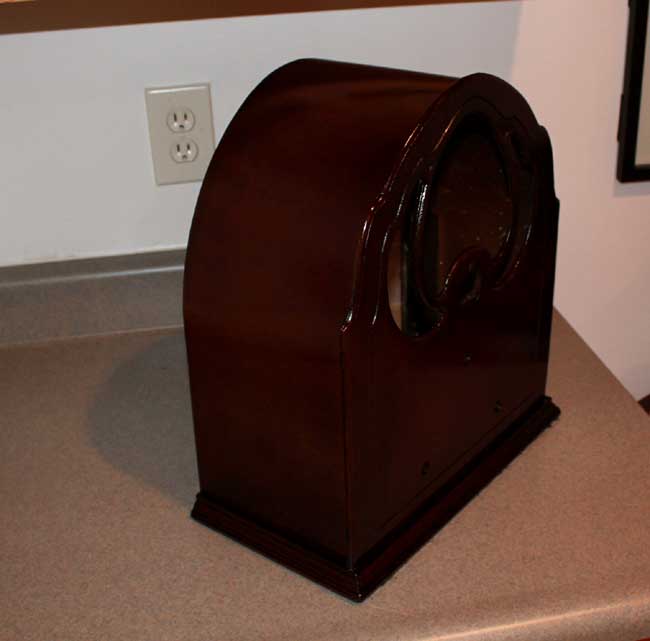

I'd almost forgotten about this thread. The weather finally broke and I was able to finish up this cabinet. The camera makes it appear darker than it really is. In real life, the wood is visible. The big problem is that on this cabinet, the veneer is so thin, it is like tissue paper. It really limits the ability to hide repairs... I decided to go with some shading to help hide the veneer and scroll repairs. So there is a mixture of univeral walnut and dark walnut on the edges. The repairs are almost invisible now.
I think it came out pretty good. It was the best I could do.
