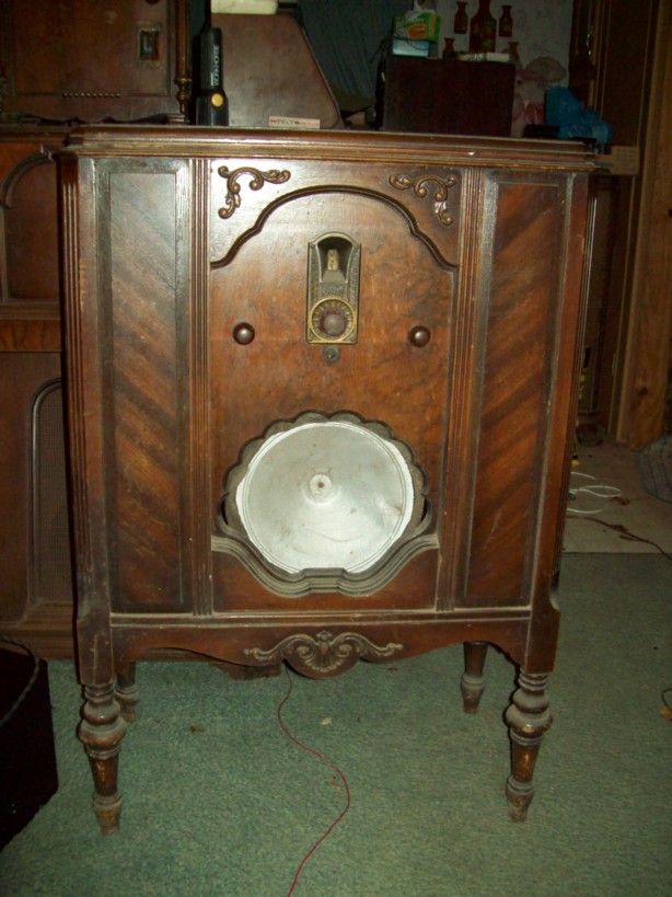

I've walked past this radio several times the past few years. It was sitting in a musty back room with several other old radios that need help, but aren't getting it and since I already have an 87 high boy, I really didn't think of this radio until today when I looked at it again. It had no mounting bolts for the chassis or speaker the grill or grill cloth was missing and it had no knobs until I found the dial knob laying on the floor. Also, the 45s and two 26s were gone off the chassis, but I saw the beginnings of complete 87 lowboy and made an offer on the set. So, it is now at my place awaiting further repair and parts. I had the other two knobs and a good pair of 45s, so that is a start.

Got to do a little tinkering on the 87 tonight at my friend's place and have some good news. We got a bit of life out of the radio and have good signs that all of the 'heavy iron' as he calls the transformers and such are ok. I actually found a faint date written on the speaker cone of 6-18-29. That is cool, but now that probably means I will have to try and find one of the intricate grill inserts to complete this radio.

I checked the cabinet for any clues as to when it might have been made. No dates, but I did find a stamp made into the wood claiming it was made at Philco Furniture, Plant 2. Not sure if that helps, but it is neat. With things already underway on this radio, I definitely need to locate a grill. I can see something was attatched behnd the main opening with wood screws and I can make out a faint square outline in the wood from where it was at.

The 87 is back together and working again. It was a bit weak in my home until I did some swapping of the 26 tubes between it and a couple other radios I don't use often, but it might still need a tweak or two. Biggest issue is I still lack a working tube tester and will be putting the possible repair of mine front and center soon. Sadly, it never did seem to like type 26 tubes. A big thanks to Chuck as the packet I received came in time to help out with both the lowboy and my highboy.  Now, to find a proper grill insert for it.
