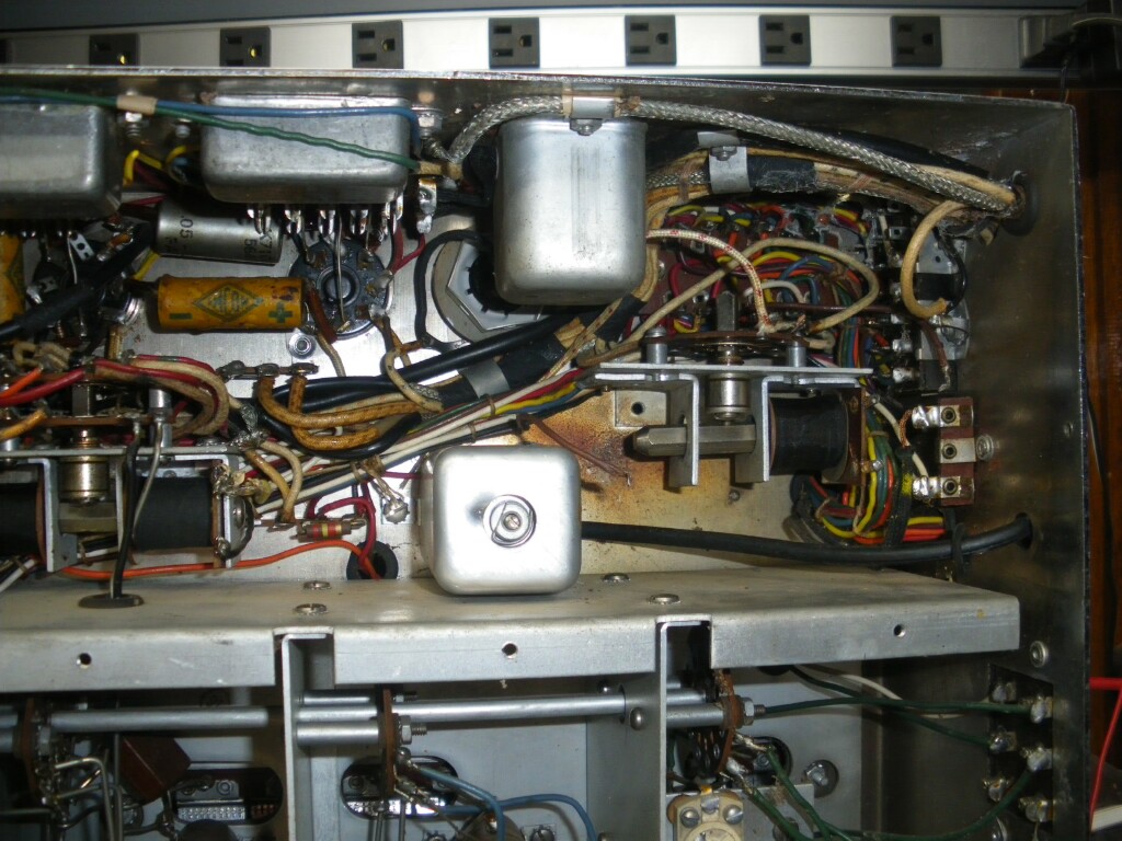

Finally pulling up the first 800B tuner. The biggest thing I see with this is the solenoid seen in the picture below. Aside from the missing coil, I can only see two wires to connect to four connections. There is also one of the plastic cased electrolytics that is broken, but I'm sure I can deal with that.

Brenda, looks like that coil did a little smoking. If that solenoid arrangement is for the power switch it would have been simple to just "set" sliding armature to the on and unplug the radio for off. No idea if all four coils are identical but would think so as both solenoids work in the same fashion. Energize one coil and it pulls the armature towards it, rotating the switching wafer to that position where it stays without power. Energize the other coil and it pulls the armature in the opposite directing, rotating the switch back. Really neat mechanism that takes the lateral move of the armature and results in a rotary turn of the switch wafer. Not looking at the schematic but it would seem to me that each coil would have only two terminals for energizing from the low voltage transformer. Can't image why the coil would have 4 connections.

What I mean by four connections is that each coil has two terminals, with two coils per solenoid. So, there should be four wires (or, at least three, with one of them going to both coils), but I only see two wires hanging free.

The broken e-cap is on the tuner chassis, you can see the bottom of it just up and a bit to the left of the solenoid.

More crap chrome plating from the "Stradivarius of Radio" those things must be flash chromed like cheap bicycle parts, no copper or nickel plates underneath. The other solenoid coil obvious went to that part's drawer in the sky. If you are lucky you may be able to find out the maker of the solenoid, like Allen Bradley, and be able to find another, or a least a donor for another coil and mount.

Today, I got to really play with this thing a bit. Not a sign of hum, power supply and amp work like a champ. I figured out that the destroyed solenoid was the power switch.
