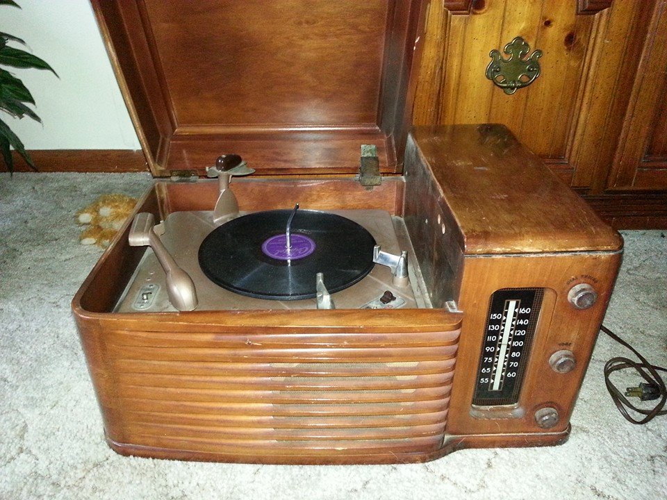

I bought a Philco Model 48-1256 at a local antique dealer. I did do the unthinkable and plug it in before re-capping it. This is my first one. Luckily I didn't release the smoke out of any components. It did have a loud ac hum so a recapping is in order for the electrolytics and papers. And I am pretty sure the crystal cartridge or wiring to it is bad. Just wanted to share and introduce myself. I do have 20 years experience in electronics just nothing this old. Always wanted to pick this up as a hobby though.

That radio combo unit is a curious design, I believe it uses a tube based, full wave, voltage doubler like a 50X6/50Y6. Since it's a transformerless set (not an AC/DC because of the doubler) about the worst that could have happened was a capacitor blowing up, or a resistor burning up.
Arran. You are correct it has a 50X6 rectifier tube.

Welcome to the forum. I believe the record player is a D-10. If so, I have an extra one sitting in my garage. It's not in very good shape, but if you need some parts, just ask.
