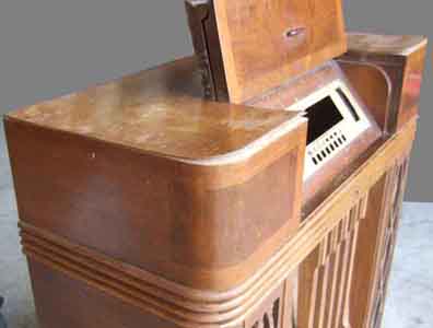

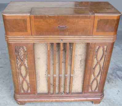

Yesterday I acquired a 40-201 model which has fairly decent exterior finish of the cabinet. There are a couple of spots of delamination of the veneer and one area of the base on the left side has some wood that has been gnawed off or has broken off - will have to check again.

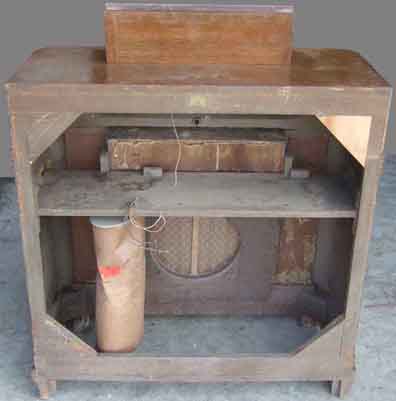

The biggest problem is that mice had gotten into the cabinet and created a nest and really left lots of excrement and pee all over the wood that the chassis mounts to. Right now I have the chassis removed. I used a metal spatula to scrape off the worst of the mouse mess. It was about 3/8" thick in places! I did some research on eliminating mouse odor and some of the most promising comments were:

What I would do is clean and prepare the wood for the finish using the shellac as an odor barrier. Let the cabinet air-out outside in the sun if possible. My concern is that any "treatment" that penetrates the wood far enough to remove all of the odor may damage the wood or impair the ability of the shellac to bond properly.

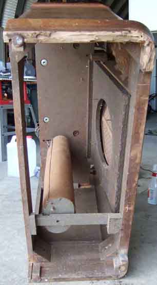

        [attachment=2991I finished doing a preliminary cleaning of the cabinet and chassis. I have some pictures I will try to post. The damage I saw on the left end of the base turned out to be due to termites! Fortunately it is confined to the lowest board glued to the base trim. It should be easy to replace.
Joe
It depends on your perspective of "easy" and woodworking. I have had to make several completely new bases because of termites. A good router is nice, scroll saw, table saw, and some other stuff.
It is often a great excuse to buy tools.
One can never have enough tools!Icon_clap It seems that every time I begin some project I eventually buy some new tool or tools. Sometimes I improvise and make a tool myself if I am not in a rush. I prefer not to be rushed at my age. The piece of wood that has the termite damage is on the very bottom and is glued to the part above it that is larger. There is already some separation between it and the wood above and likely it could be removed easily using a spatula carefully. That particular section is pretty much a straight tapered side with the thinnest edge at the very bottom. It could be made by using a belt sander after doing a first pass on a table saw set for a slight angle cut.

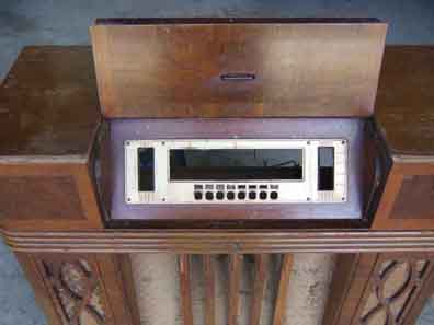

One question I have is what color was the original background behind the dial glass. Was it a dark brown? This one looks as though it may have faded considerably. It also appears to be flocked and is also somewhat dirty. I don't know whether to chance cleaning it with something or leave it alone. The back of the dial glass has really delicate painted lettering on it. I don't think I will be touching that even though it is dirty (at least for now). I wonder if anyone makes replacement dial glass complete with lettering? Or perhaps a decal?

Joe, I think this is the dial glass you asked about: http://www.radiodaze.com/product/13719.aspx (or perhaps this http://www.radiodaze.com/product/13718.aspx )
I've cleaned the dial glass on a 48-482 that has the lettering on one side and some markings on the other side by gently using water and a Q-tip followed by gently wiping with a paper towel.

Thanks for the links for the dial. I may order one, although it may not hurt to try cleaning the OEM one. Q-tips and alcohol or water may work to remove the film I see on the backside of the glass. Only one of the links shows a picture of the dial, the http://www.radiodaze.com/product/13719.aspx link item looks just like the one on this radio.

Can anyone comment about the flocked surface behind the dial glass? Or provide a picture of their restored 40-195, 40-200 or 40-201 radio dial? I think the one in this radio is faded considerably. It is also quite dirty with dust. I brushed off some of the dust using a soft camel hair brush, but it still is dirty and faded. It looks light brown in color and has some light spots on it.
