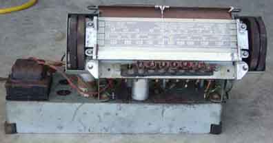

I am not sure if the radio originally had an on/off switch using the first push button or not. This radio had a toggle switch that was mounted in the cabinet just at the top of where the speaker baffle is mounted, but is in a vertical hole up through the wood of the horizontal bracing. The switch points downward and is hardly visible unless you really look for it. I found this when the chassis would not come out after all the chassis screws were removed and the two dial plate screws had been removed.
I will post some photographs.

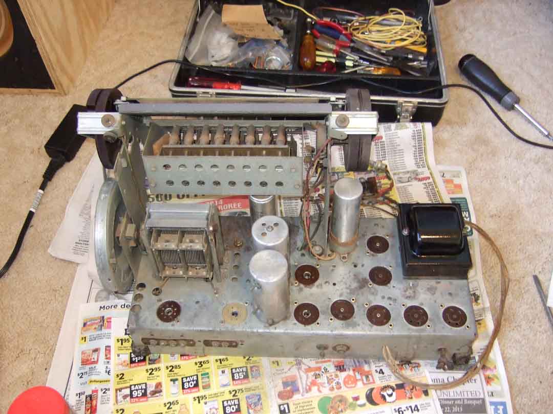

    Today I spent time cleaning the chassis top side. I used some citrus aroma waterless hand cleaner along with a fine bristle stainless steel wire brush. With the tubes removed I worked on a small section at a time. I took the power transformer top cover off and used the wire brush on it plus some sand paper where the rust was worst. It cleaned up nicely and then I followed it with a black gloss spray epoxy paint. The cover was then put in a toaster oven to speed up the drying process. I noticed that the transformer cover has the Philco name on it and the part number also appears on it. With the transformer cover off the top insulation over the internal windings also has the transformer part number imprinted on it.
The one area of the chassis that did not clean up very well was the area under the dial where the two electrolytic capacitors are mounted plus the area around the two IF transformers. I will order axial lead electrolytics to use in rebuilding the existing electrolytics. Each one is an individual electrolytic with no other sections in the case. That will make rebuilding the capacitors easier.
I also took time to clean the dial knobs by removing them. The hardest ones to remove are the tone and volume control knobs. It takes a little study to realize that the only way they will come off is to loosen the volume and tone controls from the chassis enough to allow enough play to get the knobs off after the outer shaft bracket is removed. Reassembly is somewhat tricky as the tone and volume controls both have to be adjusted so that both work smoothly. I also lubricated the control shafts.
The tuning capacitor assembly needed lubrication, so I did that while the knobs were off. I did not want to turn it until the lubrication was renewed.
Most of the rust is now gone and I will do some additional cleaning of the chassis top when I get the Electrolytic capacitors off for rebuilding. The mice had built a nest underneath the dial and control/push-button assembly and in front of the tuning capacitor. They chewed completely through the wires to/from the tuning capacitor and the push-button preset coils. I will be ordering some hook-up wire in multiple colors to take care of that. I will be looking for some wire with identical colors if at all possible. Solid color wire is fairly easy to find, but not the wire that has a base color plus a stripe. Some homework lies ahead on that.

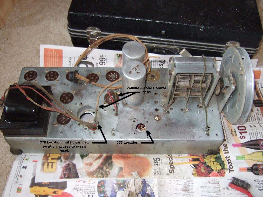

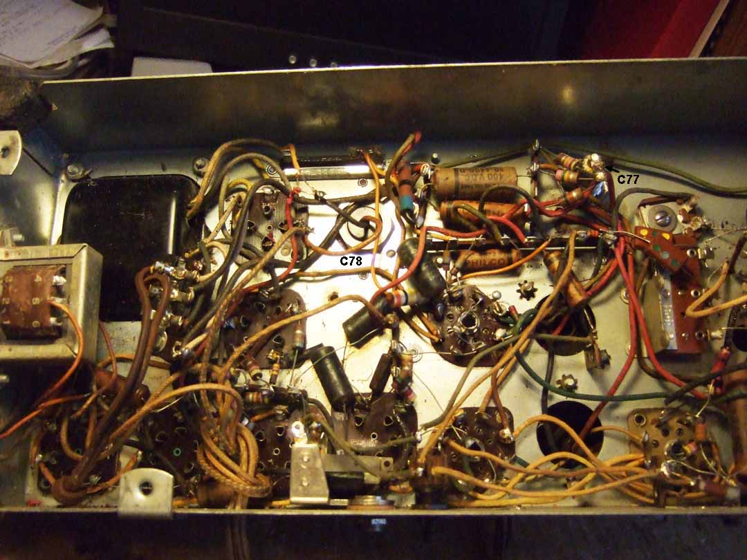

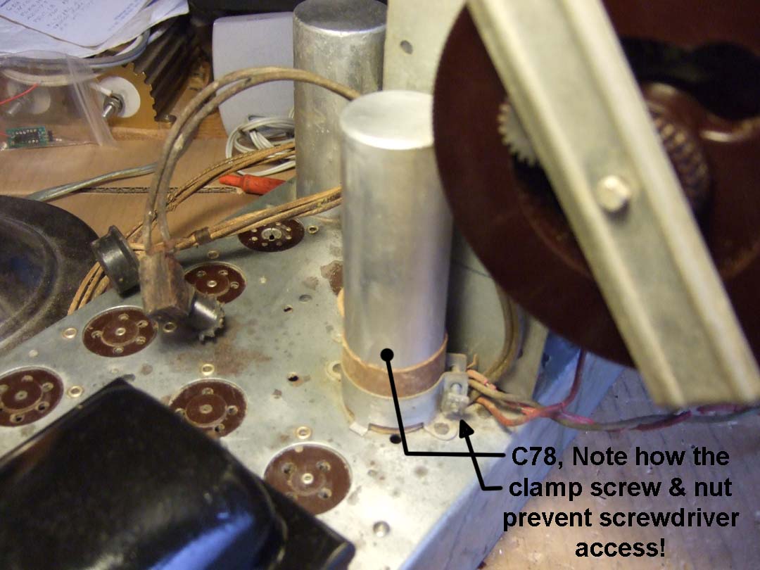

            Today I removed C78 and C77. C78 was a Cornell Dublier replacement from some time in the past. Whoever installed it put the screw head of the hardware on the mounting clamp against the left side of the bracket that supports the control and push-button assembly. Because of that I found it very difficult to remove C78. I finally clipped the leads going to the volume and tone control and removed the control assembly. Mice had already chewed the wires going to the push-button coils. The bottom end of C78 had a cardboard sleeve between the can surface and the inside of the holding bracket.
I cut C78 and C77 open using a tubing cutter after removal from the chassis. C77 was the original Philco wet type capacitor. C78 had a large nut and washer on its bottom and the plastic threaded stud broke off as I was unscrewing the nut. I will have to use some epoxy to glue it back together. The internal parts of C78 were embedded in a hard wax or tar material. I had to use a hair drier to soften it enough to get the capacitor element out. I used a 3 inch long deck screw to pull it out.
C77 was completely dried out when I opened it up. I did find that a 1 inch PVC tube fit snugly inside this electrolytic's can, so that will be used to provide strength when the capacitor shell is put back together with a new axial lead electrolytic inside. The + and - leads will be brought out through the hole left in the bottom part of the old capacitor shell when it is remounted in the chassis.
I cleaned off the chassis where the two electrolytics and the control bracket had been. New rubber grommets will be needed for the control assembly mounting to the chassis when it goes back together.

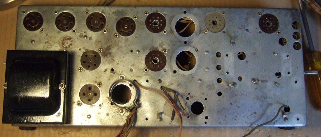

Here is a picture of the chassis after C79 and C77 were removed and the chassis was cleaned with a wire brush and some waterless hand cleaner with pumice in it.

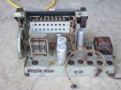

Today I took the remaining IF transformer off the chassis. I took the internal parts out and put new wires of the right color code on using stranded 22AWG wire of 600V insulation. I need to attach similar wire to the other IF transformer that I repaired. Unfortunately I did not have the wire when I reassembled it. So, I will have to attach new leads near the bottom somewhat inside the shield and use some heat shrink tubing to keep them insulated.
After I got the last IF transformer off I took more pictures and removed the tuning capacitor. I also removed the one trimmer cap that has its stud above the chassis. There was considerable corrosion in the chassis metal at that spot due to the mouse pee. With all these parts off, I scrubbed the rest of that end of the chassis once more with waterless hand cleaner with pumice in it using the find stainless steel wire brush. It cleaned up pretty well.
There is some remaining corrosion where the mounting clamp for C78 was located. I may go ahead and drill out the rivets that hold the clamp on and clean the chassis there too. If that is out of the way, the only other thing still left in place would be the power transformer. I may go ahead and remove it too. That way I can completely clean the top of the chassis in preparation for spray paint.

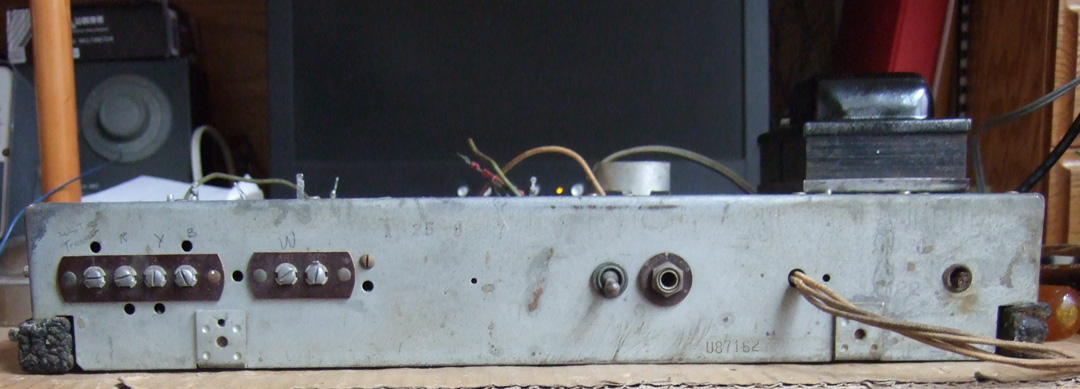

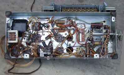

This radio chassis has an ink stamped ID on it saying:
Model 40-201 (the 1 is almost eroded away)
Code 122
And there is stamped into the chassis metal U87162, which I assume is the serial number of the radio.
In the photographs you can see the area where the tuning capacitor was mounted. That area is cleanest.
This chassis has a jack on the back to plug in a phonograph plus a toggle switch next to it. This appears to be a factory option, not an add-on done later. The bakelite plastic around the jack actually says Phonograph Pickup and is a 1/4" phone jack type that interrupts one set of contacts and makes another. Since that is the case, I wonder why the switch. I need to trace this out and see what they really did to the circuitry.
It was not a factory option, it was done later. Some techs were neater than others when it came to adding those jacks to chassis.
