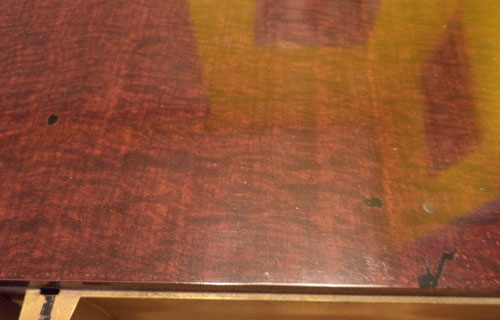

It is an RCA 75X14. It has a plastic cabinet. It has what I would call a faux finish. It is painted to look like marbled Bakelite. My problem is that it has 4 or 5 small chips in the paint and a small hairline crack in the rear at the bottom. I'm not too concerned with the crack.
My question is: What would you guys do? I can't simply touch up the chipped paint because it would just be a solid color touch up. So, do I leave them alone and just polish the cabinet or do I strip the paint off and repaint with a solid brown, the color of Bakelite? I have no idea how I could replicate the original finish.
Please take a look. What do you think?

If it were me, I would get as close to a solid color match as possible and dab them in.

I haven't any experience with refinishing, but I wonder if one of the analine dye wood stains might not be useful here. Something more transparent than paint, that would nonetheless cover the chips.

Eric, I'm with Murph. I would look at a hobby store for a selection of acrylic paints and try to mix something up to match your base color. Use a small artists brush and dab the color into the chip area. After drying perhaps a little contrast color on an almost dry brush to just give a closer look to the original finish which was more of a swirl two tone.

Thanks guys, I'll give it a try.
