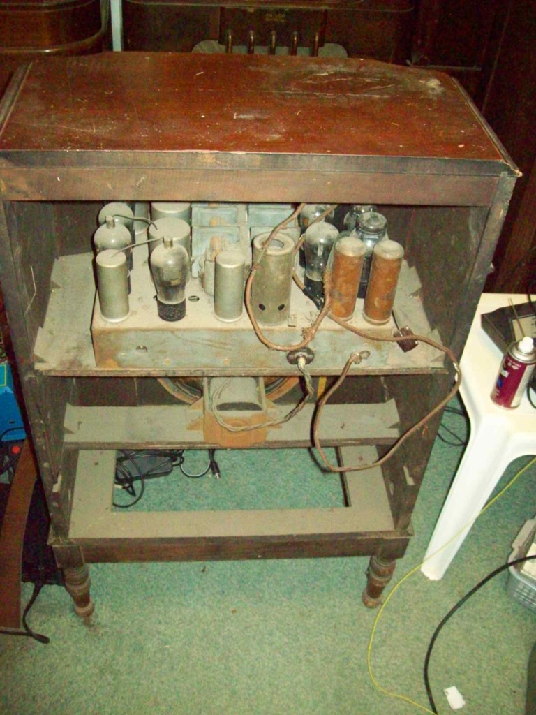

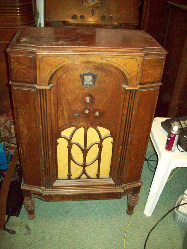

As promised, pictures! Yet another Philco saved from a dark, dank back room!

A single ended type 47 is probably comparable to a 42/6F6 in terms of power output. I repaired a Canadian G.E J-82 some years ago and it had more then enough power output to fill the room, maybe 3 watts worth. The J-82 is roughly equivalent to a Philco 70 performance wise, maybe somewhat better since it has AVC, with a much better sounding speaker though. The 90 lowboy will probably sound better with that 10'' H series speaker then a cathedral with that stiff "Pie Pan" speaker they usually come with.

I have a 90 lowboy and it is a very good performer. Great sensitivity and selectivity.
The AVC action is excellent due to the use of the sharp cutoff 24A tubes in the RF and IF stages. Almost every station comes in at the same volume whether strong or weak, but the sharp cutoff tubes do sometimes cause cross modulation with very strong signals.
The only drawback of the 47 output when compared to a 42 or 6F6 is the low level speaker hum caused by the directly heated AC filament.
