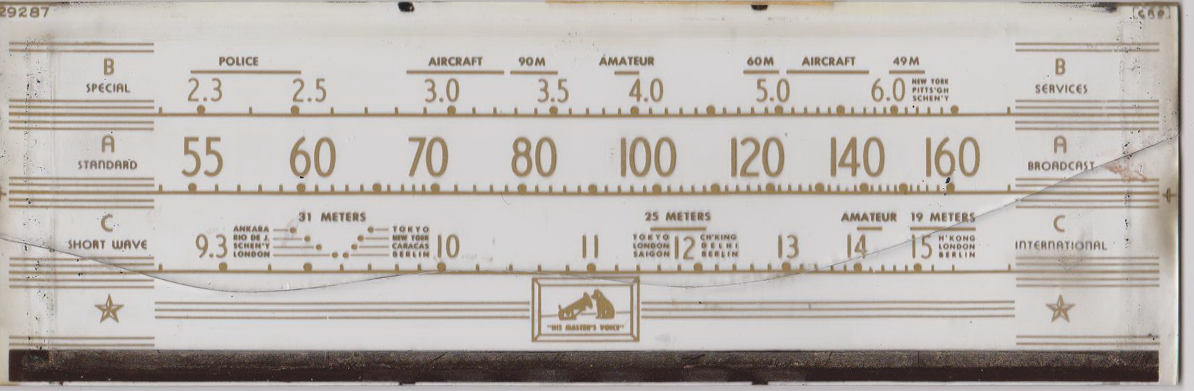

Have a nice RCA 29k2 console radio I brought home today, only to discover after the ride home, that the slide rule dial glass had cracked.
Anyone have one or know of anyone who makes a replica?

If nobody else can help, and your dial isn't too badly shattered, you can put the pieces back together and take a high res scan (a high res photo will work, too, but harder to work with). Then email me the scan and exact measurements. I can reproduce the dial scale itself on a color transparency and mail that to you. You could then get your own piece of glass cut (or plexy!) and attach the repro scale to it.

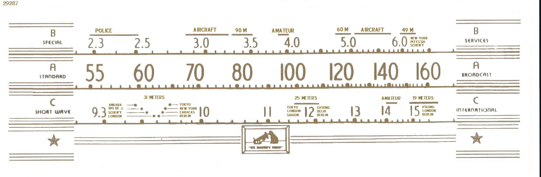

Brenda was nice enough to make me a transparency.
We'll try that and see how it looks.
Thanks again Brenda.

In case anyone would like to see what I do with these beasties:
Before:
After:
Lots of work with Photoshop Elements, then printed out on a transparency. This is the first time I've had to do it without having the original dial to work with (other than a scan). I usually have the original to compare the transparency to make sure the final dimensions are correct.

Darn.. after all the work, and printing out the transparencies, I've just checked against the original with one of the transparencies, and the transparency is smaller/narrower. I'm going to have to get some legal size (8.5x14) transparencies and reprint them and remail. Sorry about this, Murf.. printer limitations.  Shouldn't be too long, though. I could also send you the finished file and you could perhaps have Kinko's print a transparency for you in the meantime.
