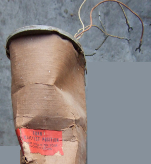

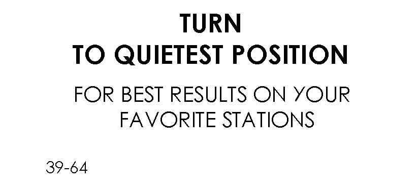

I have started a label for the part number 38-9881 rotating antenna assembly that is used on the 40-195, 40-200 and 40-201 model. It may apply to others also. What I need to know is the part no. printed on the label. On my radio, this label is cracked and damaged as is the outer cardboard covering of the assembly.
I will have to find some cardboard similar to that which was used when the radio was made if at all possible.
Can someone look at their Red with Black printing label and get the part number for the label for me. I can see this part of the number: 39-64 with the last two digits not visible.
I bought some acid free red copy paper to use in reproducing the label for the radio. It was Ampad 19611 8.5" X 11" 25 sheets available at Walmart.

The red-orange label part number is 39-6431.
I wouldn't advocate the water method; the wire mesh inside the paper sandwich should have enough rigidity that you'll damage the paper and the wire won't bend. I removed the major dents from mine by gently unstapling it from the wood frame and inching it down over the wooden ovals at the end. I also suggest taking a ruler or some similarly-sized object at this point and gently pushing the dents out from within.
The wire mesh is about as rigid as a desk staple, or perhaps a little moreso. A gentle nudge of force is required to reshape it; water won't help in the slightest.
Go gently... your paper is already brittle! Good luck!

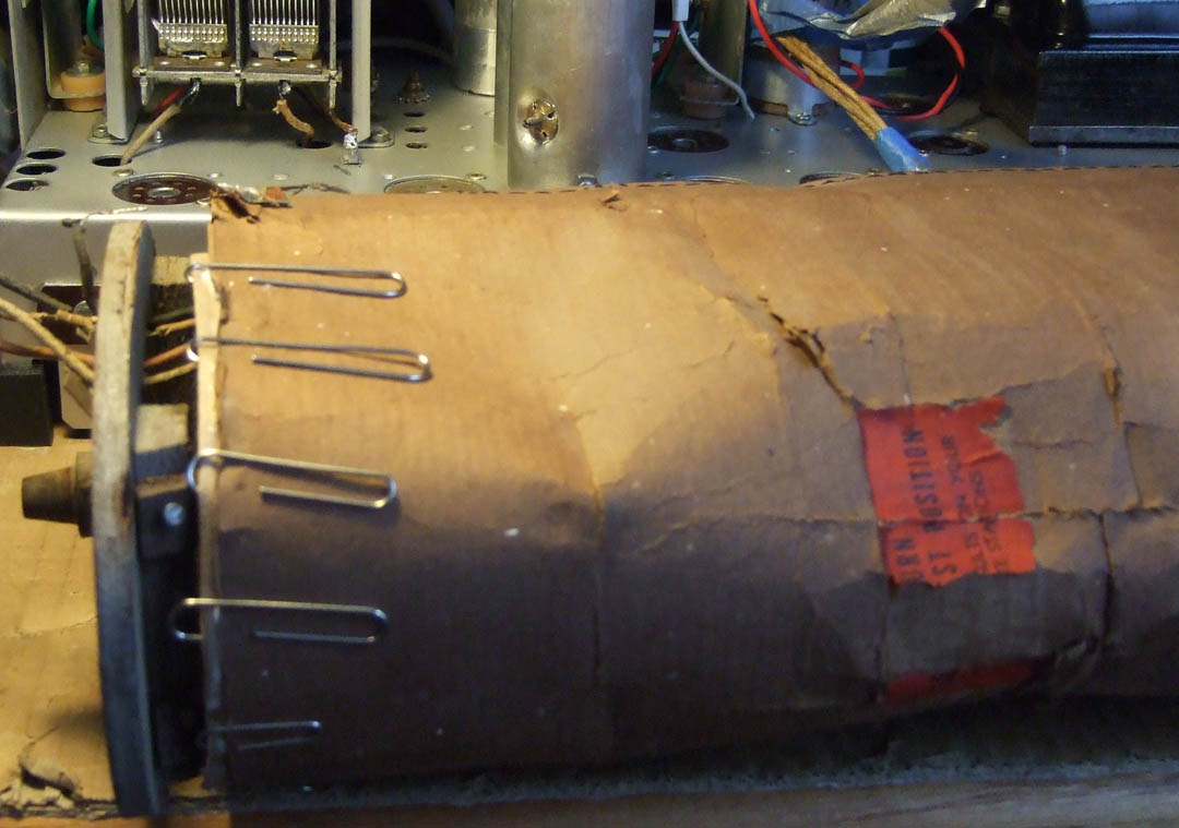

After a closer look at the unit I found that there is a tear completely through a number of the wire strands embedded in the outer tube. It appears that there are individual wires that circle around the outer cover and are soldered to a long tinned copper foil strip that runs vertically close to the stitched seam in the outer cover. This tinned copper strip is in turn soldered to the black wire at the top. As I straightened the shape of the bent portions of the antenna assembly, the paper cracked every time I flexed it. It appears that the best way to repair this, after I get as much straightening as I can done, will be to reinforce the outer and inner walls using some brown paper similar to that used in brown paper grocery sacks. The fine wires in this outer paper shell are copper and look to be something on the order of n. 28AWG, which is pretty delicate to work with.

The top and bottom edges of this paper covering (it is not cardboard after all) were very brittle and crumbling with age. I found some paper grocery sacks and have cut a piece about 6 inches square, folded it in half and applied Elmer's white glue between the halves. Then I spread the same type glue on one surface and worked it underneath the top edge of the oval cylinder. As the glue was beginning to set, I kept pressing the outside of the cover against the glue surfaced paper sack reinforcement using some wooden rulers and some popsicle sticks. I will add additional patches like this all the way around the top of this outer paper cover. When I get the top end suitably reinforced, then I will do the same to the bottom of the paper cover until there is some strength to the outer paper cover at both ends. The gaping hole about 5-6 inches down from the top on one side is the biggest problem. I will try to fish the broken copper wire leads out enough to solder some connecting strands across the gap an attach to the mating end on the other side. It is going to be a delicate procedure. I will have to find some way to reinforce the inside and outside once I get the wires repaired. I may get lucky enough to slide the whole outer cover off of the wooden form to get at the inside. That would really be best as I could do a good job of reinforcing the inside to offset the external cracks on the outside. Perhaps some coffee filter paper can be used to reinforce the outer paper skin after I can get the inner surface reinforced and strengthened.
What a mess someone made of this poor antenna assembly!

Here is a picture of the technique I am using to repair the paper covering of the antenna assembly. The paper is so brittle I am reinforcing it from the inside first at the ends. I am using grocery paper sack paper folded with Elmer's glue inside, then coating one outer surface, positioning it using tweezers and my fingers and securing it with paper clips. Once I get both ends reinforced I will be able to get to the center areas of the antenna assembly outer cover and make repairs there. The whole outer paper covering is quite delicate and will not stand much handling without disintegration. Since this may have been a one year feature, I want to preserve its function as much as possible.

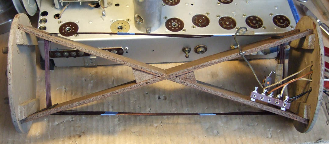

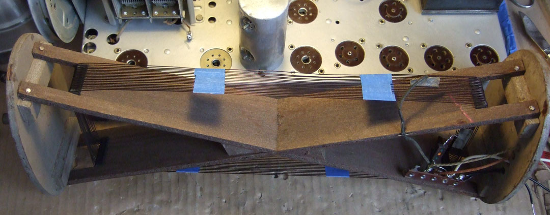

For posterity, I made measurements of the rotatable loop. The dimensions given are just to the corners of the rectangle formed by the internal wooden "X" at the point where the wires bend over the edge: 13.75 inches high by 4.5 inches wide. The distance the wires are evenly spaced across is about 1.25 inches. There is about 1/16 to 3/32 of space between winding loops. Philco used some white tape about 1/3 the distance from the corners along the 13.75 inch height to keep the wires spaced properly so that there are two bands of tape on either side of the loop (total of 4 bands of tape). The total windings are 17. The first loop beginning with the black wire is 3 turns, the second portion is an additional 7.9 loops with the final portion 6.1 turns. The wire connected to the first loop tap is the white - yellow (or in this case just white), the second portion tap is the white - red (or in this case just red) and the remaining tap at the end is the white - green wire. On this radio the black wire and the white wire were the rubber insulated types. The red wire and the white - green wires were cloth covered types. The white wire connects to the junction of the 250pfd cap and the 10k ohm resistor and is brought out to the terminal at the back of the chassis. The white - green wire connects to terminal 1 of the 4-terminal strip. the white - red or red wire connects to terminal 2 of the 4-terminal strip. The white wire from the junction of the 10k ohm resistor and 250pfd cap connects to the 2nd. terminal (right side terminal) of the 2-terminal strip to the right of the 4-terminal strip location. The wire used for the loop is 21AWG magnet wire, measuring about 0.029 inches in OD. Each section of the loop measures in fractions of an ohm.
There is one loop shown close to the dashed lines of the rotatable antenna and this loop is in the top of the cabinet with a cloth covered wire brought down to connect at the 3rd. terminal next to the 4th. terminal where the black wire connects to the terminal strip with 4 terminals. This is the loop shown on the schematic with a resistance of less than 0.1 ohms. I have not looked to see how many turns, how spaced or what wire size was used yet. That item is still in the cabinet and it is in the barn. It is still freezing outside and it will have to wait until the weather is warmer.
