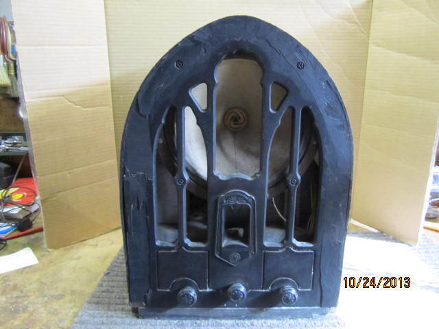

I just got this interesting GE radio model J-100. This thing is built like a veritable battleship.
The most interesting thing is the rectifier. It's an 82, mercury vapor rectifier. It has the most beautiful blue glow inside the plates. The only other thing I've seen with mercury vapor rectifiers in it was an old Raytheon AM transmitter. Needless to say, I didn't get to look at that rectfier in action. I'm curious as to whether this SHOULD have this beautiful blue glow. Once I put in new power filters the radio plays well and sounds great. Not a hint of hum.
This set also has the most interesting volume control I've ever seen. It's actually a part of the AGC circuit as opposed to being either in the antenna or audio circuits.

I'm gonna love this radio when it's finished. The audio sounds great even with the speaker just sitting there on my bench. It's sure a PITA to work on, though. All the caps are in one big can, and that can is attached to the chassis with some heavy tabs that I can't seem to bend away from the chassis. I've replaced the filters by cutting the wires coming out of that box for now.

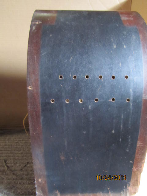

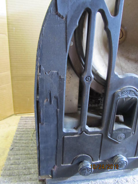

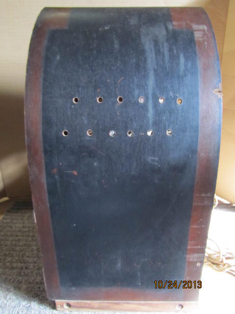

The cabinet work may be a bit much for me.. it needs pretty much all the veneer replaced, especially on the front, where someone has just painted it all flat black and there's a lot missing. The bell has holes drilled in it on both sides, but that will be fairly simple in comparison, as I can just take a single piece of new veneer and apply it to the whole thing.

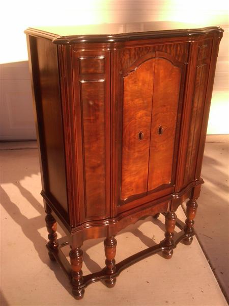

This R-78 BI-Acoustic also uses the 82. It is capable of producing incredible levels of audio. I can't imagine anyone ever running it that loud. It is a 12 tube unit.
Be careful. Many of the GEs and RCAs of the time started to use photofinish. It looks good, way better than what Philco used, but it is all still fake.

Don't know where I would find another cabinet. I've never seen another of these radios. They're rare enough that service literature for the exact model is not available, only schematics for the RCA version. I figure even at my skill level (2 of 10) I can do right by this cabinet. Since the side moldings are missing completely, it will give me a chance to use my router table for something besides more shelf space.

The good news is that I don't think it had much, if any, faux finish to begin with, I think that there may have been some in the form of a birdseye maple on the front. If you want to have a go at replicating moldings take your time, they probably used poplar or maple to make them out of, if a piece looks wrong, chuck it and make another. I would say that when it comes to cabinetry about 10-20% is measurement and planning, the rest is from experience gained through lots of practice. It would be helpful if you could find someone who has a good cabinet to copy from.
One thing that you may have to do is custom grind a router bit or two to get the right profile, or do a lot of hunting, the typical router bits they sell at a hardware store seldom match.
That set is the big brother to my K-83, except it is not as common, but at least the hard to find bits like the escutcheon and the knobs are there. There is also no shame in farming out some if not all of the work to someone like Steve Davis, unless there is a Korean version of Steve in your area.
