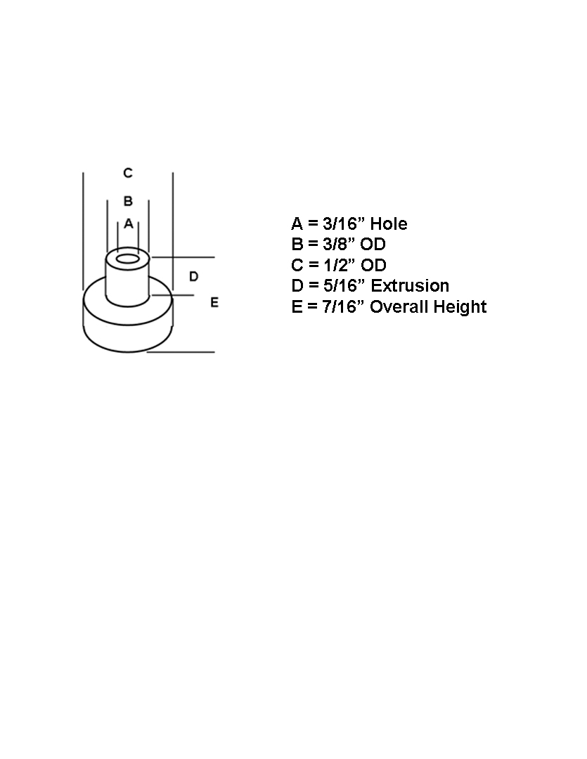

I heard from Ed Schultz with Renovatedradios.com today and here are his comments about the grommets for mounting the tuning capacitor in my 40-201:
Just now measured my GPH-RFTR part and it looks like it would not be a replacement for what you need. Do you have an original that you are taking measurements from?
I replied to him saying that yes, that was how I determined the dimensions of the original grommets +/- some allowance for measurement errors. I will have to wait to see if he may have any plans to make any.
Here were the measurements I took:
See if grommets on any of your radios match what I show here
Joe
