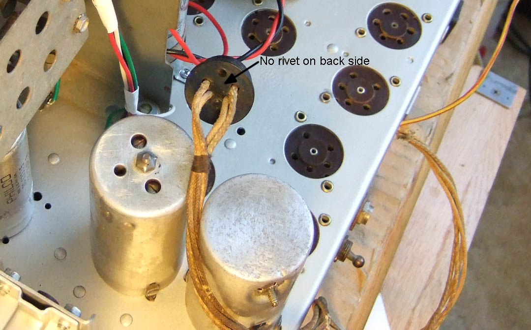

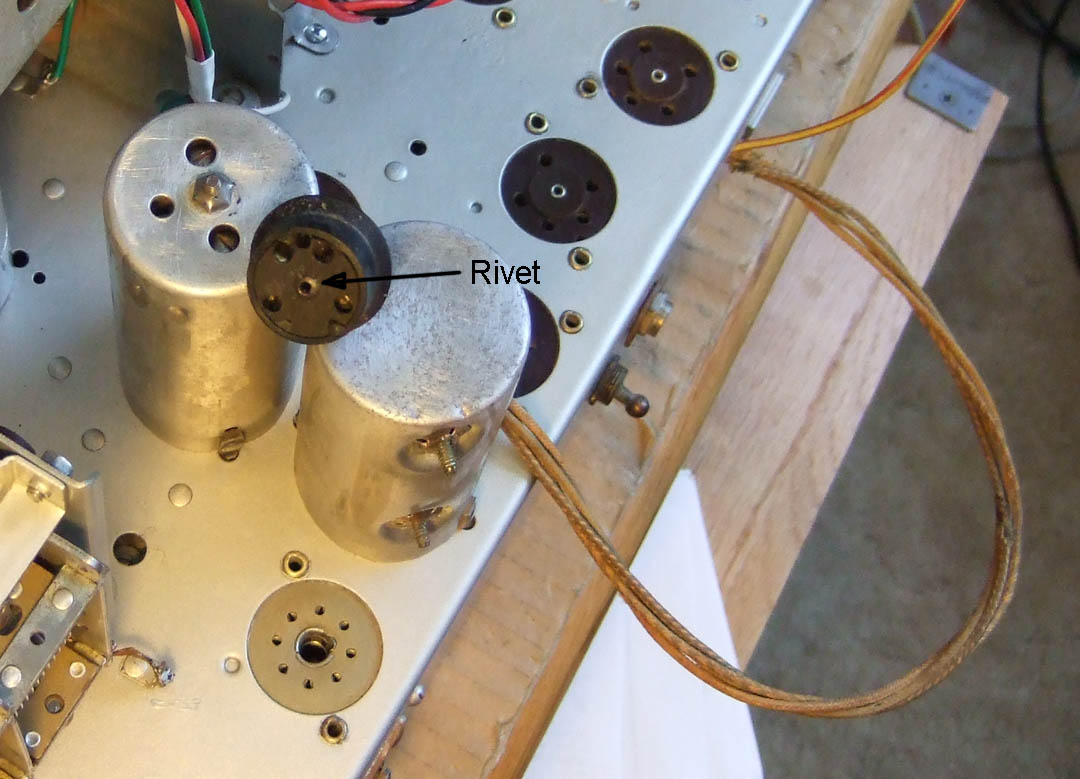

I want to replace the wires going to the speaker socket of my 40-201. Here are a couple of pictures of the socket front and back side. On the front (the side that plugs onto the speaker mounted plug) there is a brass rivet. On the back where the wires enter, there is no rivet at all.
Is it possible to file or drill the rivet head off and remove the fish-paper cover, then solder new wires to the internal contacts, and put the fish-paper cover back on? In other words, can the rivet be removed and a small hole drilled to accept say no. 4-40 hardware to reassemble the socket?

Certainly quite a few alternatives. Any riveit can be carefully and slowly drilled out and replaced afterwoods with a screw and some reinforcement ala bondo or whatever after everything checks out and should be good for another 50 years of so. can't tell exactly, but if the socket is identical to a 5 pin tube, you could harvest a dud carefully and use the base, and even save the old wiring in a little bag for future purists, (I wouldn't but some might bother.) Certainly octal plug/socket sets are pretty easy to come by too, just so long as everything sets up properly, but do keep notes on just what you changed and tuck them into a little piece of plastic wrap stapled or glued to the inside cabinet if you care to.
If you drill out the rivet DO NOT try to use another rivet as a rivet with a riveting tool - you will crush the case.
If you still want a rivet in there, take a proper size copper or brass rivet, take out the mandrel, and use any large drill with obtuse conical end and a hammer to flare it to hold the case together. Do it gently.

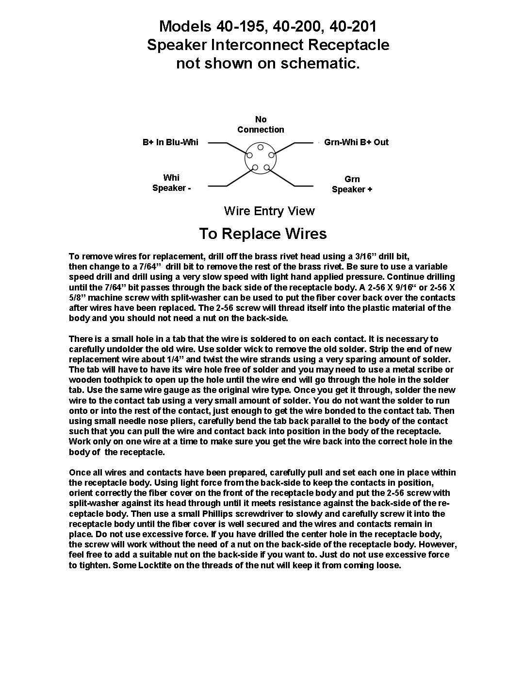

Today I managed to locate some 2-56 machine screw hardware and proceeded to drill out the rivet in the speaker receptacle to replace the old fraying wires. I had enough stranded wire on hand to get most of it done except for the speaker minus lead, for which I choose to use a black wire. My Jameco hook-up wire order has not arrived just yet. Once I have it I can complete this part of the chassis rewiring.
Here is a drawing I made in Photoshop to show the details related to the speaker receptacle. It is not shown on the schematic for the 40-195/200/201 so this may be helpful to others in understanding how the wires connect to/from the field core and the voice coil.
Joe
The above illustration is the wire entry view (back side) of the connector.

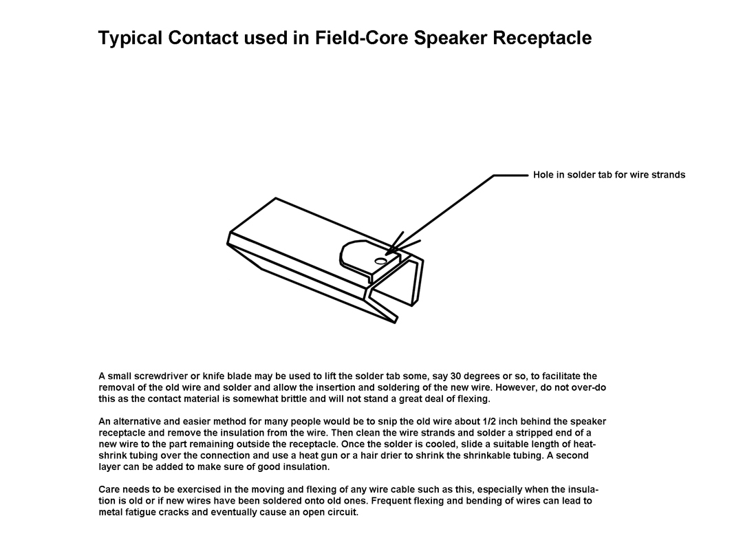

I decided to add an illustration of a typical speaker receptacle contact so it would be easier to understand how the wires are attached to it. Hope this helps others.

An interesting aspect of the speaker receptacle is that looking at the illustration, which is of the wire entry view, the B+ leads are spaced widely apart while the voice coil leads are close together. However, when you look at the mating face, the B+ leads are spaced close together while the voice coil leads are spaced widely apart. It has to do with the way the wire/contact parts are oriented as they are inserted into the body of the receptacle.
