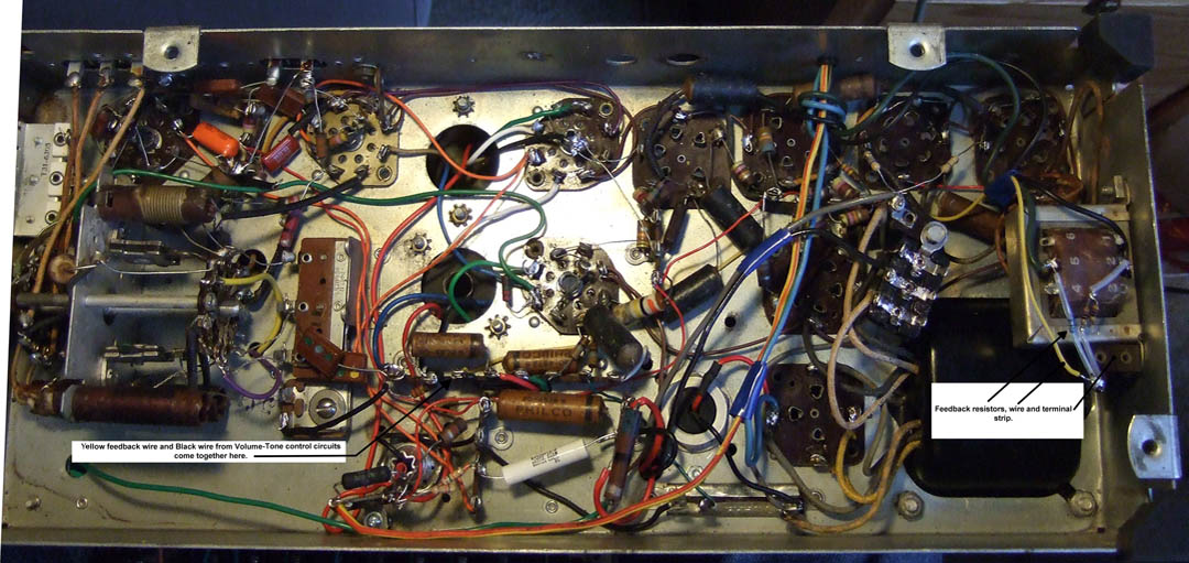

I decided to add the negative feedback circuit similar to what Philco used in their late 1940 sets. That approach involves adding a 4.7ohm resistor and a 68 ohm resistor in series across the secondary of the audio output transformer. I did not have a 4.7 ohm resistor, but I did have over 100 10 ohm resistors, so I paralleled two of them to make a 5 ohm resistor. I soldered a 68 ohm resistor in series with the 5 ohm resistor across the secondary of the output transformer. I added a terminal strip alongside the transformer to hold these two resistors at their junction. Then I added a yellow wire back to the terminal strip where the black wire from the volume-tone control circuits came from the top of the chassis to a terminal strip underneath. At the same time, I removed the wire that was added that grounded that point. Now the negative feedback will be restored and keep distortion to a minimum as the designers intended.
Joe

Joe, have you checked the phasing of your negative feedback connection?
In another posting you mentioned oscillations at certain volume control settings. With that replacement output transformer, you have a 50% chance of applying positive feedback as there are no phase markings on the transformer leads.
You can try exchanging the two primary plate leads and see how it affects the oscillation and the operation of the bass and volume controls. If you have a dual trace scope, checking the phase of the feedback signal compared to the volume control input signal should be easy enough.

Mondial;
Thanks for that input. I do have a dual trace oscilloscope and two probes, so checking the phase should be easy to do. Also if I ground the feedback and it eliminates the oscillation, then I could conclude the feedback is the wrong phase and reverse the connections at the transformer secondary and try again. It goes to show that using OEM parts simplifies repairs in many ways. The photo above shows many paper capacitors still there. Most have now been replaced except for a few that I need to order.

Mondial;
You were exactly right, the phasing was positive instead of negative. Once I reversed the speaker connections and the feedback connections at the transformer secondary the oscillation went away. Just reversing the speaker leads eliminated the mid-frequency feedback oscillation but then I had low frequency motor-boating oscillation that varied with the tone control. Then reversing the connections of the end points of the resistive feedback network eliminated the motor-boating. The key was that just grounding the feedback lead to the volume/tone control stopped all oscillations. Now the radio is silent when it should be and I can go on with troubleshooting and alignment!
